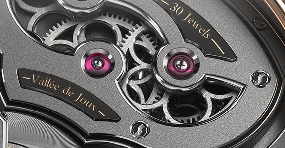

Romain Gauthier’s dazzling Logical One tour de force of a watch, starts from a sound point of logic. Romain recognised that the principles of constant force should apply to watches just as they apply to cars, planes and other machines.
After all, the vast majority of machines run on constant force: Cars and planes don’t start running slower as fuel runs low and machines receive the same voltage no matter how much electricity is produced.
Constant force is one of the holy grails of horology and with Logical One, Romain Gauthier has reinvented the chain-and-fusee − one of the oldest and most traditional methods of supplying constant force to a watch/clock movement − making it more reliable, more effective - and more constant.
Accordingly, Logical One features a triple patent-pending Romain Gauthier flat chain-and-fusee style constant force system with ruby chain links, ergonomic push button winding system, dial-side visible balance, a mainspring barrel with sapphire inserts, plus a 60-hour power reserve indicator.
Traditional chain and fusee
Fusees have been used since 15th century to improve timekeeping by compensating for the diminishing torque/power of the mainspring as it ran down.
The first fusees used fine cord; however, as technology enabled the manufacture of ever-smaller chains, these replaced cords because chains transmit power more efficiently. But the traditional chain and fusee has two inherent problems:
1. The multiple layers of chain (often eight turns) on the fusee mean that the individual links have to be small, which means that they are relatively weak.
2. The chain is often transmitting force between the fusee and mainspring barrel at an angle, which is both inefficient and adds stress.
Replacing the fusee with a snail cam
 Romain solved both problems by replacing the fusee with a slowly rotating snail cam, which is situated at 10 o’clock to the left of the hour/minutes dial.
As the snail cam and mainspring barrel are on the same level, the force is always transmitted in a straight line and, as only one short line of chain is needed, the links can be bigger and stronger.
Ruby chain (patent pending)
To further improve efficiency, Romain has taken full advantage of the larger chain links by making the links in low-friction hard-wearing synthetic rubies.
And there is yet another innovation in the construction of the chain itself.
Romain Gauthier has replaced the traditional method of joining chain links, by placing a fine sheet of paper between the links and connecting plates, riveting them together and burning the paper away to create a fine (though imprecise) tolerance, with a snap clip system that offers high-precision, simplicity, reliability and consistency.
Winding with ergonomic pusher
Romain Gauthier’s Logical One features an innovative push button winding system, with the pusher set neatly into the left caseband. Based on sound engineering principles, a traditional crown is relative small with a fine (relatively fragile) stem that has to transmit the force 90° between the crown  to the  mainspring barrel. The pusher to wind Logical One transmits force to the barrel on the same plane.
Mainspring barrel with sapphire lining
In a traditional brass barrel, the metal of the spring scratches the metal, even when freshly greased. Over time, grease clots, scratches get rougher, the barrel sticks to the spring and does not rotate smoothly. To eliminate this potential source of uneven friction, Romain has placed the mainspring of Logical One between synthetic sapphire plates.  Sapphire has the ideal properties of having a low coefficient of friction with steel – which is why watch movements have ruby bearings – and is highly scratch resistant.
Movement & finishing
The movement for Logical One was conceived, developed, designed, produced, decorated, assembled and regulated entirely in-house by Manufacture Romain Gauthier.
Highly polished sharp internal bevelled angles in the movement plates and bridges are the hallmark of superlative hand finishing because, to date, machines are not capable of milling and polishing sharp internal bevels.
With Logical One, Romain Gauthier has gone a step further still in creating double-angle bevels with sharp internal angles, which give the effect of border.
A world of logical details
•    Bespoke gear wheels with graceful circular arms for maximum rigidity
•    Special power-process hand frosted bridges
•    High efficiency gear teeth profile (patent pending)
•    Polished screw heads with distinctive S-slot for more length/less slip
•    Balance wheel with curved arms and calibrated eccentric weights
•    Triangular pallet lever (Romain Gauthier invention) for improved rigidity.
Specifications
Features: hours, minutes, small seconds, 3-day power reserve, push-button winding and innovative chain-and-fusee style constant force system
Case and strap
Case materials: red gold or platinum
Movement plates and bridges: titanium, stainless steel, brasst
Dimensions: 43mm x 14.2mm
Water resistance: 50m /5 atm / 150’
Sapphire crystal with anti-reflection coat front and display back
Winding by push button at 9 o’clock
Time-setting crown with sapphire cabochon at 2 o’clock
Strap and buckle: alligator leather hand-stitched in Switzerland with pin buckle in metal to match the case.
Movement
In-house manufacture movement calibre
Dimensions: 35.5mm x 10.5mm
Power reserve: 60-hours
Number of jewels: 30 in movement, 34 for chain
Number of components: 333
Balance frequency: 28,800 bph / 4Hz
Highest level haute horlogerie finishing, including hand polished screws and jewel countersinks; hand bevelled and polished bridges and plates.
Three patents pending
