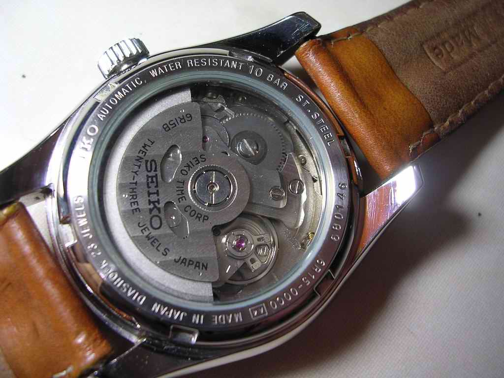

This is your standard 6R15 (this is actually the earlier version, the newer one is much nicer but my link to the photo broke). This is Seiko's all around entry level movement, featured in a number of affordable watches. Notice the shock on the cap jewel.

So that constitutes a lot of examples of Seiko's "low end" or entry level movements. There are a ton of variations on those (there are three different 6R15s alone), but that should give you an idea.
