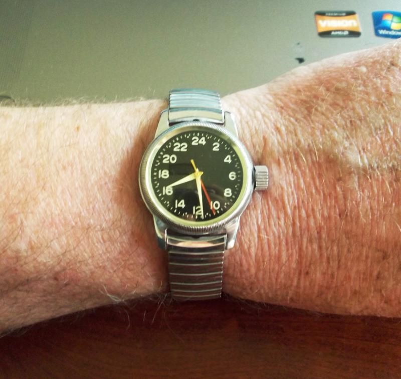

I found this old WUS thread while trying to do research on something I found online--reactivating it (I hope) to ask: has anyone ever seen a legit Elgin A-11 that looks like the one shown here? I can't recall ever seeing this kind of 24-hour dial on an A-11 and am wondering: re-cased fake or franken or what?
15408535
Oh, and of course the seller posted no photo of the movement, though the case-back engraving seems genuine.
Dunno about it being genuine. I do know that it's not a 24-hour dial or movement.
Maybe ask over in the PilMil forum?
Reactions: 1
Right, it's definitely a standard 12-hour, just with additional "military time" dial markings, but this thread was the closest I could find to describing the watch I'm trying to research. Thanks for the other forum suggestion. The seller says he can't open the case back so Imma prolly pass but it's interesting to say the least.
