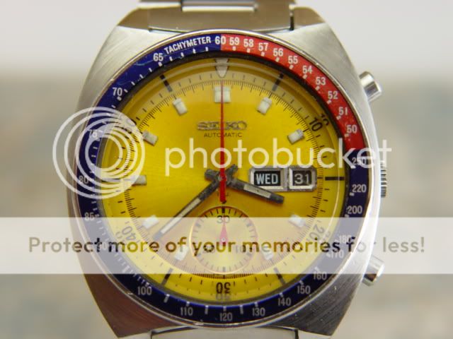

I'll start with this aftermarket dial: This fits a 6139-600X.
Two areas to check closely: The sub register indics don't come to the edge of the sub register ring and the lume on the dial indics is shiny and has a pronounced rounded edge. This edge is easy to spot on the 9 o'clock marker due to the reflection.
Now an Original dial:
Notice the sub register indics come to the edge of the sub dial register ring. The edge of the lume is harder to see but it is not shiny and has a sharper edge.
Here's another example of an aftermarket dial for a 6139-601X
This one's easy to spot. It has no frame around the day-date window and the color is a little off. One thing to consider is that some other 6139's don't have a frame around the date window but all 6139-601X's do.
This is an original dial:
Note the frame around the Day-Date window and the deeper blue color.
Hopefully this will help some of you spot the differences between aftermarket and original when it's a concern.

Great idea for a thread. I recently got bitten by the Pogue bug. With the pics side by side, it's easy to tell. Without reference, the obvious giveaway is the lack of Suwa logo, and the fine prints will always look ugly.
