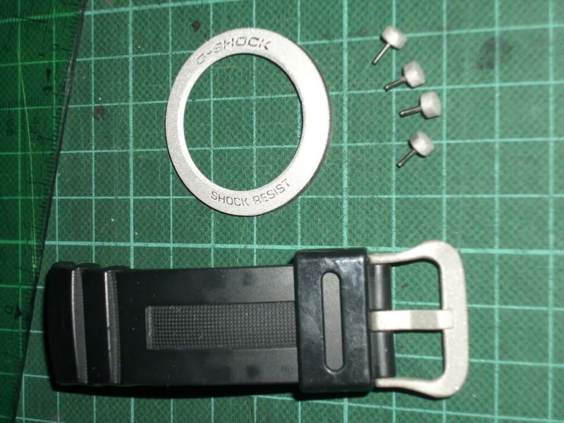

I had to sand the Bezel ring anyways as it was scratched. This destroyed the surface, so i decided to media blast and paint it.
In the end I did like the metal-look of the outcome and it´s non-reflectiveness so much that i decided to leave the bezel ring as is and do the whole hardware that way.
Tried to capture the surface on the pushers:
The other watch will get a black bezel ring and buckle.

I removed the lettering in the less destroyed bezel and put the AWG back together.

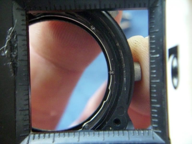

I do not have enough hands to take a pic of how to place the E-Clip near the pusher with a scalpel blade, position it at the collar of the Pusher with a needle and push it on with the blade of a small flat screwdriver. And i do not have a Macro Lens, so i had to shoot through my thread counter... Hope you can see where the clip needs to sit.

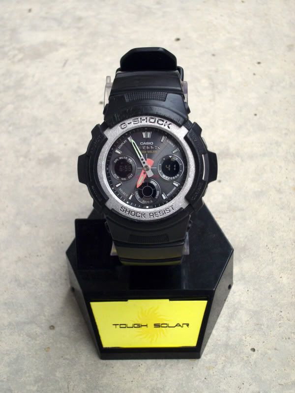

As i received some new Resin for the AWG and put the AW-591 back together, i thought i´d share a few quick shots of the reassembled watches.
The AW 591 has a blacked out bezel ring, black PVD coated buckle and stelthed bezel. The AWG has the bead blasted hardware already shown, just new, stealthed resin bezel and strap. The stock AW-591 is for comparison - tha blacked out one looks somewhat more massive and more compact at once in my opinion.

I would paint the lettering either gray like the dial, yellow like the "tough solar" lettering, pink/red like the hour hand or white.
Photoshop would be helpful to get a good impression how it would look like.

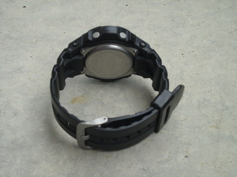

To sum this thread up i did a few better (but still far from what you are used here...) pictures of the watches:

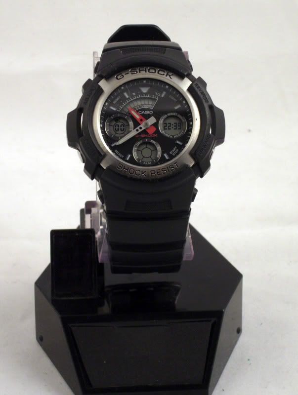

for reference: A stock AW-590, used and with a blacked out bezel, but otherwise as they come from Casio
The blacked out one:
After finishing i saw i just created myself a positive display version of the ML Minus the PVD coated buttons. But I´m quite pleased with the outcome.
This is the AWG, itr looks real nice in all new resin with the media blasted parts, the soft, smooth resin contrasting nicely with teh rough metal.
I´m looking forward to your feedback.
