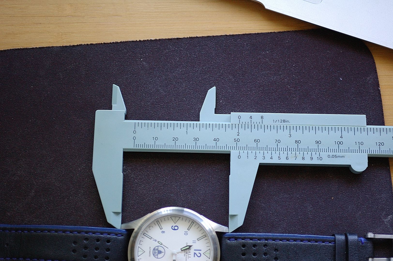

Case width:
You measure it across the case excluding the crown with a ruler or calipers. (See picture. The size is 43mm)
Or with a caliper (note the 0 mark..again 43mm)
Note: I use plastic calipers to measure, while not as accurate as the metal digital ones they are less likely to scratch the watch.
