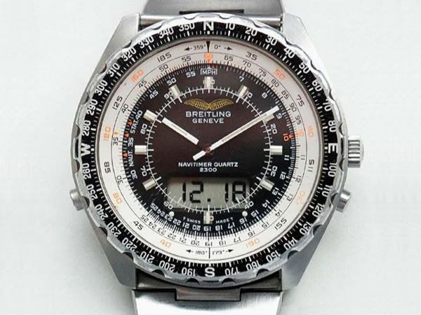

The 'Jupiter' was introduced in 1980 by Breitling in the year following the take-over of the company by Mr Ernest Schneider. Along with the closely related 'Mars' and 'Pluton' chronographs, the Jupiter was designed for military pilots but also with an eye on the civilian aviation market. There were various bezel options and differences between the three models but the movements and therefore the functions are identical.
At this time, all Breitling pilot's watches were considered part of the 'Navitimer' range and the Jupiter was named 'NAVITIMER QUARTZ 2300' on the dial. It has a non-ratcheted combination bezel comprising a circular slide-rule (Type 52 derived from the Navitimer ref 806) and a wind-rose (compass degrees) scale. Between the these two scales are flight levels in two colours for VFR/IFR and East/West flight separation.
The dial has a white Breitling wings logo, the design of which was heavily influenced by the logo of the AOPA (Aircraft Owners and Pilots' Association). The model reference 80390 is stamped into the case back.
ca 1980-82 Navitimer 2300 Jupiter ref 80390

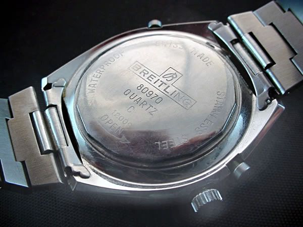

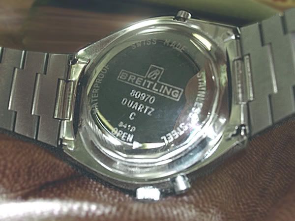

From around 1983 the Breitling wings were now gold in colour and the model reference was 80970. It is believed some early ref 80970's were fitted with the previous white-logo dial.
Jupiter ref 80970, circa 1983-
Jupiter ref 80970 case back

Case back of an Iranian military Jupiter. It is the same
as the non-military version

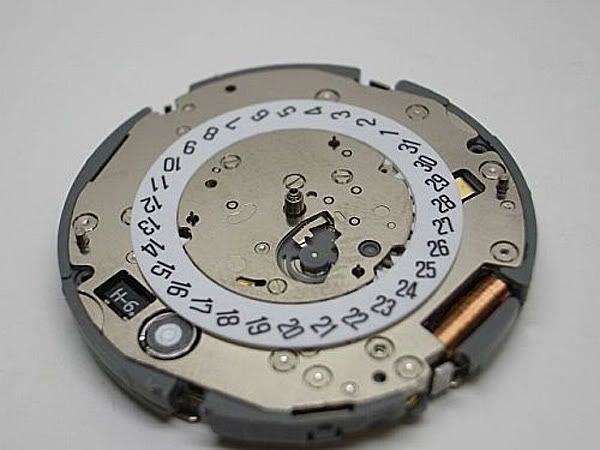

The movement, known as the Breitling caliber 59, is the Japanese Miyota 3S10 which measures elapsed time to 1/50th sec. Its alarm function is controlled by pulling/pushing the button at 3 o'clock.
Miyota 3S10 12-jewel quartz movement from a Jupiter Pilot (battery removed)
Date-wheel side of a Miyota 3S10 movement​

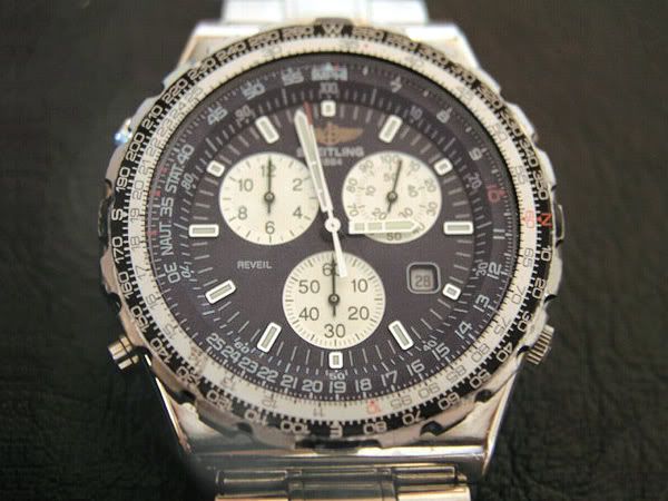

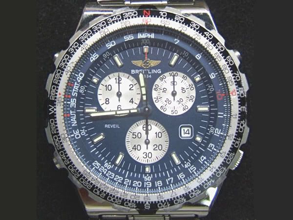

By late 1994 the ref A59028 had a new dial and hands. The word "QUARTZ" on the dial was replaced with "ALARM" (or the German "ALARME" or French "REVEIL"). The previously round date window was now squared. The hands were revised with the luminous compound divided into sections and the red part of the second hand now at the tip. The dial colour options remained the same as before, ie silvered with black sub-registers; black with silvered sub-registers; blue with silvered sub-registers.
Ref A59028 with black 'ALARM' dial
Ref A59028 with silvered 'ALARM' dial
Ref A59028 with black 'ALARME' dial
Ref A59028 with black 'REVEIL' dial
Ref A59028 with silvered 'REVEIL' dial
Ref A59028 with blue 'REVEIL' dial​
