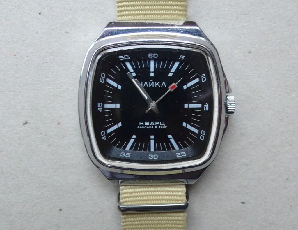

But now let's see the Chaika-branded version, the one I purchased yesterday, in the pictures below taken by the seller from whom I purchased it. The model, called Chaika 3056A, probably dates to the mid-80s, since it features the 3056A instead of the 3056. Chaika did very few changes on this model, limiting itself only to small aesthetic changes during its production life: it was produced with two types of chapter ring, one white and one black, as you see in the picture below. Small changes were also made to the dial, which saw the elimination of the seconds scale, leaving only the minutes one.

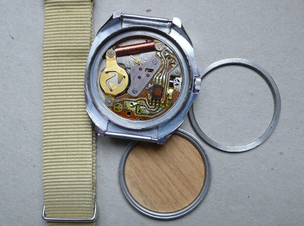

In the picture below you can see the 3056A movement exposed, and you may also notice the peculiarity of the caseback: The inner part was putting a woodgrain sheet that acts as an insulator to prevent a short-circuit of the movement. Since the original gasket tends to melt with time, it has been removed, but it's not a big issue, since I never let water get closer to my watches (since none of my watches are water resistant).

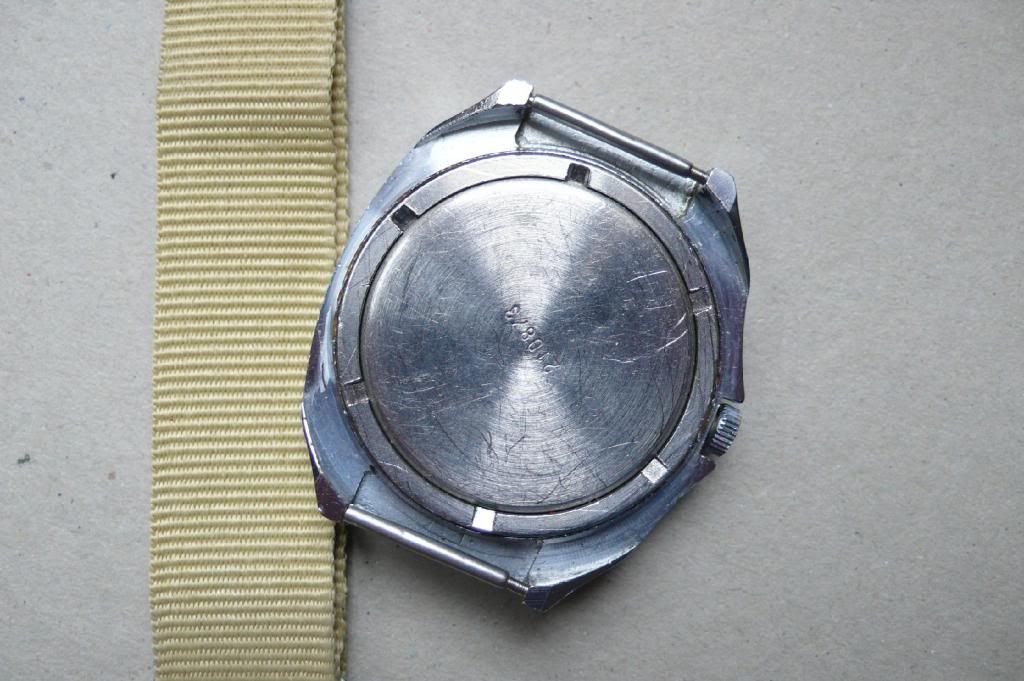

The caseback, unlike its ancestor, is no longer protunding the obsolete words "Kvarzevi rezonator" are a far memory of the past, featuring only the serial number. The case, as well as the crown, are chrome plated, and have some brassing due to daily use, although it's not excessively worn.

And finally, after I've opened not one but four envelopes like a Matryoshka, the watch pops out in all its charm! The watch is in very good condition. It does have some light scratches due to everyday usage, but they are visible especially on the rear, where there's some brassing around the caseback, probably due to inappropriate tools used to open the watch.
The acrylic glass has some light scratches, but it seems to has been polished, since the scratch aren't so deep, however I'll polish it further in the future.
So, I replaced the NATO strap with a temporary steel bracelet, which allows me to wear it until I'll put something that looks better. What I've immediately noticed was the movement of the second hand: unlike CRP-3050 and 3056, due to the smaller stepping motor, the second hand "snaps" like on the more "modern" quartz watches, instead of having that light backlash that characterized the previous generations of Soviet quartz movements (in addition to its particular ticking noise).

After that, I proceeded to disassemble and clean the watch. Armed with a cotton swab, a small screwdriver and a pair of scissors, I unscrewed the caseback, and once I opened it, I noticed that the original gasket, which is usually known to melt with the years, it was petrified, and was broken in some parts. So I scrapped the gasket, and I replaced it with another one borrowed from the broken Chaika 3050-KR, which I keep for parts for the new one I currently wear on rotation. The diameter isn't identical to the one of the old gasket, but it's fine as a temporary solution, as this watch will never see the water, like all my other vintage watches.
I then removed all the dust on the dial and the acrylic glass, and then I reassembled everything. After I've reassembled the watch, I looked at the movement, the 3056A. IMHO it's very fascinating, with its primordial electronics. Yes, it's more evolved than the old CRP-3050, but its large printed circuit board, its jeweled mechanics, the large coil that occupies a lot of space in the movement, makes it quite fascinating.
Then, I noticed something rather curious: on the main bridge, we can see the Chaika logo, but instead of being written 3056A, it says 3056. Maybe the original 3056A-signed bridge has been replaced with the one of a 3056? After all many parts of the 3056 and 3056A are interchangeable.
Another thing worth to notice is the coil. It seems to be covered by a thin layer of sylicone, to protect it from dust and other damages, but the thing that makes me a bit surprised is its proximity to the battery contact: someone with a not-so-firm hand might damage the coil quite easily. So I will ask the watchmaker to replace the battery for me, to avoid potential risks... :-x
On the printed circuit board, also, we can see the Integral logo, the factory where the module was produced. The quartz crystal instead, produced by Chaika, is located at the bottom left, under the PCB. Something interesting is the way the crown is installed: instead of using the classic button to pull out the crown must pry the plate with a small screwdriver, to remove the crown. It might be a little difficult at the beginning, but once you learn the correct procedure, its extraction becomes quite simple.
Very interesting is also the hacking feature. Unlike the previous CRP-3050, where the hacking is only electrical (on first gen of the CRP-3050, the electrical pulse of the stepping motor is reduced, but not cut completely, so the wheel of the motor "tries" to move, but due to the unsufficient electric pulse, it remains still. There's a lever tha blocks the wheel, but the movement stops due to the reduction of the electric pulse rather than by the lever itself. On the post '77 CRP-3050, however, the electric hacking was removed, leaving only the lever to physically block the stepping motor wheel, without interrupting nor reducing the electric pulse) in this watch the feature is designed differently:
when the crown is pulled, a lever physically blocks the train of the time (you can see the hacking lever in the small slot that is on the main deck), plus the electrical impulse, instead of being reduced considerably, it is temporarily disabled , completely stopping the movement, until the crown returns to the neutral position.
