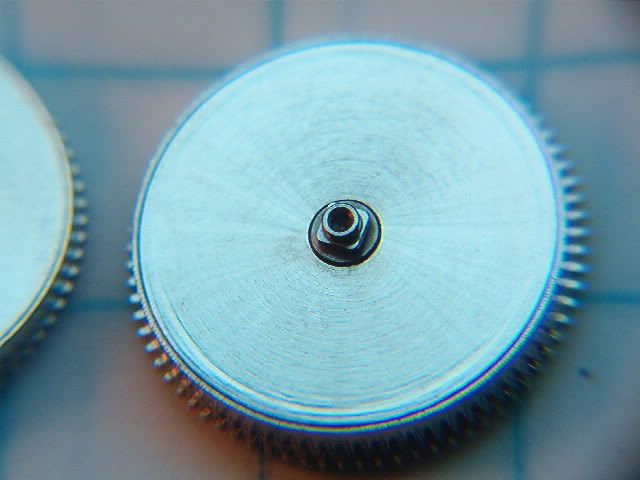

I was asked Zoodles95 to tear down and compare these two movements during a routine service so we can see just what are the differences between these two movements:
(Note: the top,or right-hand image will always be the CL-888 and the bottom, or left-hand image will be the ST16.)
Here are the two movements in there respective cases, the CL-888 in a large black Swiss Legend; the ST16 in a smaller Seagull.
The first thing done was check the timing of the two:
CL-888:
Beat error - 0.9 ms
Rate - +6.00 (dial up), +21.5 (crown down)
ST16:
Beat error - 1.5 ms
Rate - -7.2 (dial up), -11 (crown down)
Both of these rates are acceptable, and should average within my preferred band of +/- 10 s/d.
Now we start withe the actual disassembly of the movements. For those who wish to see the actual steps taken I refer you to the WUS thread titled "Inside an ST16 (lot's of images)", where did a step-by-step on the disassembly of this movement.
I thought there would be some differences between the two, but, as you will see in the following pictures, there isn't.
Mainplates
Date wheels
Main Bridge
Auto Bridge
Rotors
Bridge for the 2nd Wheel
2nd Wheel
4th Wheel
3rd Wheel
Balance
Pallet Bridge
Pallets
Escape Wheel
Barrel
Auto-winding Reduction gear
"Magic Fingers" for auto-winding
Click/Click spring combination and hack lever
C-spring
Here is the only difference I found:
The CL-888 had two second hand pinion tension springs.
My comments in a moment, for right now, I'll let your modems cool back down.

Now, for my comments. These two movements are the exact same design, all the parts are identical and probably interchange (I had to be very careful not to mix-up the parts.)
One difference between these two movements was the finish. I have always associated heavy, shiny chrome or nickel plating with cheapness, as is it is often used in an attempt to cover small machining imperfections. The Seagull is heavily plated as opposed the the light satin finish of the CL-888. This, with the deep cut Geneva stripes, detracts from the rather utilitarian design of the movement. But, that is just my opinion. There are ST16 movements out there with the lighter satin finish and I prefer them, but that has a lot to do with how I feel a Geneva finish should be done, and how Seagull does it on this and more noteably the ST19.
The other visible difference was the addition of a second tension spring for the second hand pinion. This could have been an error during assembly, or it could be an attempt to ensure that the chances of second hand stutter are minimalized, right now, I don't know if it was intentional or not, but, if I see another one with two springs....
The hair, or balance, spring on the CL-888 was better formed and the timing shows this. The rate of all watches in a timing machine varies slightly and the quoted rates are averages over a short period of time, but the CL-888 varies less, about the same as the average Standard grade ETA.
Now, I know what some out there are saying, "So where do they get off saying that is a SWISS movement?"
Well, the rules allow of up to 50% of the value of the entire movement (not including labor) to be of non-Swiss origin and a movement to still be considered "Swiss." The hairspring was almost certainly Swiss, as Chinese one usually don't look that well formed, the mainspring probably (although the two were identical, as far as I could see), possibly the rotor and maybe the plating as well. These parts could very well account for over 50% of the value of the movement, as brand new Chinese movement can be had retail for 10 bucks, imagine what they cost if you order 100,000 direct from the factory, unassembled.
(By the way, for those who feel this is a rather loose definition of "Swiss Made", you should read what is required for the "Made in USA" label, while not as ridgedly defined as the FHS definition, it is a better definition.)
Other observations: The CL-888 was clean and tidy on the inside and properly oiled, the ST16 was relatively clean but the oiling was spotty, some pivot had a hint of oil, others did not have any.
From what I have seen the Claro-Semag "Triple-Eight" is an improved ST16, in that it has a better hairspring and is more consistant in its rate and lubricated for five to ten years of wear before it needs looking after. These aren't big, or really even noticeable to the average guy wearing watches in these price ranges (who don't plan on ever servicing them), but they are improvements. Whether, or not, you feel they are worth the extra cost of "SWISS MADE" is entirely a personal question.
In any case, the design is an excellent design, capable of hard use and good timekeeping.

Jewel count:
Mainplate jewels: one in the center, one next to the oil stain on the CL-888 at 9 (for barrel arbor), two on in a line angled at 2 (3rd and 4th wheels), one at 3 (escape wheel), one just above the balance jewels and the two for the lower balance pivot. Eight (8) total, the ST does not have the one at 9, giving it seven (7).
Main bridge jewels: three (3) in the upper right, both.
Auto bridge jewels: one (1) at the top
2nd wheel Bridge jewels: two (2).
Balance and balance cock jewels: one impulse jewel, two for the balance pivot (underneath), for a total of three (3).
Pallet Bridge jewels: one (1).
Pallet jewels: two (2)
Magic Finger jewels: one (1)
Adding the numbers in parenthesis, we get 21 jewels for the CL-888 and 20 jewels for the ST16.
