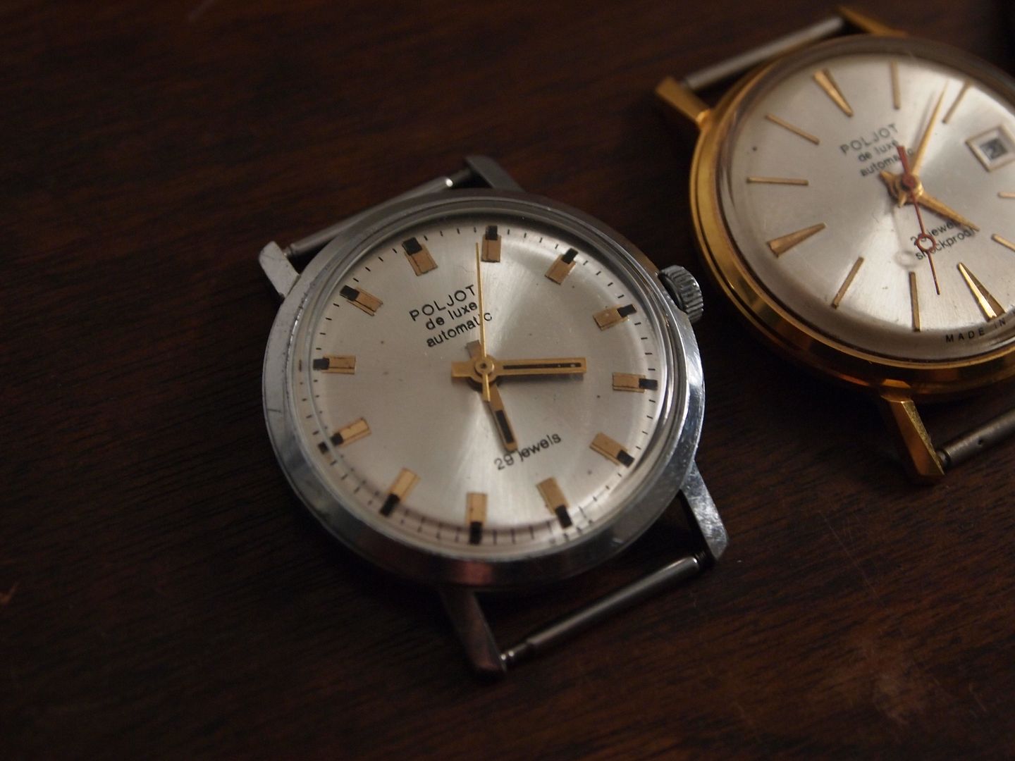

Next! The Poljot Autos.... These are quite interesting... 2 (with date) are 2416 cal and the other is 2415.... I say these are interesting, as the Auto system is built into the movement, instead of a variation on a handwind... But Roland (as always)describes it better..
bidfun-db Archive: Watch Movements: Poljot 2416
One thing Roland says 'low volume production' which makes me think...... what is meant by low? As I have 3!
anyway... pics......

Then the second group are the Poljot 29-jewel automatics, on which I am quite keen: here is a thread I started a little while ago. The no-date version was the 2415 "Orbita" and the date version was the 2416 "Kosmos". Starting with the one in the middle, it is a second model Kosmos with date window rather thna pointer date, in an older-style "stepped case": the second hand is not original and appears to be from a Vostok, and the crown does not look right. I have some misgivings about the one on the right as the case looks too new compared to the dial and hands. The Orbita on the left is later than the one in the middle as it has the later round case without the step and the "Poljot-look" dial but the hands appear to be from a much later model as they are too short and thick.

3. 2415 'Orbita'.... I agree the minute hand looks like an hour hand from another watch!! the black marker on the minute hand differs to the hour hand!
4. Gold 2416 'Kosmos' crown and second hand looks to be replaced.... but looks ok!
5. 'silver' 2416 'Kosmos' looks to have been recased!

As I describe the Poljot automatics in the second lot of pictures under their original names, I cannot see why you cannot call both of them "Signals", but of course, I would call the Signal-signed one "Signal by 1MWF" and the other "Poljot alarm watch 'Signal by 1MWF'". I am not knowledgeable enough to authenticate Signals, so I hope someone would be able to step up!

3. 2415 'Orbita' Poljot.... I agree the minute hand looks like an hour hand from another watch!! the black marker on the minute hand differs to the hour hand!
4. Gold 2416 'Kosmos' Poljot crown and second hand looks to be replaced.... but looks ok!
5. 'silver' 2416 'Kosmos' Poljot looks to have been recased!
