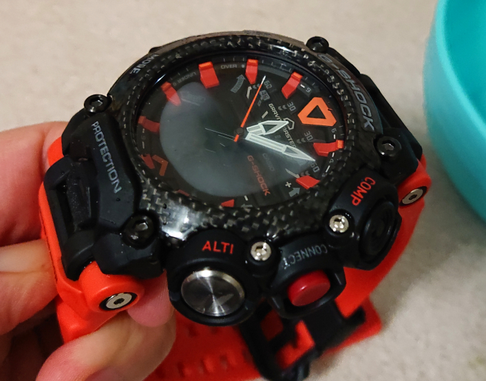

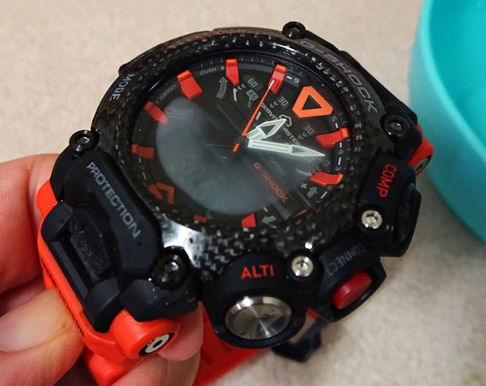

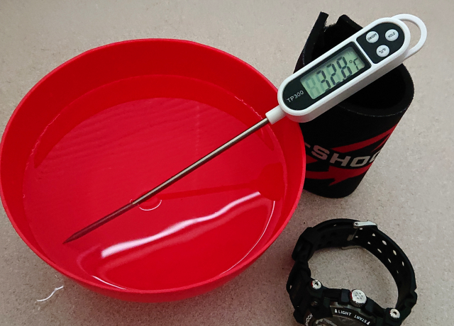

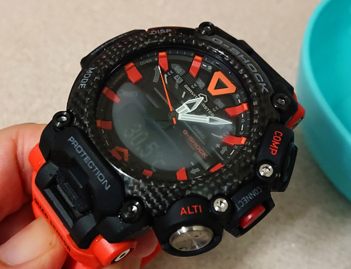

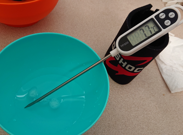

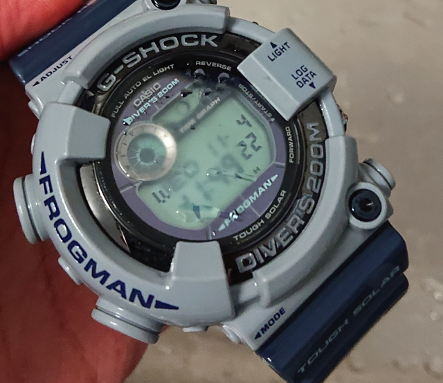

I prepped two bowls of water, one with warm and one with cold.
I waited for the temp to become steady on both. You can see the remnants of a couple ice cubes in the cold bowl, I left them in knowing it would warm faster than the warm bowl would cool.

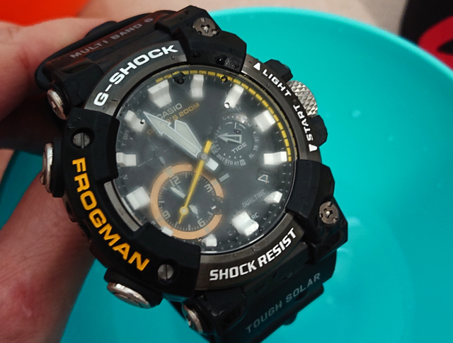

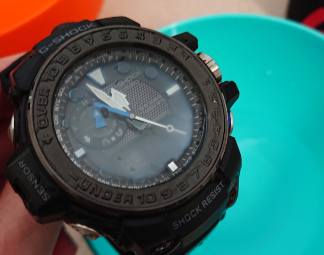

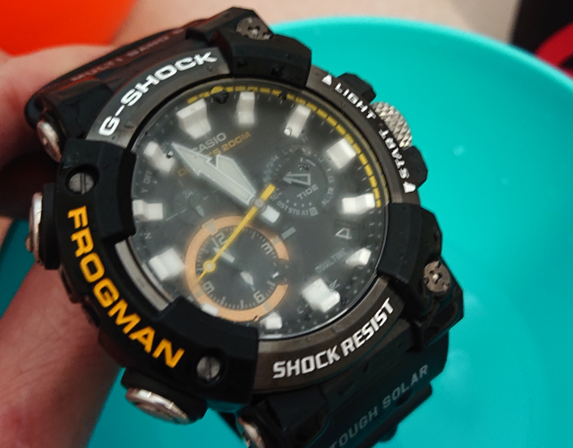

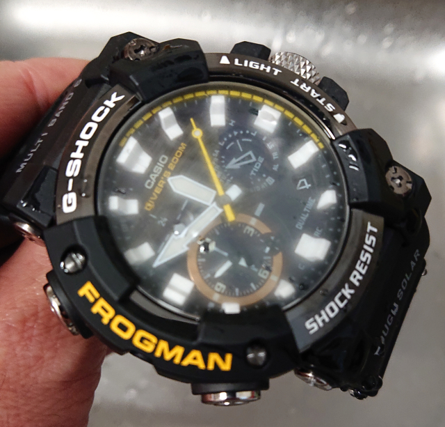

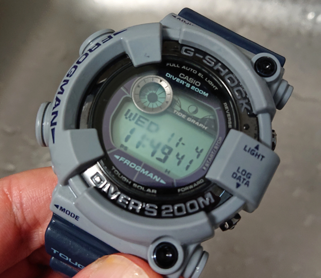

In goes the Afrog. I also grabbed the gf8250 and a gulfy for comparison re: another frog and another model with a crown.
I left them there for about 15-20min then dunked them in the cold bowl. Temps had shifted 1-2 degrees but it was bringing the numbers closer, not apart so I wasn't too concerned.

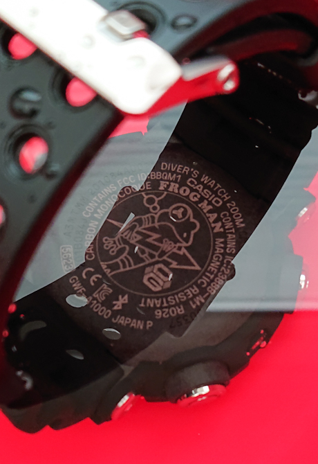

This is watch from the creator of other thread for comparison
15546338
Bit less noticeable on the 8250 cos of the lighter coloured background but it happened to another premium model just the same. I went a second dunk with the Afrog and it had just enough warmth for more fogging (tho it cleared a lot faster). obviously if the temp difference remained the same, the effect would continue.
This effect varies between models and country of origin but as casio says, its within their operating parameters and classed as normal.

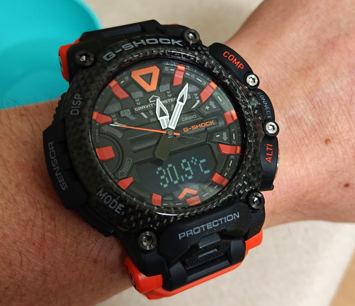

UPDATE: 30/11/20
Experiment #2
Some minor tweaks to the original experiment.
Prelim info:
  • Instead of soaking the whole watch to get it up to temp. I simply used the one straight from my wrist. So instead of everything being the same temp, this will replicate how the top of the crystal is constantly cooled by the ambient air it is exposed to.
  • in the first experiment I didn't really focus on how I dunk it into the cold water, it varied from fully submerged to mostly. This time I tried to keep it only on the crystal ie. Submerging it about half way. I only did half the crystal so it was easier to see the contrast between fog and no fog. Easier said than done trying to hold it within mm of the sweet spot depth.
  • I made sure I wiped the crystal properly before taking photos since this was a source of contention in the first one.
  • to eliminate any (albeit unlikely) variables from a watch that had been worn about 10 times, the test subject is brand new, straight out of the box. Worn for about 2 hours before testing.
  • room temp was about 23C, tested near an open window, outside temp was about 19C and breezy at midnight.
  • Cold water bowl was ~8C. wrist/watch temp as per the pics ~30C
I don't know about anyone else but the results were unsurprisingly unsurprising.
Looks very much like what I and the OP experienced originally
Conclusion:
Does light fogging occur? Yes.
Is light fogging bad? No, if it goes away after the temps have equalised.
Is there proof this will ruin your G? still none.
Will Casio accept a return and replace? Yes, as per a single reference case. Result will probably vary between countries, retailer, staff and possibly the model in question.
Is it worth being without your new watch for weeks if they replace it? up to the owner.
Will it occur on a brand new one or whatever condition the replacement is in? Most likely, as shown here with a brand new model. Original owner still waiting on his replacement.
* WARNING: This thread has unfortunately been derailed with alot of discussion on irrelevant watches and conditions, proceed with caution beyond this point *

good point esp. since frogs are recommended as "service center only". in saying that, the Afrog is just as easy a backplate model, it just has a few extra screws
15551012

Also, in the past, I have done many (unrelated) tests on my GWG1000 and on my PRW6000, placing them from an approx 75F room into our freezer, so to about 0F.
During these tests, I don't recall observing any significant fogging inside these watches either (maybe a little bit in the center of the crystal) and I used to have them inside the freezer up to 2.5 hours long.
As a quick update recent reference, I have again put my PRW6000 into the freezer from a 75F room and left it there for 10 minutes. When I have opened the freezer door, the watches internal temperature meter was showing 42F measured, which is normally lagging behind, so the true temperature of the watch case may have been likely even a few degrees lower.
No internal fogging what so ever. When I have opened the freezer, the watch crystal was crystal clear. Of course it rapidly started fogging up from the OUTSIDE as soon as I took it out of the freezer and it got in contact with the warmer moist outside air. But again, only from the outside, which I could keep wiping away.
fogging only occurs if the temp drops below the dew point, clearly it didnt reach that value. same way its not going to occur if youre doing the experiment in reverse, ie. warm air outside the watch. the effect you witnessed however is the same tho, just on a greater scale.

Tetsu, i am saying if your watch on your wrist does fog and stay this way it 100% defective no matter what i think about Casio i would think same about any watch from any company.
If watch fogs too much for what i expect from it will mean only one thing
There is more water inside than you would expect from air at 30-40% humidity at 22C (AC manufacturing).
There are other reasons i think there is far more water than you can see inside due to physics and construction of the watch.
Are your watches defective or not it's for you you to be judge of it.
They are your watches not mine.
Now for whom your type of experiment is relevant? Probably only for these brave people who dive under the ice in arctic/antarctic and any other place. Where water is coldest and consequently watch will see about 0C .
Also it may be relevant for these dudes.
15552076
Would one drop of water damage your watch? No i don't think so. Would it affect functionality? No. Should it be inside? No. Would it cost too much in this scenario to replace every watch which fogs to Casio... yes. Is there are interest for Casio to BS their way out? Yes. Would i expect it from any other company? Yes.That how warranty works.
By the way any diver watch has Service Center only written somewhere because servicing and testing after service is more rigorous for this type of watch.

9,951 Posts
Discussion Starter · #17 ·
I definitely don't think that at all!
Do I think some watches make it out of QA with some minor failures? Statistically, yes, I think it's an inevitability. Is every case of fogging a problem with the watch? No. Is it a sign that Casio is a bad company? No way!!
But is it ok to ask for a watch that doesn't fog internally when I go outside and back indoors? I think so. We just can't ignore the personal, real world evidence that most watches do not fog on the interior of the crystal even in extremely cold weather. I must not refute the validity of my own experiences :)
I have troll PTSD, and I, like you, have seen people take stuff to the extreme and start bashing companies when there is even a hint of an issue with a watch. That's why I think your test is good and useful.
statistically, theres always a chance but those chances are so minute esp. when it comes to seal failures on new Gs, let alone brand new yamagata PPL models.
sure its ok to ask for things but if its something thats known then its less about asking and more about accepting reality.
we also cant ignore the personal, real world evidence that under certain conditions, it can and does happen. i too can not refute the validity of my own experiences, the experiment or casios words. i also wouldnt call 7-10C extremely cold (tho most ppl in my city would say anything below 20C is extremely cold lol)
exactly why i thought doing this little experiment was a good way to dial back the raging mob. didnt want it to turn into another rangeman lug "issue" lol
instead of a bunch of hearsay, i wanted to put something simple yet quantitative together. you said the experiment proves what it tests but thats not exactly right cos i wanted to replicate the conditions the other person had so basically wanted to prove that the same watch in similar conditions would yield the same result. i also expanded the experiment to include other models to prove that it wasnt related to the watch.
i honestly dont know what else i could done differently, it seemed pretty straight fwd to me at the time. now spend WAY more time on it than i had ever envisioned or would have liked! lol thatll teach me for being proactive! haha ?
· Registered
9,951 Posts
Discussion Starter · #18 ·
However I believe your lab experiment setup is far too extreme and appears result driven. Yes, it may prove that condensation can be induced in extreme circumstances, however those are far from anything that anyone may experience who is wearing any watch.
far too extreme by using pretty much the identical parameters when it occurred naturally?
far from anyone wearing the watch... apart from the guy that was? lol
was havent the watch at body temp. then going out into ~7C too extreme and far from what someone would experience?
what would you have done differently to replicate what he experienced? ie. wearing a watch on his wrist and going outside to a 7C day
Like someone has mentioned in the beginning of this thread, I too think that the test should be done according to ISO 6245 and that is all. Pass or fail.
like i said, did and reiterated, i also did the ISO test and it didnt show any fogging but i also said, this would be a poor test to view this kind of fogging cos thats not what the original wearer did (or what anyone would do in normal conditions) re: a single drop of water - but as rocket said, its liking designed to test other things.
· Registered
9,951 Posts
Discussion Starter · #19 ·
i agree 100% but that was never the point of the experiment or what has happened, the fogging cleared
what about all the other new or unopened watches that have been posted here and on facebook, are they defective?
if they were defective, why are ppl only complaining about it in winter? wouldnt it be worse in summer when they go swimming and the watch is properly submerged for long periods of time? wouldnt it get worse as more water enters the watch?
not really cos i didnt put it in 0C cos the original poster said he went out in 7C temp so thats what i gauged it on. its relevant cos i used pretty much the exact same conditions as him.
how else should i have done it?
theres alot of naysaying and unrelated info here but no suggestions or alternative solutions. not sure why my experiment is so flawed when all i did was replicate it as close to the original as possible but i am more than happy see the results from others (y)

Tetsu your experiment shows yes there is moisture in the air and if you coll it down there is a fog. Yet under normal use of watch the only way to get to same results will be either swim with the icebergs or put your watch outside your clothing in the winter. Which is far from any normal use.It's right experiment just not representative of the problem OP had.
I also pointed to if i see my watch fogging under these normal conditions i would call manufacturer if watch is under warranty.
Long time ago my friend told about a friend who bought Omega (at the time and still it's huge deal) for some reduced price and found it fogged after shower...
My instant reply was real and non defective Omega don't fog in shower.
If your watch stay with the fog on your wrist that means amount of water in the air inside the watch rose 4-5 times from where it should be or was.
In many years owning many watches i don't remember any of them fog. Regardless of literally deserts, mountains, tropical islands or -30C winter i did exposed them to. I am literally talking 100s of watches. It's not like i did not seen fogged watches i just recently got one Seiko chrono for cheap i intend to take apart and clean and just passed on other Seiko with same problem because it's not really impressive to get diver style watch with singes of fog. In case of chrono i know buttons are culprit which lead water in. Just fogging did not happen to me and new watches i bought.
I once almost got into accident when my car windows fogged on inside to condition of 0 visibility. I was lucky and road was straight with nobody present in my lane. Fogging does happen given opportunity just not in the watches i own.
