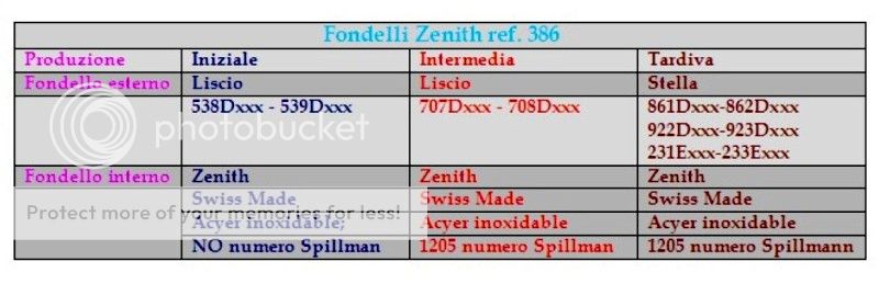

First, very important not to consider casebacks from other El Primero references. It confuses matters.
Second, SP 1205 is the only correct Spillman number for the A 386
Third, by using caseback numbers, I find clearly three production groups
Again, from my database (14 examples total):
Type A
Early production series
3 examples
- case numbers 538Dxxx - 539Dxxx
- plain caseback
- internal inscription as follows
a) Zenith
b) Swiss made;
c) Acier inoxidable;
d) no Spillman number
The writing is centered

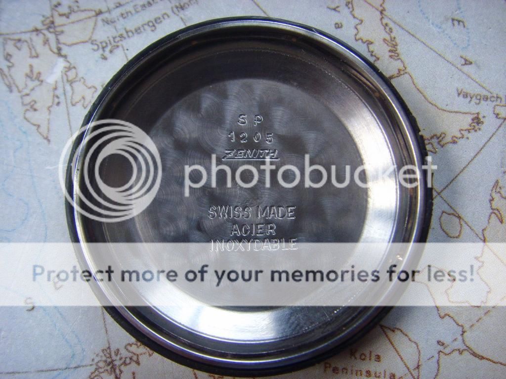

Type B
Middle production series
4 examples
- plain caseback
- case numbers 707Dxxx - 708Dxxx
- internal inscription as follows:
a) Zenith;
b) Swiss made;
d) SP 1205 (Spillman number)

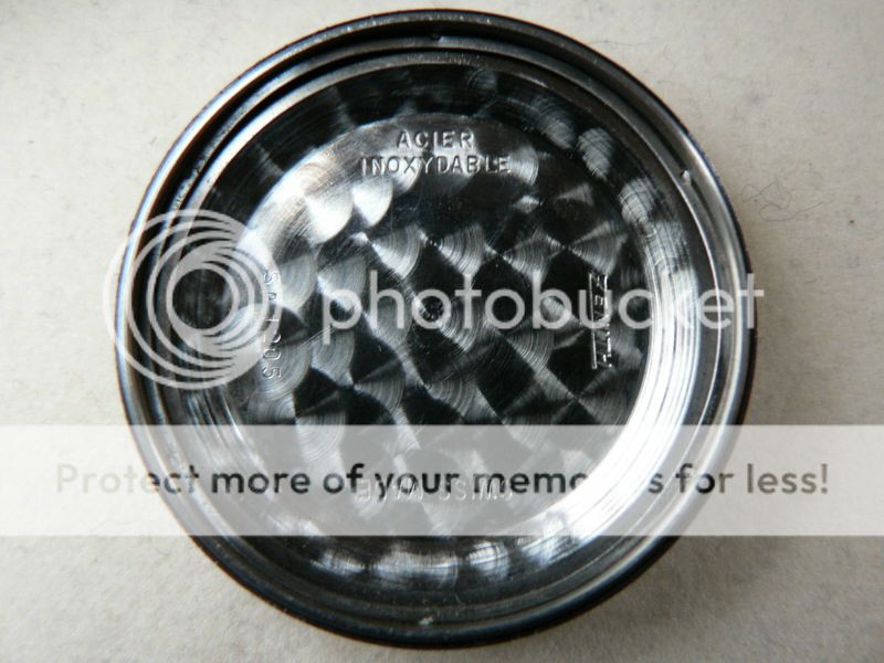

Type C
Late production series
6 examples
- Caseback with four point star (NATO star)
- case numbers
861Dxxx-862Dxxx
922Dxxx-923Dxxx
231Exxx-233Exxx
a) Zenith;
b) Swiss made;
d) SP 1205
The writing is arranged circumferentially
The incorrect watches, which I believe to be forged as longinespassion has stated, have correct casebacks, but they are incorrect for the case number
In addition, case numbers lie outside of known production series, typically in the mid 900Dxxx range (922 & 923D are authentic). Dials tend to be modern-style service dials as discussed elsewhere on this forum.
for example, serial 936D460 - Type B caseback
Friend Nicola1960 has summarized the above in a nifty table:
I hope this will be of some use to members....

If I may point it out, there is a small mistake for type B, where you now mention a range of serial numbers 707Dxxx - 708Dxxx. In your earlier table of serial numbers, as well as in the beginning of your getting involved in the discussion on O&P, one can see that the range of serial numbers for type B starts at 706Dxxx. At the bottom of the page Ref. A386: Zenith "contatori sovrapposti" a 3 colori - page 13 you have also shown some correct examples starting with 706Dxxx.

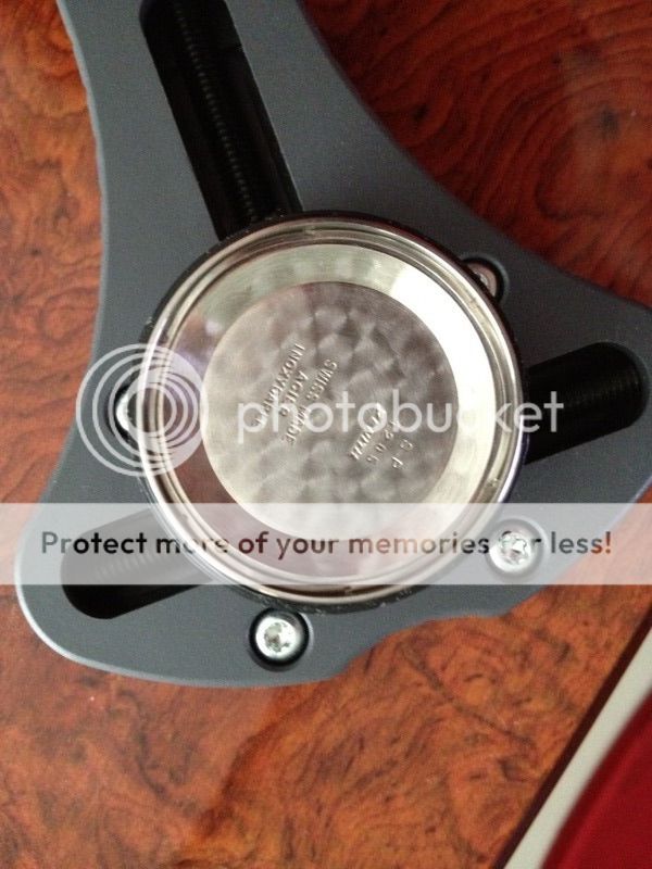

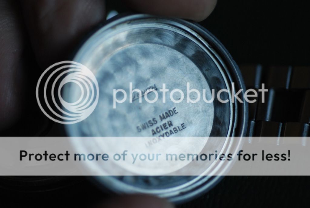

Let me reproduce here the examples which you have given on the Italian O & P forum of suspicious serial numbers :
there are three watches with caseback numbers that do not fit, or stand well apart from productions sequences. Notice that they all have service dials and the serial number is engaraved more deeply. Here are some examples
So what do we have ?
Firstly there are three caseback numbers in the mid 900Dxxx range that do not fit the normal sequences.
That is not yet a sign of forgery. These could be 'outliers'.
In the Early El Primero Case Number Project - results thread you have shown nine other 'outliers', which you believe to be correct.
So why couldn't these numbers in the mid 900Dxxx range simply be outliers and correct as well ?
But, secondly, as you show in at least one example, the serial number of these is engraved more deeply. I agree that this is suspicious. To be sure one should be able compare it to other (correct) examples in the 900Dxxx range: maybe by that time Zenith had started to engrave all the serial numbers more deeply ? I don't think that is the case, but you have the better database and should be able to tell for sure. If not, the caseback on this one may have been polished and the serial number may have been engraved recently. Then still, it could be that the original serial number was simply engraved again.
Thirdly, you say that "all" these three Primero's with outlying serial numbers have service dials. That is too much to be a coincidence. It would lead me to think that maybe Zenith themselves (who supplied the service dials) also may have polished the casebacks at the time of service and engraved the serial numbers again. That, or the person who ordered the service dials may have polished the casebacks and engraved the SN himself.
In any case, I see no proof whatsoever of forged casebacks. All the casebacks shown look original and correct. To be sure of this, one should be able to check the inside of the caseback, but I doubt very much that you would find any irregularities there.
If you would consider a serial number that was first polished out and then engraved again, a forgery, then yes, I agree that it is quite possible that such an outrageous thing has happened. Possibly even something worse happened : it could be that somebody engraved serial numbers that were not extant before.

Personally, I think the opposite way. The depth and clarity of the case back engraving on the "forgery" (?!) is rather more than that found on the old Zeniths. And even allowing for wear and tear on vintage vs. NOS on forgery, the discrepancy is too great IMO.
Hartmut Richter
4,513 Posts
Hartmut, you're not succeeding in thinking the opposite way, as I completely agree that the depth of the engraving of the serial number in that caseback is suspicious.
That's why I thought it was useful to reproduce the picture.
I think we all agree that Lou is right in the sense that this serial number may be a forgery.
Although I can't recall ever having seen a vintage Zenith serial number engraved so deeply, I've suggested a comparison anyway with other casebacks in the 900Dxxx range, just to make sure.
But the fact that that serial number was probably engraved recently, doesn't mean that the caseback itself is a forgery.
It is not because somebody may have falsified the serial number of a Mercedes, that the car itself was not made by Mercedes.
It may be a false serial number : but to confirm that suspicion will require further investigation and proof.

If I may point it out, there is a small mistake for type B, where you now mention a range of serial numbers 707Dxxx - 708Dxxx...
You are correct, should be 706Dxxx-708Dxxx.
Highly unlikely. With the addition of further caseback numbers to the database, now numbering 34 examples for ref A 386, there are 5 very tightly defined production sequences, and these outliers are thousands to tens of thousands of numbers out of sequence, and equally separate from one another and serial numbers of other early El Primero references. IMO, these are fully invented reference numbers, by someone who is aware of SN format and also has a rough idea of the range of numbers, but not about the specific production sequences.
As an additional note, there are five suspicious caseback numbers that do not fit the normal sequences, not three. However, there are only three that I have good photographic documentation of.
To be sure one should be able compare it to other (correct) examples in the 900Dxxx range: maybe by that time Zenith had started to engrave all the serial numbers more deeply ?I don't think that is the case, but you have the better database and should be able to tell for sure.
You are right; it is not the case.
I believe the latter is indeed possible. He engraved fabricated SNs on casebacks that may or may not have belonged to the case, or even to the reference. Casebacks from other Primero references could explain the poor fit observed on some of them.
But one does - the inner engraving is not consistent with the SN according to the patterns I report. In addition, on a few, the four-point star appears to have been polished completely off of the back, very deliberately. I think this was done by someone who believed that the plain caseback was correct, and was trying to make correct-looking casebacks from starred casebacks from other cases. Unfortunately, not many inner casebacks from the suspicious examples are available for inspection
This is exactly what I believe happened - hence a forgery.
Hartmut Richter
Fully agree.
