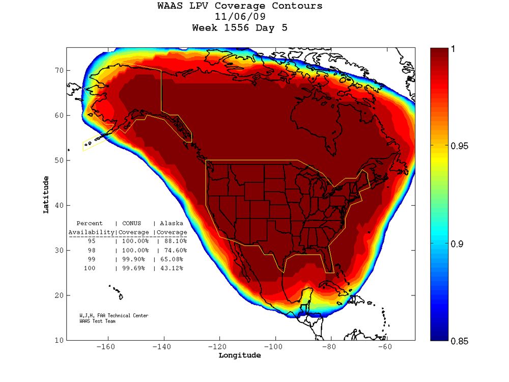

Yes, but... There's always a but, and maybe why Garmin leaves it disabled. There is generally less battery life in units with WAAS enabled*. It would be interesting to see if this is true of the fenix. I haven't seen any recent data on WAAS and battery consumption.
When I ran my battery consumption tests above, WAAS was enabled on my fenix. With WAAS enabled, it exceeded the spec of 16 Hours when GPS was in Normal mode. If there is any decrease in battery life when WAAS is enabled, then it is not enough to shorten the battery life to less than the specification.
Additionally, WAAS data is only available from two gps satellites, which are in orbit over the equator. They tend to be low in the sky in the USA, especially for northern parts. Unless you have a clear view of the southern horizon, you will often not receive the WAAS signal long enough to acquire correction data.
Here is the WAAS coverage map:
Seems that if you are in North America, you're going to benefit from WAAS.
Here is how it manifests itself on the fenix and how you can tell if you are receiving WAAS correction data:

How do I know the little "D" has anything to do with WAAS? Turn WAAS Off and all the little "D" markers no longer display.
Further, the GPS fix I have shown here was accomplished indoors, in my office, about 30 feet from the nearest window. So I don't think the WAAS data is unusually difficult to receive. Those satellites are probably not as low on the southern horizon as you suspect.
Maybe Garmin feels that a lot of users will not see a benefit, and they felt there was some power impact, so disabled it for USA units. That's my guess.
My guess is that since Garmin ships these all over the world, and since WAAS is only for North America, they felt it was easier to explain to North American users why they should turn ON a feature, than to explain to the rest of the world why they should turn OFF a feature.
(It doesn't look like any of these details are really given in the linked webpage. Silly Garmin.)
*edit: I did a little more searching for details on this. It sounds like with some Garmin units, Garmin says that WAAS 'significantly reduces battery life.' I don't think that's true of all their units though. I've used a Garmin Rino with WAAS in the past. I wouldn't say it cut battery life in half, for example, but don't have any hard numbers.
More discussion about WAAS than you may care to read: Should I have WAAS/EGNOS enabled on my GPS ? - Groundspeak Forums
I thought the Garmin explanation was pretty good: Garmin | What is WAAS?
As I see no evidence of reduced battery life in the fenix when WAAS is enabled, I wonder how germane discussion of battery life in other models is.
My conclusion based on observation and use so far is that if you are in North America, there is no downside to enabling WAAS on your fenix.
HTH
Edit to add:
Upon further investigation, WAAS will only work when GPS is in Normal Mode, it will not work when GPS is in UltraTrac mode.
This is evidently the case because in UltraTrac mode, the GPS is not on long enough to acquire the necessary data. It may also be the case that Garmin software will not allow the fenix to attempt to gather WAAS data, even if WAAS is set to Enable, when in UltraTrac mode.
Note: Satellites #48 and #51 are the two satellites transmitting the WAAS data and their corresponding strength bars will never display the "D" symbol.
Hmm, did your test occur in the same office you mention later? See below.
I'm interested in why you think the FAA's flight coverage for WAAS above 200-300ft above ground level for aircraft is applicable to people on the ground? It is true, that in many places with clear view of the horizon, handheld users will get good signal. This does not mean that just as many will have no signal at ground level.
Here is how it manifests itself on the fenix and how you can tell if you are receiving WAAS correction data:HOME>Setup>System>WAAS>OnThis enables WAAS on your fenix.Then go to:HOME>GPS Tools>Satellites(wait for a fix)then scroll up or down until you see this display:
At first, all of the signal strength "boxes" will be plain boxes like satellites number 18 and 22 in the pic. After a while, however, if you are receiving WAAS correction Data, a small letter "D" will be displayed in the upper left corner of the box which denotes correction data for that satellite has been applied.How do I know the little "D" has anything to do with WAAS? Turn WAAS Off and all the little "D" markers no longer display.Further, the GPS fix I have shown here was accomplished indoors, in my office, about 30 feet from the nearest window. So I don't think the WAAS data is unusually difficult to receive. Those satellites are probably not as low on the southern horizon as you suspect.
I'm surprised, so I tried the same. In my office, I receive no gps signals at all. I did receive WAAS in the office parking lot, fairly strongly. I then left the watch on for the ~10 mile drive home. The WAAS satellite signal was gone shortly after leaving the parking lot. All 'D'ifferential data disappeared within about 5-10 minutes. I did not receive any indication of WAAS over the entire drive home.I'd suggest you try it outside your office in some more real world usage. ;-)
While you are technically correct that WAAS is North America only, there are systems in other countries using the same correction technique. I would expect Garmin to support them as well.
