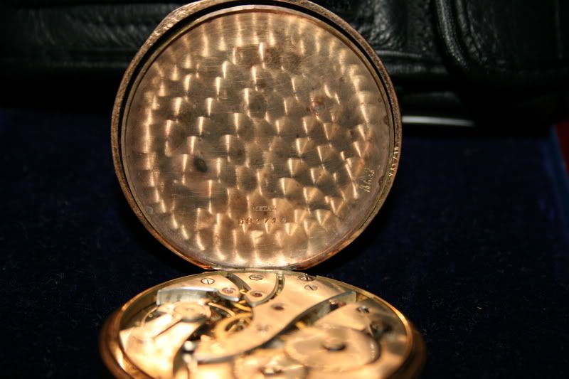

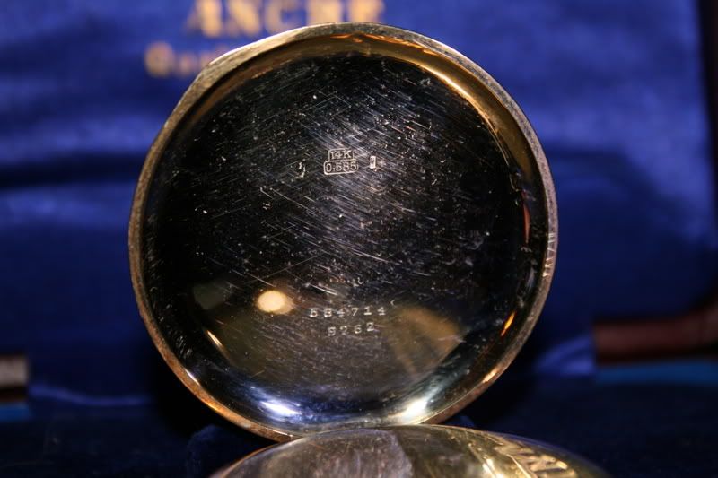

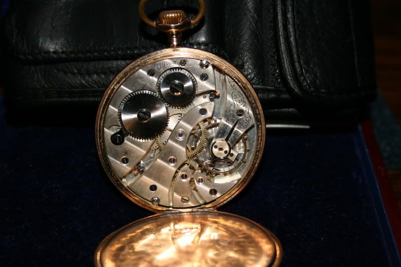

My grandfather has 14ct gold Union ancre pocketwatch i could not find a lot information about it so i would like to try it here.
I would like to know how old this watch is.
If someone need some additional photos you can pm me.
Thanks

I would guess the first half of the 20th century... hummmm... I seem to be guessing that a lot in these things... maybe as early as the last quarter of the 19th century. Not uncommon... there is an almost identical one on eBay right now. Googling seems to indicate it is Swiss or French.

I'd say Swiss for sure, 1890s probably or maybe as late as 1900-1910.
Serial numbers on the case are of little value in identification.
It's a 15 jewel watch which was pretty good for that time. Thanks for posting.

I found some numbers made inside the movement cover by hand, does anyone knows what its means? it looks like 4832
10630
Probably scratched on by a watchmaker after he serviced or mended the watch. They all use their own systems - which may or may not include a date. He would then be able to look back in his notes to check what work he had carried out, and when, next time the watch was brought in.
G
Yep, looks like a service mark ("Reparaturzeichen" we say).

I'm sorry but I can see no way that that watch is pre-WWI. The movement has full keyless works and looks like a classic inter-war PW movement. Very likely swiss, reminds me a bit of the old Cortebert calibres, although the exact plate and bridge layout doesn't quite fit..... Compare:
http://www.ranfft.de/cgi-bin/bidfun-db.cgi?00&ranfft&0&2uswk&Cortebert_522
I am also wondering whether "Union" has anything to do with the current Union Glashütte.....

In 1883 ALPINA was founded as a cooperative (watch producers and dealers) Name: "Schweizerische Uhrmacher-Corporation" (SUC). Since 1890 the SUC was located in Biel/CH. In 1899 a branch offcie was opened in Berlin. In 1905 some manufacturers from Glashütte joined the cooperative.
The SUC then tried to sell their watches under the brand name "Alpina Union Horlogère Glashütte SA" but these watches haven´t been produced in Glashütte. Kind of "marketing trick".
In 1908 "Union Horlogère"was founded.
I attached their logo and stamp.

You don't see a lot of the enamel dials after WWI - at least you don't on North American watches. Keyless winding was around prior to 1914.
