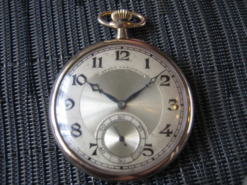

Here is my Gruen pocketwatch, it is a Very-VeriThin model. There is not much information to find about these, the best is probably here:
http://www.pixelp.com/gruen/index.html
The serial number of this is 500502, I believe it could be from between 1920 and early 1930'ies when Gruen changed the name from VeryThin to Very-Thin. I would appreciate if someone could give a more accurate timeframe.
The movement is a VeriThin V4. This agrees with the above mentioned website stating that "Very-VeriThin models combined ordinary VeriThin movements with extra-slim case designs that made the watches look even thinner". Further markings on the movement:
Gruen Watch Co, VERITHIN, 17 jewels, 5 positions, Temperatures, Adjusted.
I am unsure about the meaning of the last bit of the markings on inside of the cuvette: "ULTRA Quality PER.". I do not think this has anything to do with the high grade UltraThin or the slightly lesser Ultra-Verithin. Is it yet another level of grading, but for the case quality? I hope someone has some knowledge about this.

I would guess 1925 or later. The metal dial is a feature of the 1920s. I don't see "Guaranteed X years" on the case which was not allowed in the USA after 1924 or so.
Unfortunately the Gruen records don't exist any more so it's very difficult to ID a Gruen watch exactly.

No, it is certainly not an Ultra-Verithin or UltraThin. Just a Very-Verithin which is a variation of VeriThin. Add to that the Ultra marking on the case for case quality. Yes, Gruen can be slightly confusing LOL. :-d

To perhaps clarify things: only the case is marked very veri-thin, and it's a marketing thing.
What made the VeriThin movement so interesting - and also, hence, the name - was an innovative nesting of the movement, as can be seen in the way the fourth wheel (the center gear) overhangs the balance wheel, showing in one small way how the essential parts of the watch were done in such a way as to allow a seriously good movement to be made, to coin a phrase, very thin without losing any sort of time-keeping qualities.
I have one - alas, only one - and it's a seriously good watch, extremely thin in comparison with any comparable watch. This type of watch made Gruen the watch company it became before the downfall...

Wow...Gruen did a great job matching numerals and hands. That movement is lovely.

I have found on different sources on the web that the 'ULTRA Quality' of the casing means simply that it was the highest grade of gold filled case Gruen offered. At one statement it is said 25 years, at another it is said 30 years. Anyway after 1924 they were not allowed to say how many years the gold would last, so they stated 'Ultra' for the highest quality gold filled they offered.

The Gruen caliber/date table places the start of product of the V4 movement as 1910
The 1918 "Gruen Watchmakers Guild" catalog has this to say about the V4 movement:
V4-- 17 JEWELS
Center jewel in gold setting, adjusted to five positions, temperatures
and isocbronisrn. It has every known improvement, such
as double roller, visible steel escapement, patent regulator, time
adjusting screws, brequet hairspring, compensating balance,
safety sliding click, finest hardened materials.
There are watches similar to your watch in the catalog, but not your specific watch. The closest one to your dial is an UltraThin. It too is a 2-toned dial and has the lettering in the exact same place and style. Picture is attached.​
There were also several Verithins shown.​
There are "Verithins" shown as well as one "Very-Verithin". When will the Ultra's and Very's stop?? :roll:​
An Ultra quality Very-Verithin that Ultrathin dial in a Veri-thin case was recently spotted at a local mart :-d​
Your watch looks to be of similar style as the 1918 watches to me. Many of the Verithins in the catalog are "Ultra Quality" and the V4 movement puts it in the 1910-1920 timeframe. I would guess at prior to 1920.​
Wristwatches were also butting in on the scene, as evidence in the catalog, around this timeframe so I would be surprised if it were much later.​

The description goes on to say "Any style dial" at the end so it's quite possible your dial is exactly the same as the Ultrathin dial but with the Verithin markings to match the movement.
