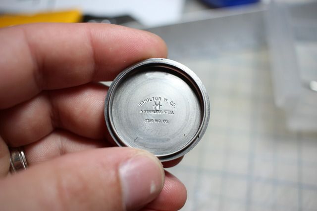

I am hoping to get some info on these Hamilton LED watches I picked up. Im not sure if they work or not since I haven't tested anything yet. I wasn't 100% sure on what kind of battery to throw in. Im hoping someone can tell me when these were produced, or at least if they are early or later 70s models. The two models visually look the same but there are some details that show they are different. First off a pic of the two in question, one is SS and the other is gold filled.
The first difference I noted was the way the bands are secured to the center lug. On the SS version the fixed bar at the end of the band slides into a small groove on the lug where on the gold version an extra piece sandwiches the bar onto the lug. (should have taken better pictures of that!)
Inside the case back of the gold watch it says "lancaster, PA" where the SS does not.
The movement in the gold watch is labeled as a Hamilton 913, SSIH-Quartz 506 F1.
The SS movement is labeled as a Hamilton 915
Any info that can be shared on these would be a great help, and also what batteries to try!

Great find and great info! On the inside of one of the battery compartments of the SS version I can see where it says FR2003 so according to the article it would be a later version. There is another article with a picture of a movement labeled 913 (same as gold) and the watch is from 1975. That would put the gold at approximately 1975 and the SS at approximately 1977 it seems. Any ideas why they would have removed "Lancaster, PA" from the case back in that time? The pic also shows how the batteries should be installed which is a bonus. I'll try to pick up some batteries and test tonight!

Threw in some batteries tonight, no worky :-( Any thoughts on where to go next?
