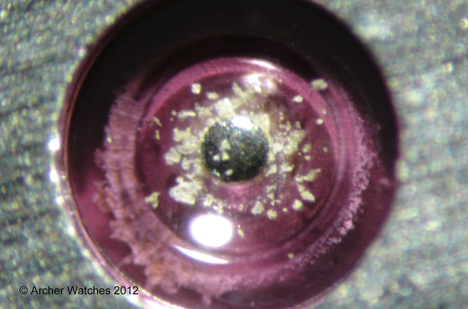

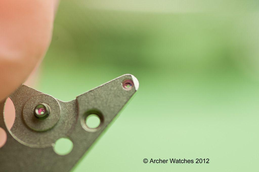

Balance jewel is completely dry:
Oils dried and crystalized:

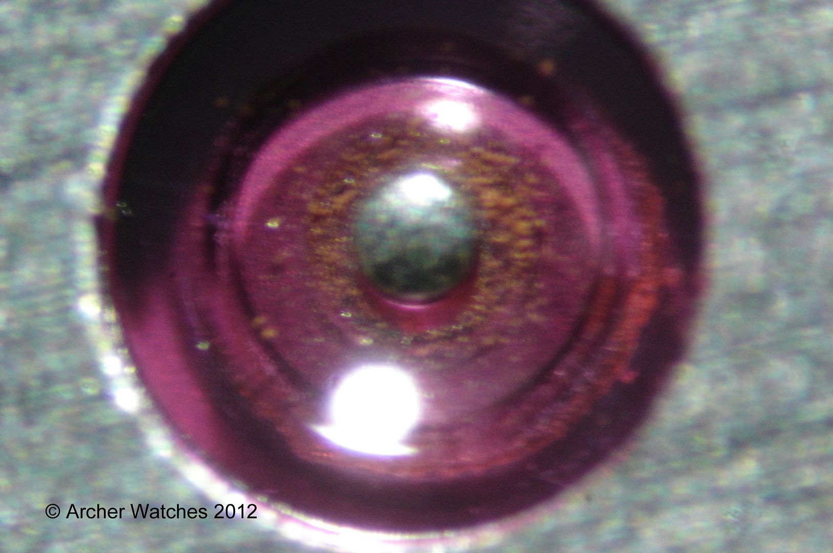

Here is another dry pivot – you can see products of wear in the jewel:

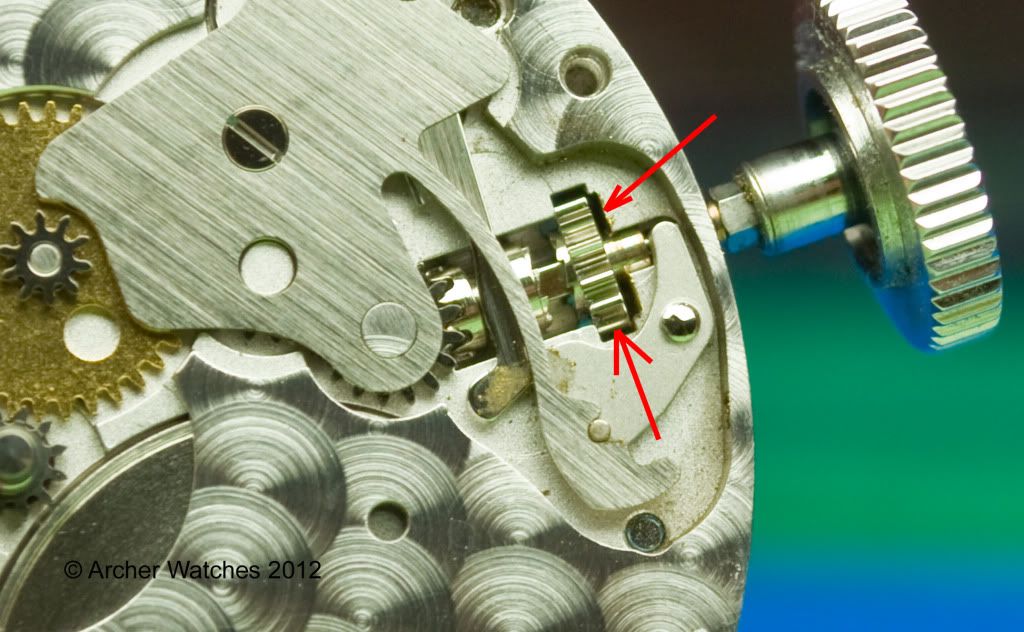

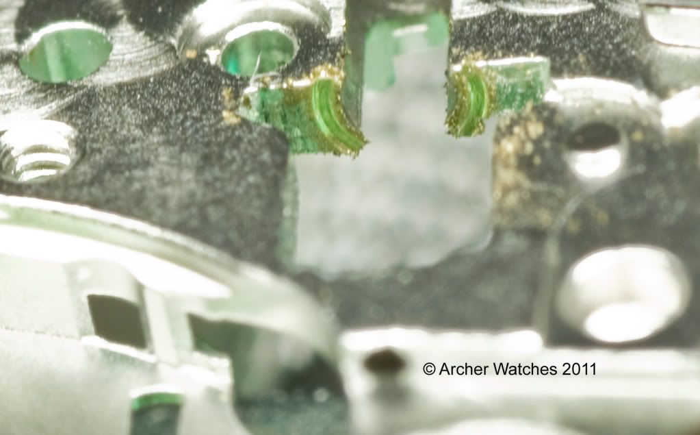

Panerai 005 with excessive wear on the main plate and barrel bridge from the winding pinion:
Debris through the movement:

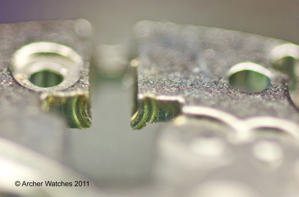

The main plate was also worn, requiring the whole plate to be replaced – not an insignificant expense:

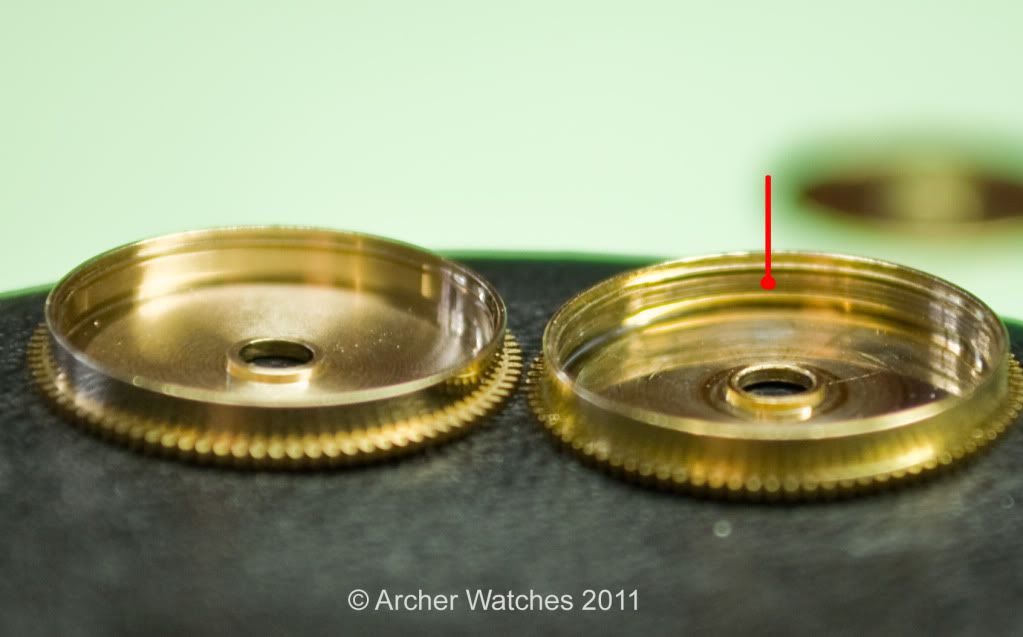

Wear in a Rolex Cal. 1575 barrel – deep groove worn on the inside wall of the barrel - worn barrel on the right, new barrel on the left:

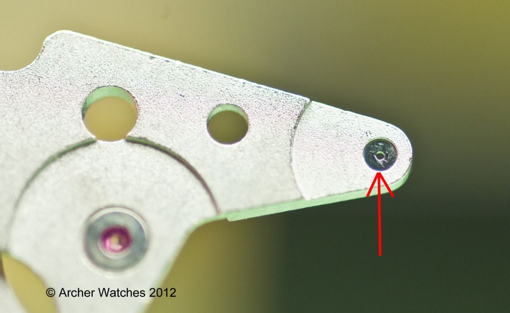

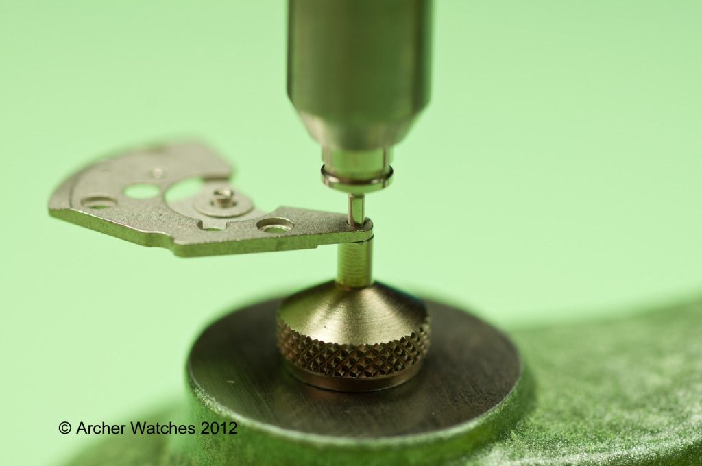

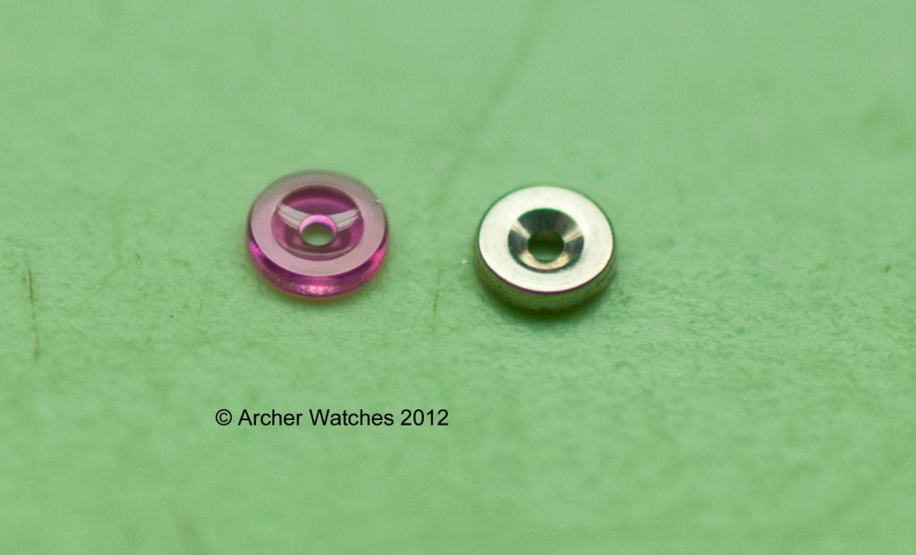

Worn bushing (hole was oval shaped) for the chronograph runner in a Tag chronograph (ETA 7750):
I replaced it with a jewel:
