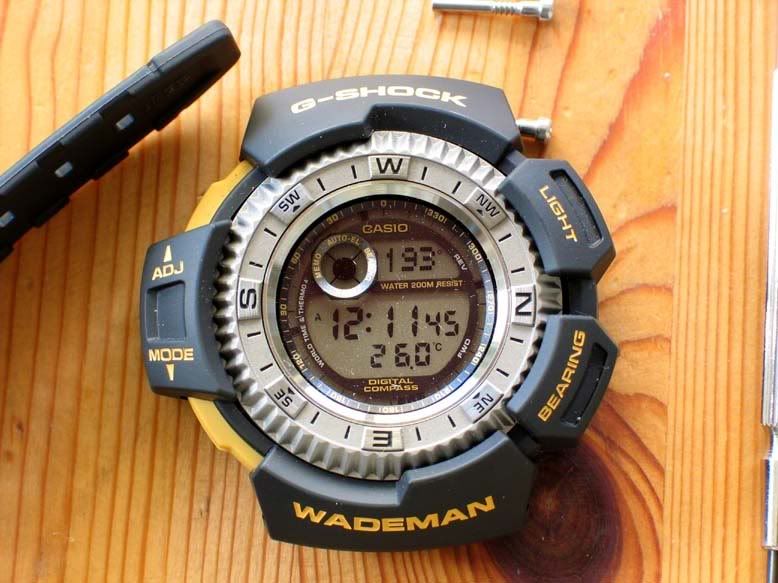

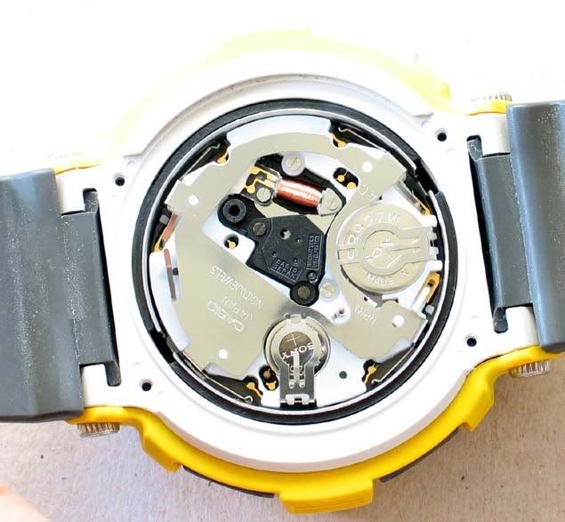

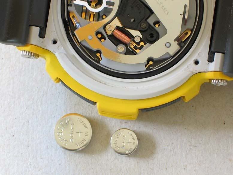

Wademan. This was one that brought some serious sweat on my forehead...
Try not to move the
modue in the case, but just only change the battery. Sensor modules are very sensitive and the
sensors can be easily destroyed.

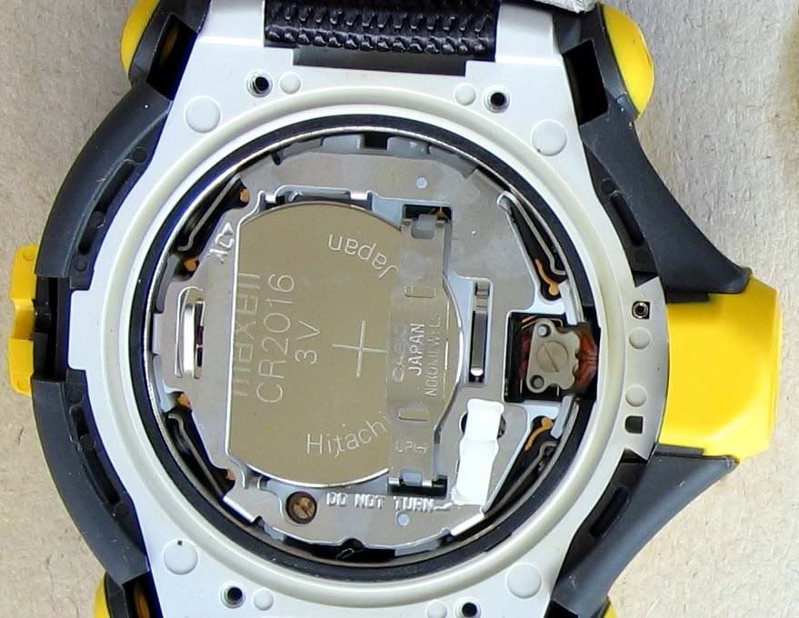

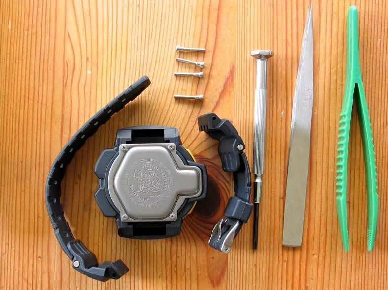

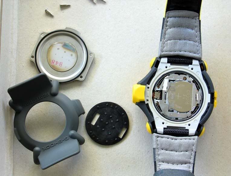

Riseman (MIY):
Remove the screws on the side (5) and the back protector comes easily off. The rest is actually as a
normal G-Shock. Try not to move the modue in the case, but just only change the battery. Sensor modules
are very sensitive and the sensors can be easily destroyed.

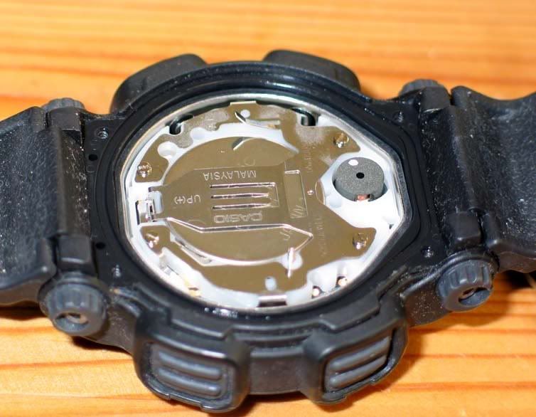

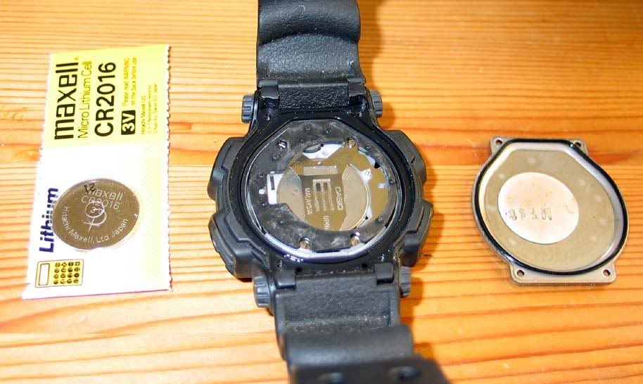

Mudman: Actually this is an oversized DW-6900. Battery change is not too difficult.

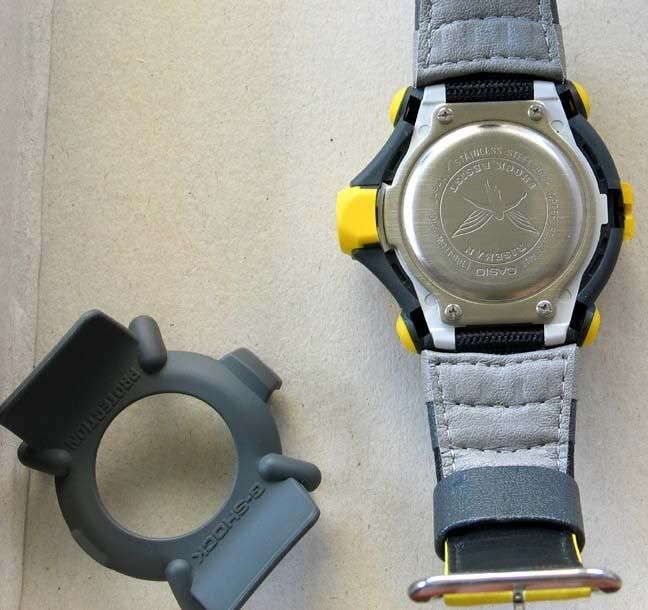

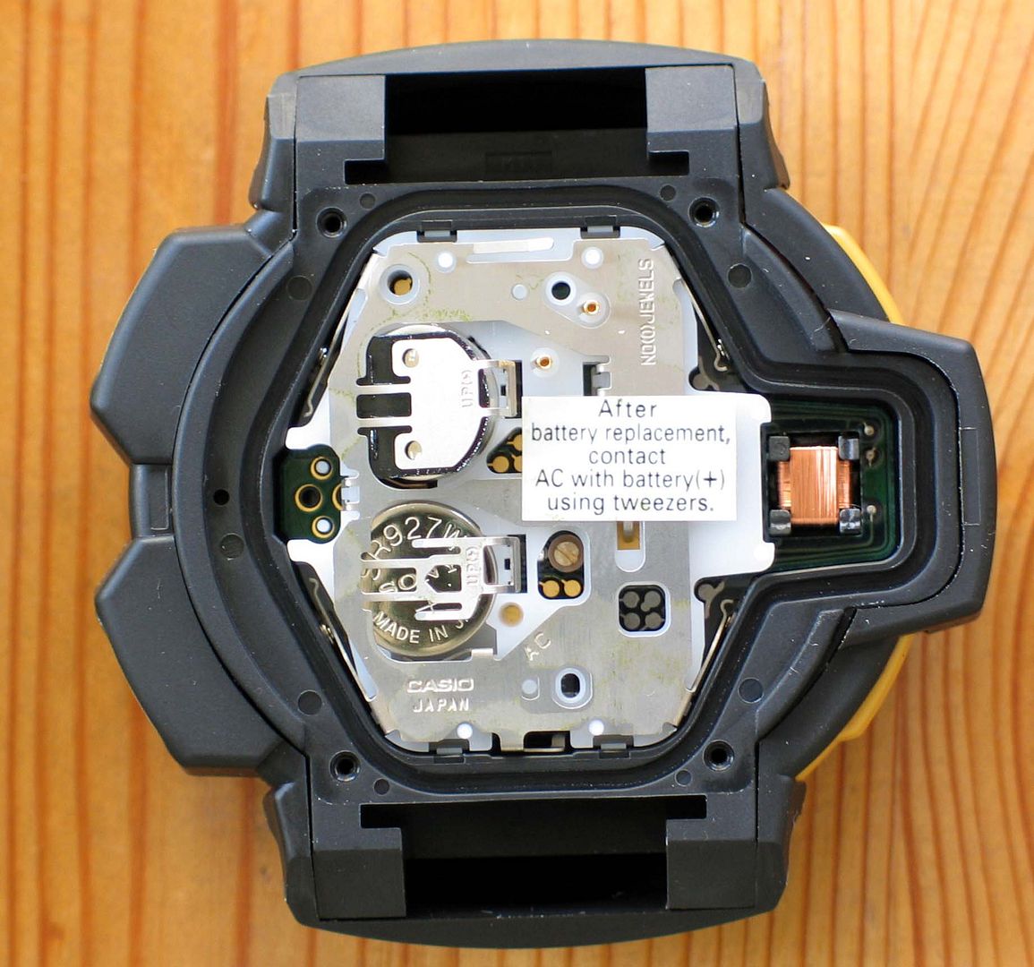

Here the pics of an opened Gaussman. Its an old abused one, but a new one should look similar inside;-):
When you remove the back you will find something like this. A back shock absorber plate. The other side is made of metal. Also you should see clearly the alarm spring.
A better view,
Now you can't overlook that spring I guess...

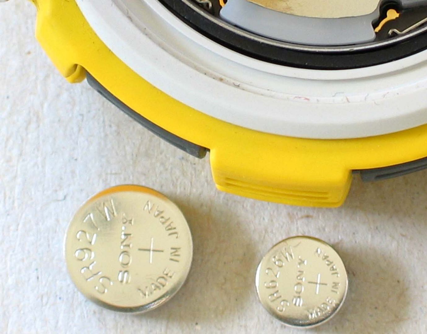

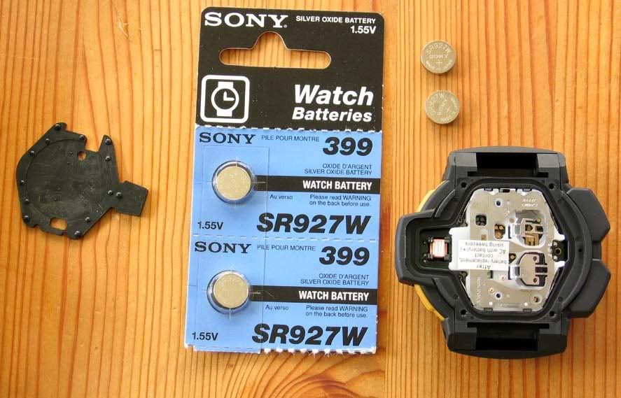

When the back plate is removed, you'll find this 2 battery module. They are pretty hard to get out of their battery holders when the lids are released:
The Batteries, SR626W and LR926 (a.k.a. SR927SW).
