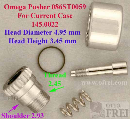

One of the basic things that needs to be done when a watch goes in for a significant service is to replace the pushers. Usually dirt will accumulate around the tube and eventually will work its way into the tube. This will disturb the operation of the pusher and over time compromise the tube gaskets. One style of pushers which is used on many Omegas is comprised of a tube that screws into the watch, a screw that fits through the tube from the inside of the case, a spring that is situated in the tube and the actual pusher. There are also one or more small o-rings inside the tube. Here is an example from Ofrei.com

Hi Chris,
When the pushers stick then you probably need to clean the tube/pusher to get all the gunk out or replace them. The O-ring is in the tube and you don't have to deal with it. In the picture above - the little ring that you see is actually a washer which I forgot to mention. It goes in between the tube and the case. The thread on the screw screws into the pusher button itself.
