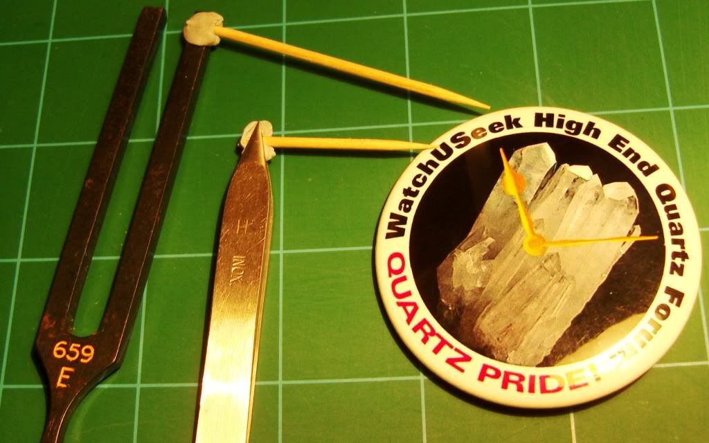

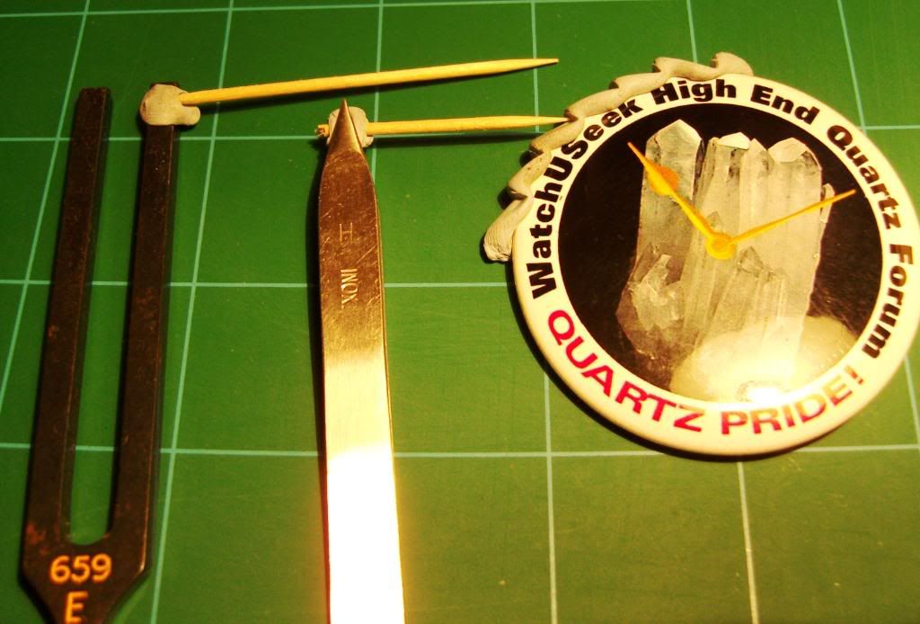

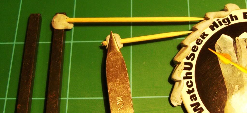

So, how is this trick accomplished? As usual, a nice picture will help. Using my post credit crunch budget of 17 pence (that's cents in the US or, if you are reading this in three months time, dollars :-!) I have produced this almost 'computer generated' image:
The tuning fork is a tuning fork, the tweezers are the static body of the watch and the finest, hand whittled, endangered hardwood toothpicks from the tropical island paradise of Edisto, represent sprung steel arms tipped with tiny ruby jewels that engage with the 300 carefully engineered teeth (yep, that's old bluetac) on the index wheel (a coveted HEQ forum badge)

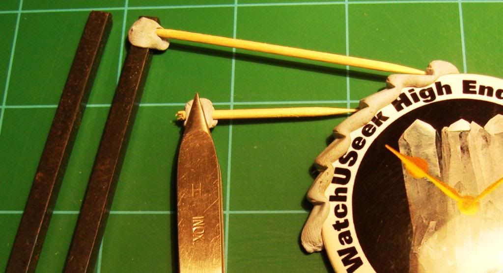

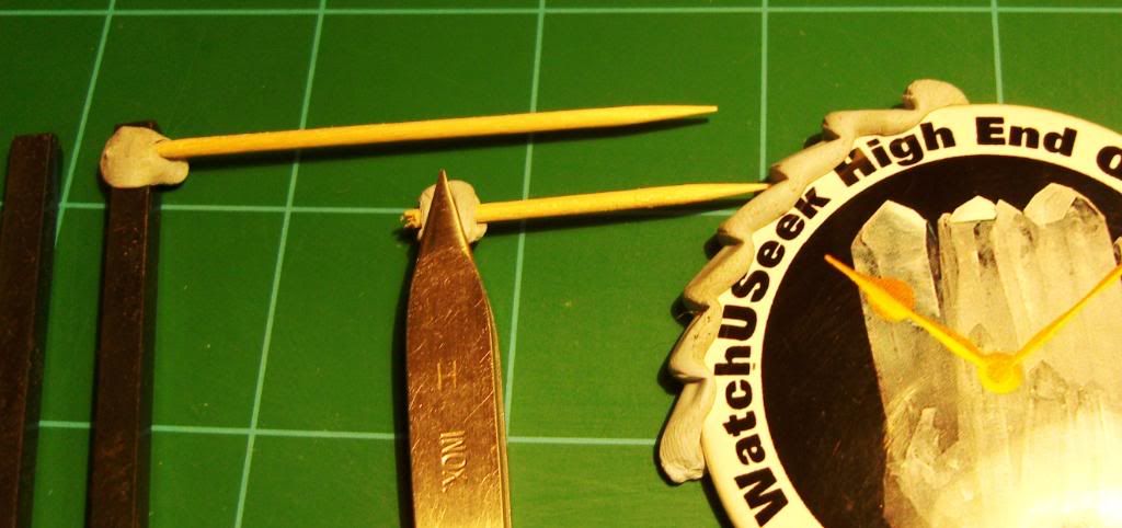

The crucial bit is that the pawl arm is attached to the tines of the tuning fork which moves while the index arm is attached to the body of the watch which is static. As the tuning fork vibrates right, the pawl arm, which is engaged in a tooth of the index wheel, pushes the tooth and thus the index wheel round by slightly more than one three hundredth of a revolution:

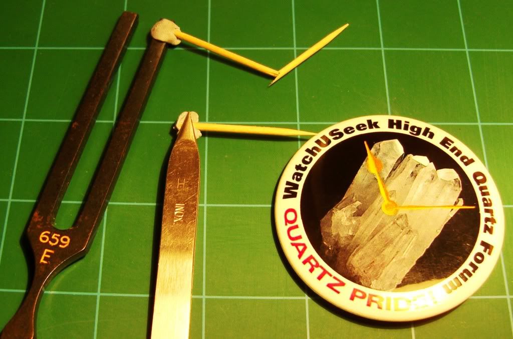

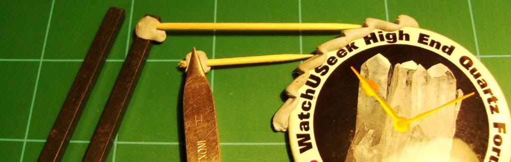

As this happens the jewelled end of the static index arm slips back on to the next tooth back. Thus,
when the tuning fork vibrates left the index arm holds the index wheel in position and stops it slipping backwards. Thus it is ready for the tuning fork to begin to move to the right again:
This movement continues back:
and forth:
In a way that gives a whole new meaning to the words 'watch pornography'. However, the crucial point is that each frenzied thrust of the pawl arm carries the index wheel round a further 300th of a turn while the index arm stops the index wheel from losing control and slipping backwards in the excitement. *Ahem* I really need to get out more.

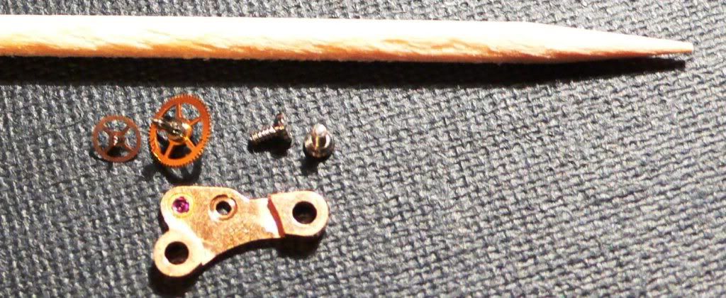

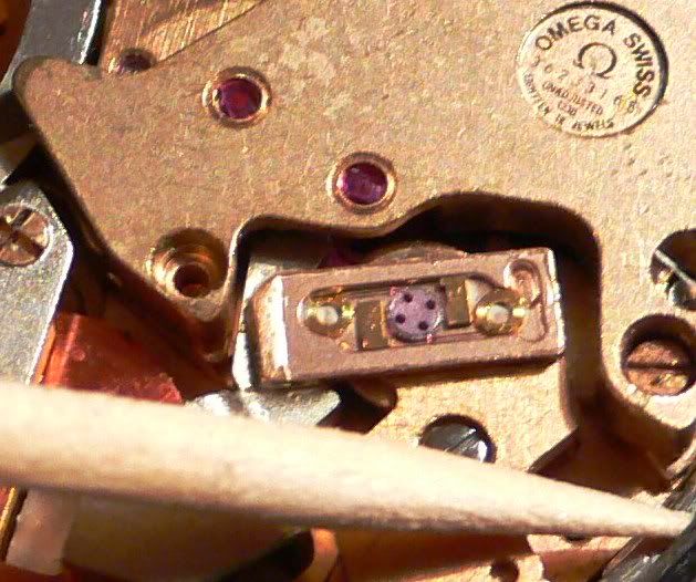

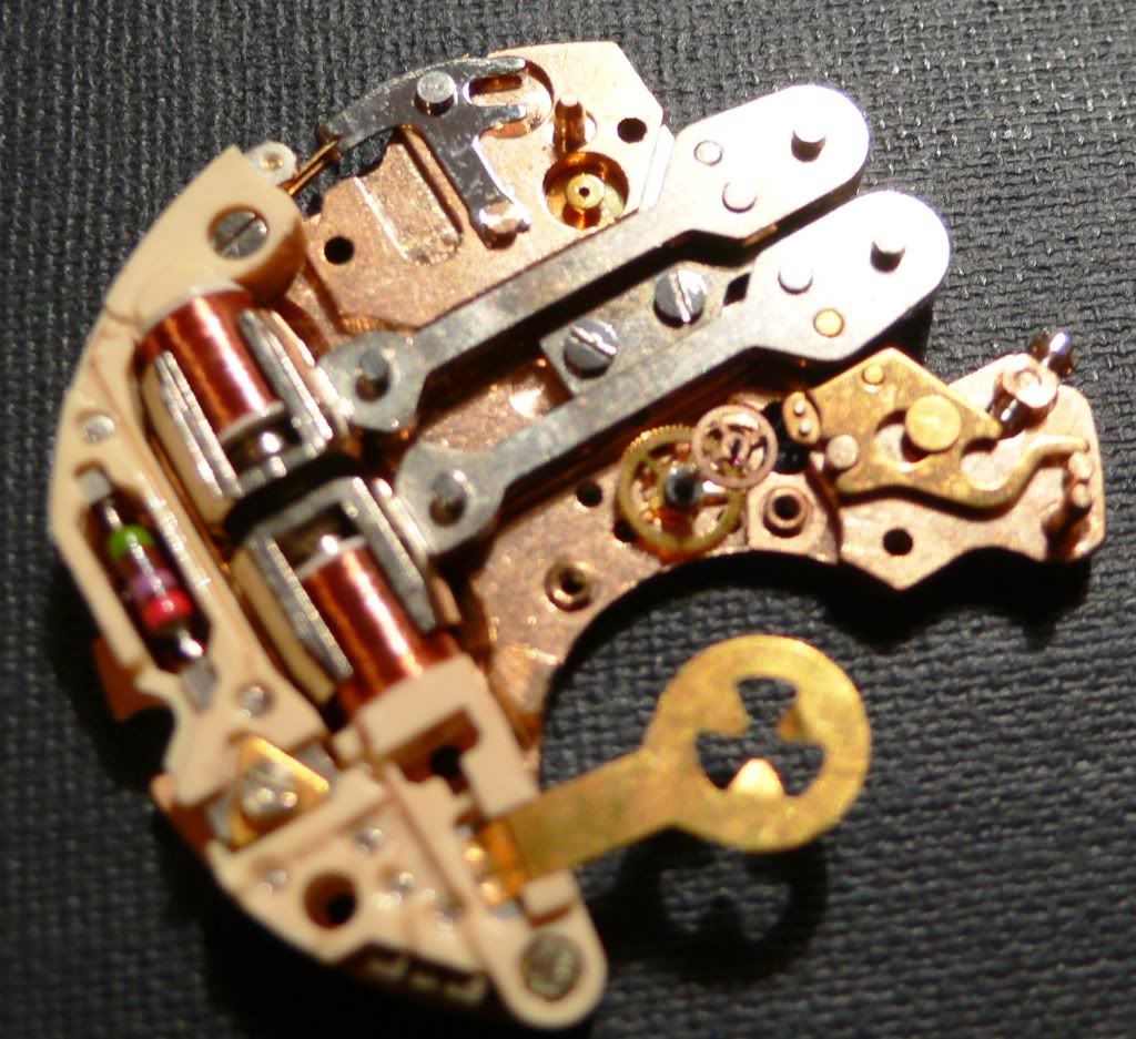

However, what is astonishing is the scale of the parts that accomplish this remarkable little feat of engineering. The smallest tuning fork powered ebauche available, the 23xx has a tuning fork that is just under a centimetre and a half long:
This one is missing the arms, but it gives you an idea of the quality and scale of the engineering going on here! Moving on to the ESA 9162 or, if you prefer, the Omega 1250, you can just see the two arms with the ruby tips.
Can't see them? The toothpick is for scale, but, starting near the tip of the pick move your eye right until you see the ruby jewel. at about four o'clock, just to the right and below the jewel, protruding on to the housing you can see the pawl arm, with the index arm just below it. Remember, the toothpick is for scale and the pawl arm is vibrating three hundred times a second!
next:
Again, the toothpick gives scale. This miniature bridge houses the index wheel. furthest left, yes, it has 300 miniature teeth cut into it.
(rumour has it this is done by highly trained, but underpaid, fleas)
Yes, it is about the same diameter as the toothpick. That is why you cannot get them made up any more. (the fleas died)
Finally:
Here are the two wheels in position. As I learned the hard way, you have to fully replace the bridge and then gently reset the indax and pawl arm into place from the other side, through a hole about the size of two toothpicks.
If you try to do so before the bridge is in place, well the arms are made of very very high quality spring steel and the index wheel is very very light. (and you cannot use a magent to find it as that magnetises it and that cause some very odd behaviour once in the watch again.) These mechanisms are excitingly easy to break!

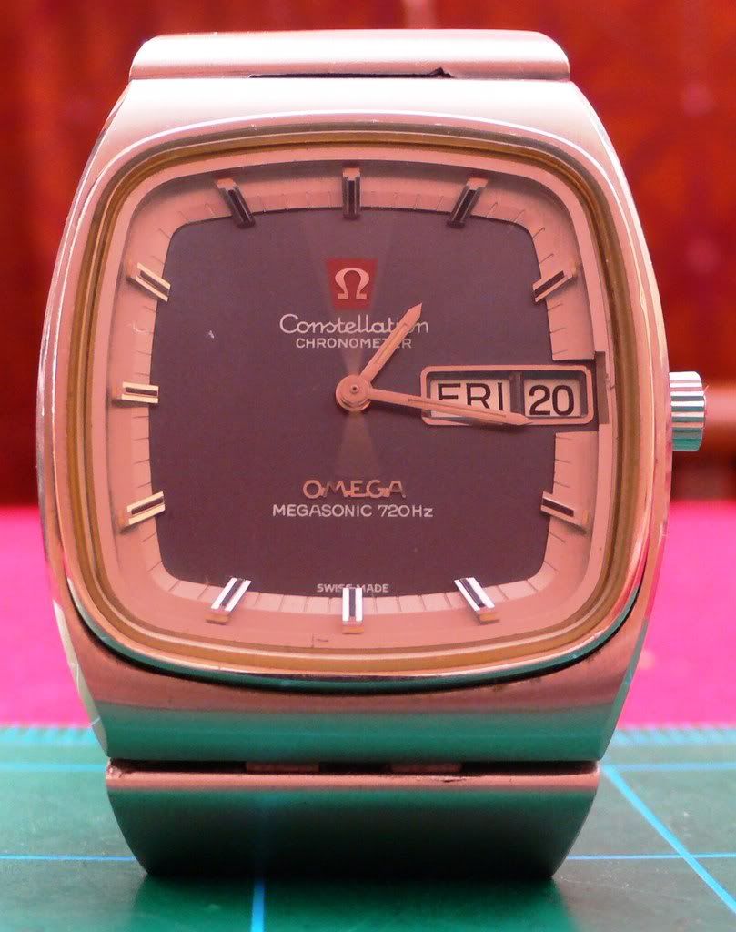

Now, Seiko would have you believe that the Springdrive is utterly smooth, but this isn't true. While it is true that the Springdrive's hand never actually physically stops, it isn't very smooth. This is due to the digital control circuitry, which samples and breaks the glide wheel only a few times a second. the upshot of this is that the second hand of the SD is constantly accelerating and decelerating. Once again, the eye tricks us as it is brilliant at spotting movement but rubbish at spotting acceleration and deceleration, especially at that scale.
The Megasonic, on the other hand, 'ticks' 720 times a second. First, this is ridiculously smooth in its own right. Secondly the first few gears are not mechanical but magnetic. As a result, the pulses are smoothed asymptotically and, to all intents and purposes, cease to exist. Thus, the award for smoothest second hand of all time, goes to the Omega Megasonic:

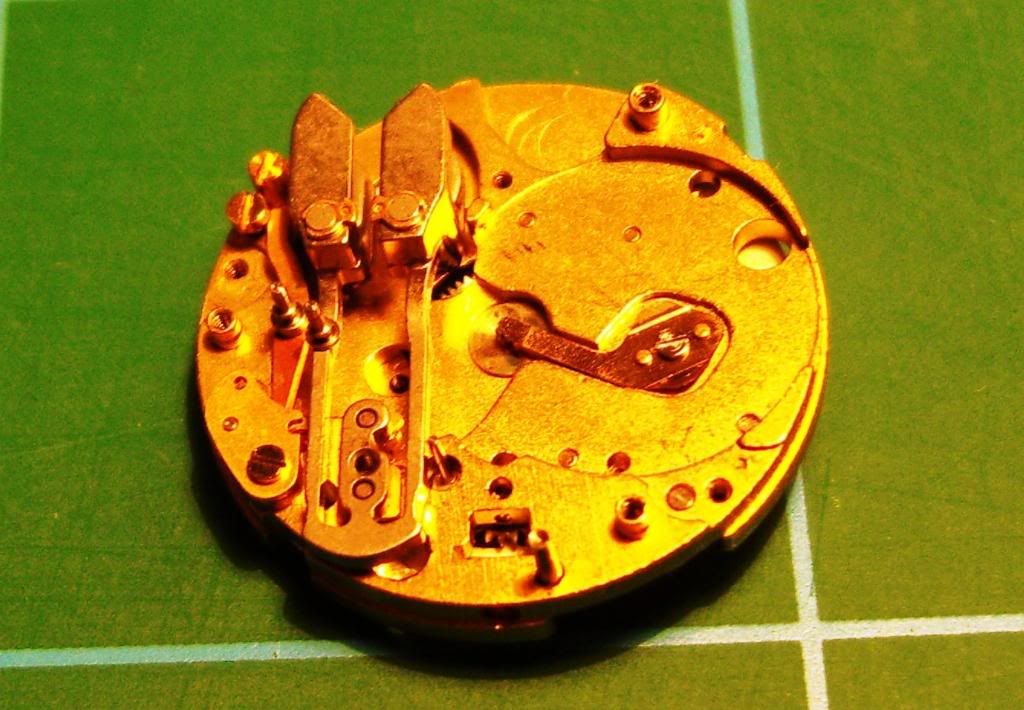

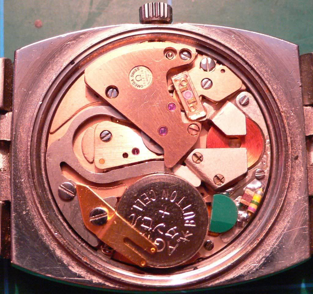

Oh? you want me to open it so you can see the back too? I spoil you!
See that little box with a wheel in it at about 1:30? that's the 'souris' or 'mouse' and is the only other technique for converting vibration into rotation. it is completely sealed, and as this earlier picture shows:
it's about the size of a section of toothpick. It is also mounted directly upon the tuning fork itself, hence the magnetic gearing! God knows how they made it but they don't make it any more!

In the case of this movement there are two arms which simultaneously perform the act of pawl and register arm allowing the movement to work while having no fixed index point. Here's a video that demonstrates how this works so well that I really don't feel the need to explain further.
