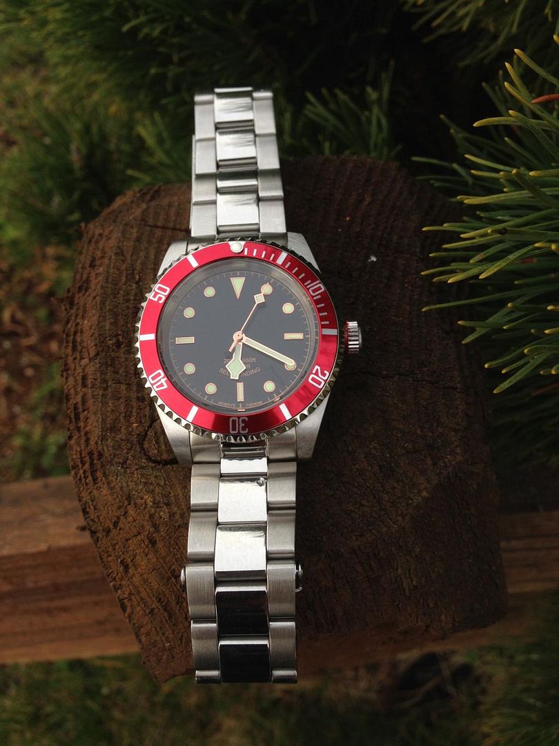

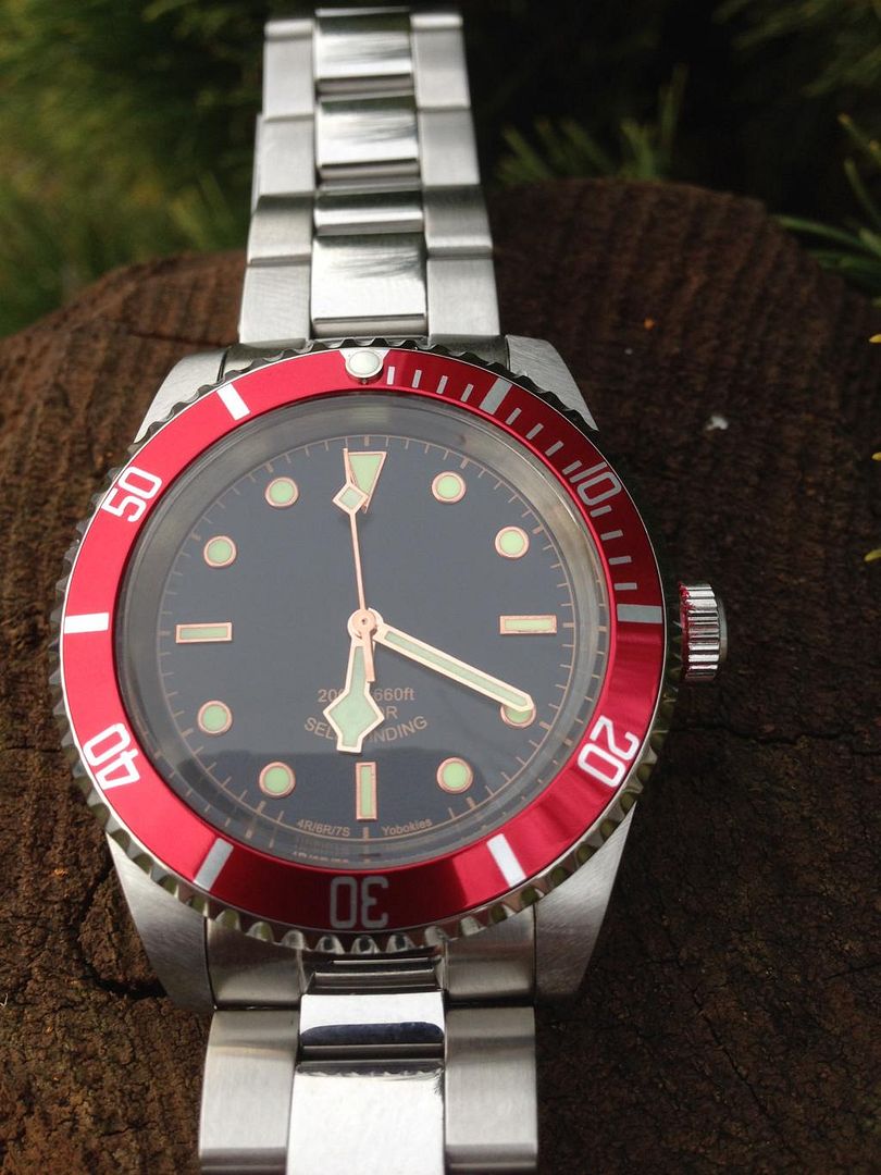

Hi all, new member here, just began modding my 8926 a little while back. Read this entire thread - what an inspiration!
First mods were the usual brushing of the bracelent, cyclops removal and removal of the invicta logo on the side of the case; But then I decided to dwelve deeper and see if I could make a ceramic bezel from a Parnis fit. While at it, I painted the triangle red on it, too.
It requires a lot of work to the bezel and to the insert itself to make it fit and sit low enough since it's larger in diameter and much thicker than the stock stainless steel insert - I used a dremel and a bench grinder for most of it. Mine still doesn't sit as low as I would ideally like it to, and I managed to nick the edge of the insert in a couple places and put a crack right through the center of the triangle, but I'm very happy with it for the time being! The parnis insert is not top quality as can be seen in the close up pics but I love how reflective it is, how much it resists scratching and how it gets a greyed look to it in some lighting.
Next mods planned are the new Seventies dial from Dagaz and a mercedes style red seconds hand to finish off the look, replacing the insert with another undamaged one, and replacing the crystal with a saphire one since mine already has a scratch on it right at 12:00. I'll only get to do all of it in April, but I'll be sure to post the final result!
Changed to a squeezed 22mm Alpha strap on 20mm lugs after trying a black Perlon
