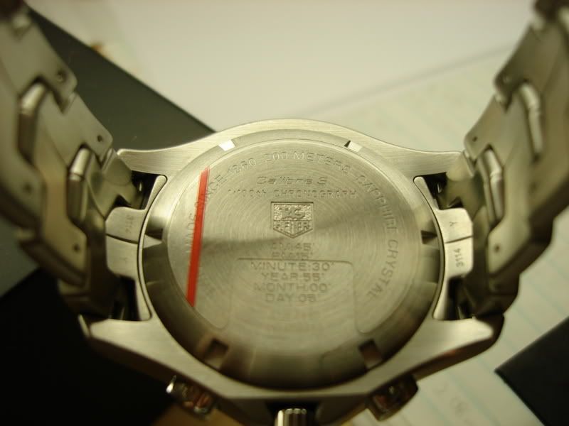

im happy with it .. paid 2500usd out the door for the past few day it didnt lose 1 sec with time.gov
but when in chronograph at the 0:0:00 position the minute hand is little off is in between 59min and 60min ... not sure if is some kind of problem .
anyways here is some pics

those numbers in the back is for when setting the time, month, year, day
when the second hand is on the 30min mark it mean it will change the minute
when the second hand is at the 55min location it will change the year and so on. its to show what you are changing.
as the crown is not used to change time or date but the A button is the one taht changes everything and button B is to change from hour, minute, year, month, day
it is a little confusing but the manual is very clear about
anyways any thoughts on the minute hand being off when chronograph at 00:00:00 position ??

This has been brought up before by a couple other owners. I'm not sure if this is how it suppose to be or not. With several being like this, it may be part of the design.

You can reset the alignment of all hands, by pressing top and bottom buttons together, it stated in the manual.
