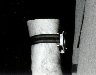

Nylon watch straps for sport watches were quite popular in the 1950s and 1960s, and were available in a variety of colors and patterns. Many were available in striped patterns attributed to club, school, and regimental (military unit) stripes. A notable example of this was the band on which Sean Connery (as gentleman spy James Bond) wore Albert Broccoli’s Rolex Submariner in Goldfinger (1964) and Thunderball (1966). The band was shown in close-up during the Goldfinger pre-title sequence, in which Bond set a delayed detonator, and then surreptitiously checked the explosion time as he entered a nearby cantina.
The bands of that time, particularly Connery’s band, were single strap bands with a fabric “keeper” to secure the loose end (called “the point”), made of the same band’s fabric. (Most watch straps have two smaller keepers, one just behind the buckle, another floating keeper to be positioned over the point of the strap.)
Production pics of Sir Sean Connery wearing the Rolex 6538(A) on nylon strap, Goldfinger and Thunderball.

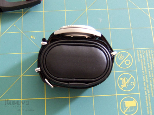

Before modifying the nylon band at all, check that your watch can be worn on one. Conventional spring bars (for attaching bracelets and bands) will suffice, but they are usually 1.2mm in diameter, and not necessarily designed for a band reeving through them, and pulling on them dynamically while worn. Bars with “shoulders” flanges (which aid in removal) on one or both ends can be caught by the band and come out of the lug holes, or (depending on your watch’s lug holes) the spring bar pivot (pin) can move about in the mounting holes and widen them. Of particular importance is that the spring bar pivot is a correct size for your lug holes; if you’re unsure, ask a jeweler or watchsmith to double-check for you.
Solution: get spring bars meant for use with NATO straps, and see if there is even room to fit your nylon strap in the gap. I recommend getting 2.5mm bars (“fat boy” bars) which don’t succumb to some of these problems, or – if you have lug holes drilled all the way through like classic Rolex watches -- Marathon style bars with no shoulder and long pivot pins. Both of these styles can hold the strap more securely against the watch case. Note: if it’s a tight, but feasible fit, you should put the band on first and then fit the bars in place. Avoid pulling the band through tight bars repeatedly, it will weaken and enlarge the buckle holes (trust me on this), and can fray the strap edges rubbing against the lugs.

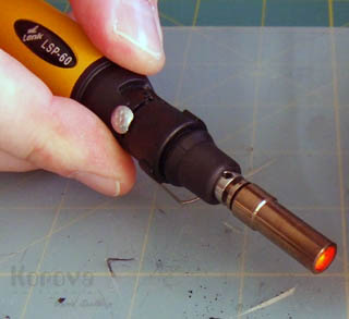

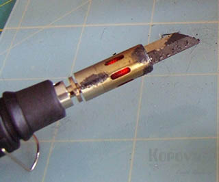

For several of the following steps, a hot pen knife blade heated over a flame can be used. A problem with this is that the blade cools quickly, so maintaining consistent heat is difficult while working with the nylon band. For a neater, professional look, I suggest using an X-Acto blade or similar hobby knife for cutting, and a butane powered soldering iron with heat gun and hot blade attachments for attaching and sealing the nylon. The hot blade maintains a consistent temperature and enables more precise work. The heat gun attachment should give you a very precise “hot area” to work with, and again you can control the temperature more precisely.

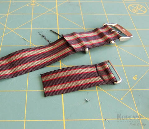

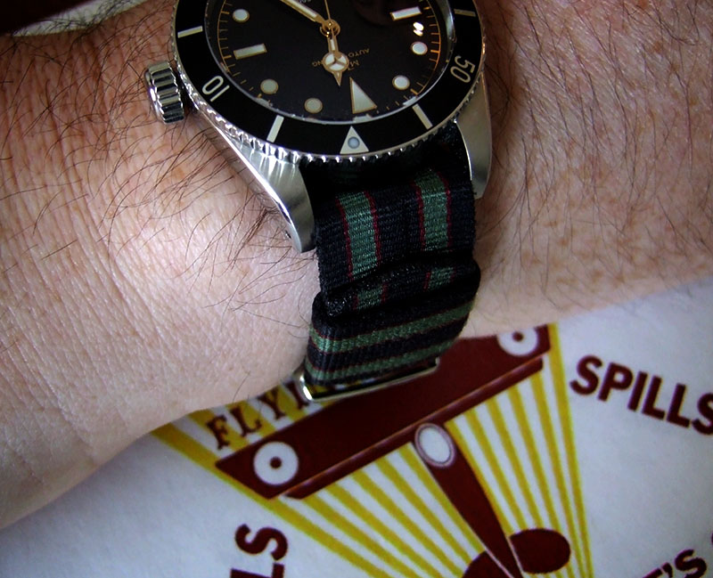

Take your NATO band in hand and measure your shorter, keeper strap. It should probably be long enough to wrap around the band as a keeper with some overlap, but just to be sure.... Having verified this, take your blade and cut off the shorter strap leaving a little bit of a nub on the main strap. You can cauterize the remaining nub with the hot blade, or a micro heat gun attachment. You may want to put this step off until you’ve sealed your fabric keeper, and trimmed and sealed the end of the band, so that you’ll be more practiced in this. One slip with a hot blade, or sloppy work with the heat gun attachment, can destroy your main strap. You’d have to start from scratch (up side is that the ruined band could yield one additional fabric keeper). Maybe you should get 2-3 straps of a particular design so you have extras in case you screw up.

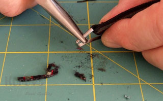

Using small pliers, you can bend the metal keeper out of the small loop, or simply snip it with wire cutters, taking care not to cut the fabric. Now you’ll see that you have a length of the band with a thicker end where the fabric is folded over and sealed for the keeper. I use this as the top layer of my keeper’s attachment point, as there is extra fabric to melt and join the fabric with. If you’re using a butane-powered hot blade, start warming it up now.

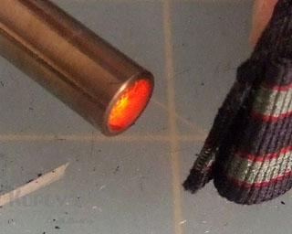

Cauterize (seal) the frayed end of your future keeper where you cut it off. Best way I know to do this is with a micro heat gun attachment, just melting the nylon enough to melt it into a solid seam. Don’t fall in for “the bigger the glob, the better the job.”

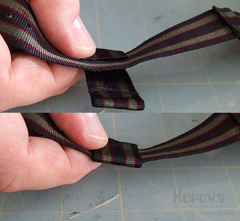

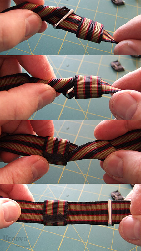

Wrap the short strap around your main strap. I suggest you double over your strap to measure where to join the keeper when there’s two layers of strap through it. I find this is optional, though; the fabric keeper will become a little looser as you wear it, because it will flatten out a little.
You should have enough fabric to allow the underneath layer to reach across the band. Put a large paper clip on this side; it should hold both the underneath layer, and the overlap which you’ll melt onto the underneath layer. Slide the keeper carefully off your strap, and arrange it and your hot blade onto a heat-resistant pad (a glue gun pad, or a wooden cutting board). Put the main watchband safely away to the side – you don’t want to set the heat blade on your main strap accidentally!

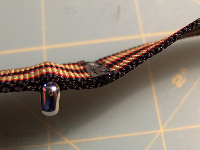

Using the hot blade, gently “butter” the overlapping layer’s end onto the fabric underneath. Work on only one side at a time – the base of the blade can get in the way if you work over to the far side. Be patient, and use a very light touch; pressing down too hard will cut through the fabric. As you perform this, the adjoining fabric should warm up and fuse to the melted nylon you’re “spreading.” You should end up with a melted slope of fabric from one section to the other.
After the keeper has cooled, you may find the melted seam is a bit rough to the touch. Using modeler’s fine sandpaper (available in hobby shops) or a fine-grained emory board, you can gently smooth down the melted nylon. Less is more here, so you don’t sand away your join completely.
Once the seam has cooled slide it onto your band. Try sliding the point of the band through it … it may be a tight fit. Don’t worry, that’s good! Remember, as you wear it the keeper will flatten out and sliding the point through will become easier. For this first time, hold the point close to the tip with two fingers of one hand, and secure the keeper with two fingers of the other. When you slide the point in, it may try to bend up, but if you’re holding it close enough, the only way for it to go is “through.” Another way is to hold the point stationary and gently work the keeper up and over it. This takes practice on the wrist; patience pays off.
A trick I have at this point is to soak the band (with the point circled around and fed through the keeper) in tepid water, press dry in a towel, and let it air dry overnight. This will help set the keeper into its new shape.
Take off both metal keepers? Decisions, decisions....
While you’re letting your fine new fabric keeper cool off, think about the two remaining metal keepers on the main strap. Do you take them both off and go totally “buckle ‘n fabric keeper?” You’ve got some considerations to think over.
If you want to leave your strap long, you can take off the second keeper away from the buckle. Your fabric keeper will do this keeper’s job, and better because it will slide over the end of your strap – you no longer need to turn the band back on itself and be tucked in.
The first (fixed) keeper is another matter. Its job is to keep the band flat near the buckle, otherwise the strap could come unfastened from the tongue of the buckle. If you remove it, and have a long band trimmed by a fabric keeper two inches away, you risk your strap coming off. Bad idea if you’re engaged in diving or sports. If you trim your strap pretty short so that your fabric keeper is close to the buckle, then you can take this first keeper off. I like this look, it keeps the buckle and the keeper together on the underside of my wrist. But do this only if your fabric keeper is quite snug on the strap, so that it doesn’t slide away from the buckle, and you trim your strap to your wrist size with minimal expansion length.
The result can be very neat, but as this is a DIY project, follow our own tastes.

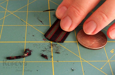

The point can be cut and “sealed” to a shallow, or rounder, shape to preference. I find using a US half-dollar (Kennedy) piece gives a nice shape for a shallow cut; that coin’s diameter is 1.2” (30.6mm). A rounder shape can be achieved using a smaller US five-cent (Jefferson) piece, 0.83” (21.2mm). The smaller, rounder cut might be more authentic, but is less practical for bands that are doubled over through a keeper.
Using one coin as a mask you can cut the end with a tailor’s razor blade or X-Acto hobby knife. To center the coin, find two markings along the circumference that, bisected, cut through the center. Line this centerline up on the strap’s holes, or the center of a striped pattern. When measuring where to cut, leave 2-3mm where you’ll cauterize the end. You may wish to leave more if you haven’t done this often. You can also use a hot blade directly, which gives a clean, melted cut. Matter of preference, really. You can always clean up rough cuts with a mini heat gun or cigarette lighter. For the smaller coin’s shape, I found that making at least five straight cuts at various angles closely matched the curve. (If you’re experienced with using a compass cutter, you may wish to use this, with the cutter’s pivot point centered in one of the bands holes.)
