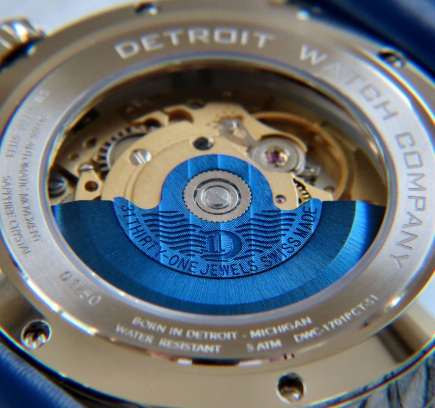

To me ... for my money, none of the ubiquitous movements have any real eye appeal for a glassback and that includes the 2824 ... with the possible exception of the 2893 which at least has a fair amount of standard factory decoration. Any auto can be dressed up with a decorated rotor. Some makers do it but I have even had 8215 and low end Seiko rotors painted just for interest. I am sure you could apply any graphics to a rotor you wanted with a little patience and a printer. I have actually had a 9015 rotor hand engraved to match the rest of the watch. Anyway, enough on aesthetics - beauty is in the eye of the beholder and there are quite a few threads on here debating the virtues of a see-through back versus a watch without one, usually in favor of a nice factory engraved caseback.
Bottom line is that there is no reason to steer clear of an 8215 driven watch if you can overlook the stutter, which really seems to bother some people. I had sold all of my 8215's but have recently acquired another one. It is a fun, quirky, accurate movement that can be replaced for about 35 bucks compared to about 95 for the 9015 and maybe 175 for the 2824 .... but prices can very pretty widely on the ETA and you have to know what you are buying, mostly because they have been around so long and have been modified heavily both by ETA and watch manufacturers.
Some painted rotor watches long ago sold now ...
8215:
Seiko 7S26
Engraved 9015
Manufacturer decorated 2824 ... one of my favorites actually ...
