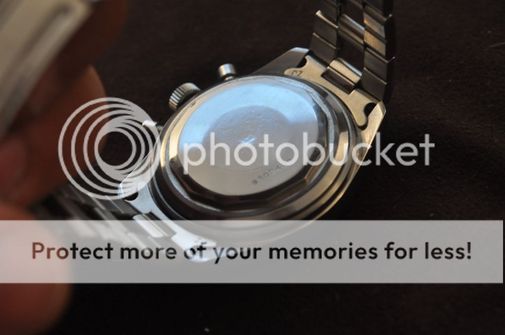

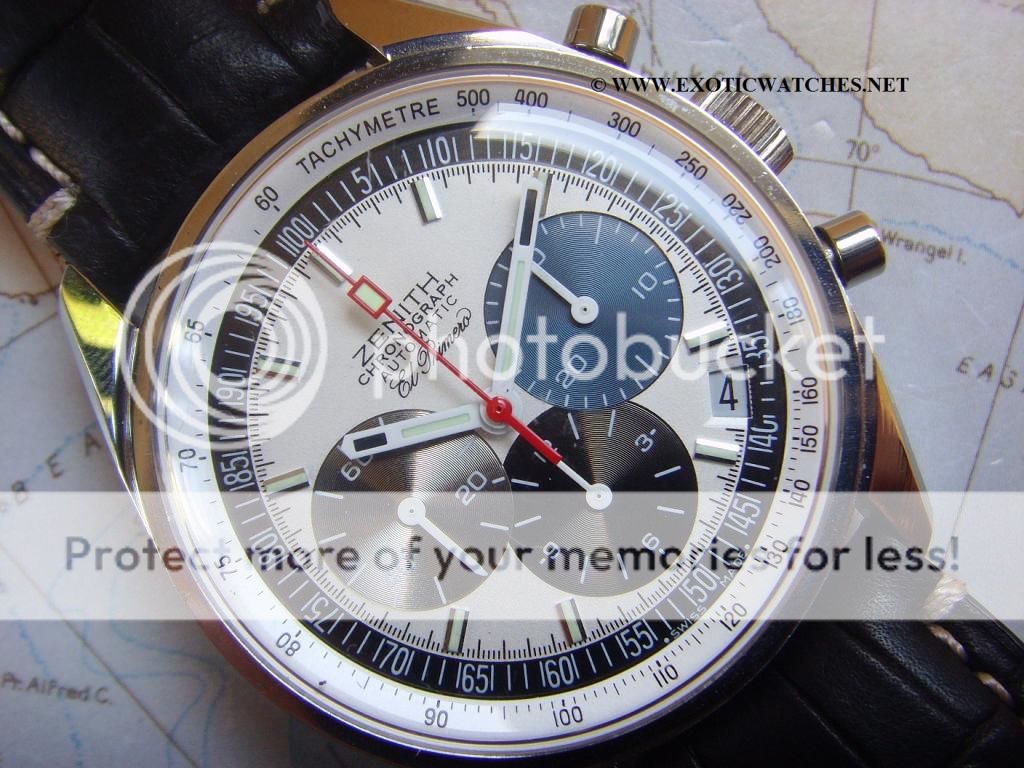

930D4x0:
Modern service dial
Note that the caseback is not completely flat; there is a central area that is different from the rest, as if the four-point star has been polished out

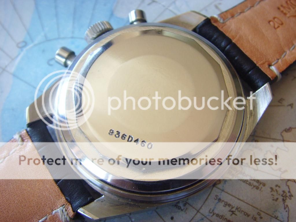

936D460
Modern service dial
That funny looking caseback again with the odd central area, and now with usually deep numbers
Inside, a Type B pattern, whereas the 4[SUP]th[/SUP] and 5[SUP]th[/SUP] series bracketing this caseback number have Type C casebacks

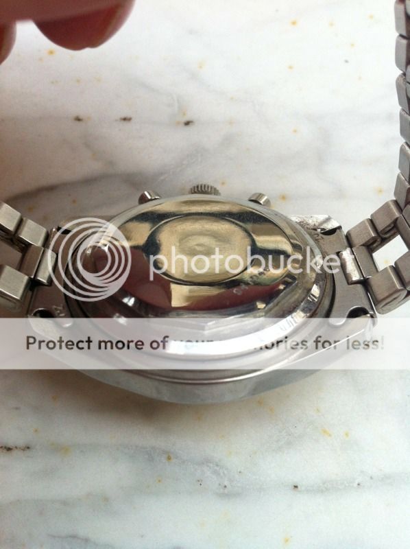

941D460
Modern service dial
Caseback with polished out star again

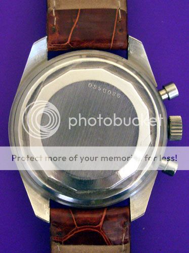

980D460
Modern service dial
This time the caseback looks good (perfectly flat)…

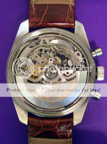

..but at least the rotor is not correct, and I'd be curious if that movement is a 400 or a 3019, but the seller obscured that bit of info

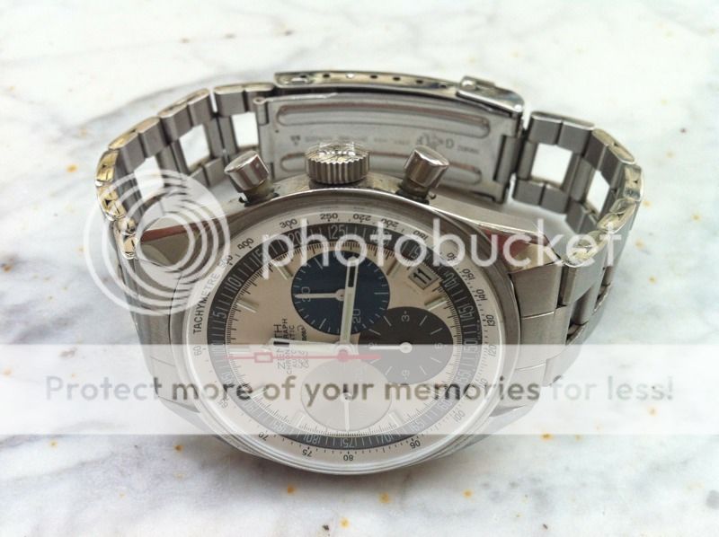

Hello LouS, hello everyone,
first sorry for my english mistakes, as english is not my native language.
I would like to complete this very well documented post with some new "D460" models informations that I found.

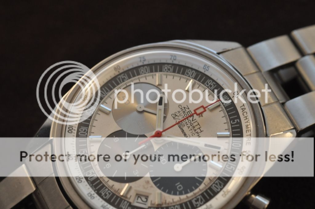

1. from a watch that I bought :
937D460
I have to say that I knew this post before buying it, and that the seller was perfectly explicit on the service dial and crown. We agreed on a price which seemed fair for me, much lower than what he first expected, due to these non original parts.
For me it was an opportunity to find an A386 very close from how it was 40 years ago out of the manufacture : perfect condition and NOS Gay Freres bracelet.
I'm really happy with this watch which is my second Zenith one.
There is on the picture of the inside caseback an interesting written indication : 21/28.
2. from a watch sold a few days ago on Chrono24 from a seller in the Netherland.
The end of the serial number was hidden, but we can be sure that it's ending with 460 :
987DXXX
It was proposed for a price higher than usual price for original dials models in average condition.
photos credits by Cars & Watches.

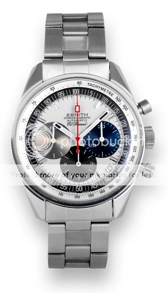

first from Drouot, a french auction company :
Ventes aux enchères ZENITH (Chronographe El Primero / première Génération réf. A 386), vers 1969

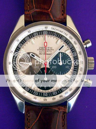

http://img130.imageshack.us/img130/5159/zenithpn012.jpg
second one from a french second hand (sold since a long time), who bought it at http://www.cavenezze.it/who seemed to have several ones when the guy bought it.
Chronomania - Zenith A386 : pourquoi n'ai-je pas craqu plus tt ?
Coin des Affaires - Zenith El Primero A386
My thoughts and remarks about these 10 watches with service dials (2 without known SN) :
8 of the 10 have a NOS Gay Freres bracelet.
I really think that these service dials were mounted by Zenith or somebody who had an easy access to Zenith service parts :
- original Gay Freres bracelets
- the dials of course (the ones from the New Vintage 1969)
- the hands
- original or service crowns (as both are present on the watches)
- the cases : they all present the same finish which is quite different from the original factory ones, polished steel. So who knows if they come from Zenith ?
About the movements, we have some of the watches who don't have original parts, mine with its disc day dial, or the 980D460 with a later period rotor.

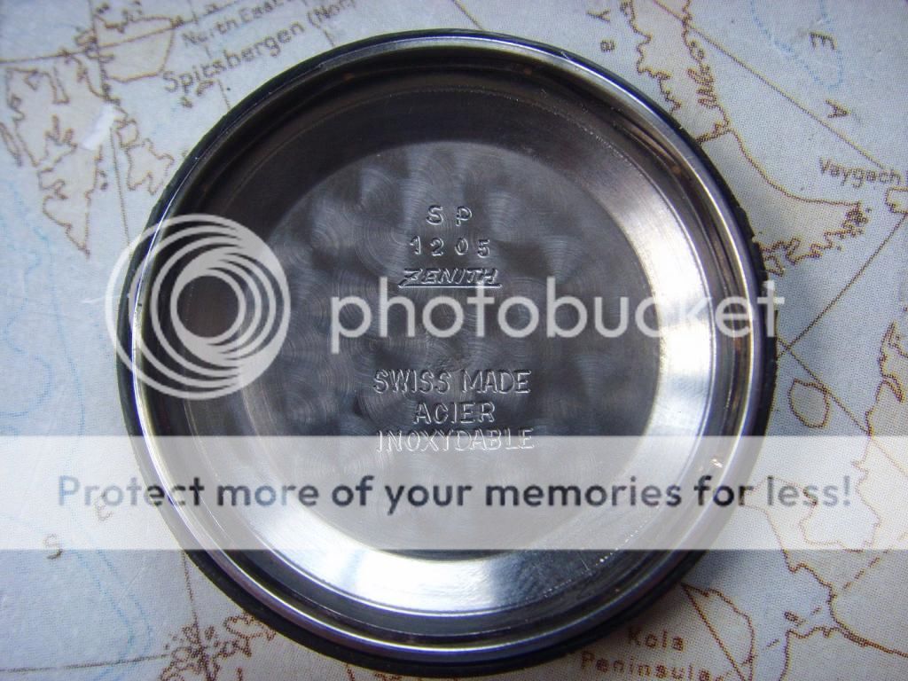

For the case backs, it's very strange to have those traces of nato star outisde but the inside corresponding to the flat cases implementation of the spiller indications (no nato star).
The dials & the tachymetre rings are often mis-aligned in the same direction (look at the 60vs100 at the top of the dial).

About the cases, they never have the brushed steel from original cases, but they have very small circular lines on the lugs that you can see on this picture of the 930D460 (down right lug) :
and on the back that's more clear, here on the 936D460 :
My watch (937D460) shows the same lines both on front and back.
I see two possibilities for these cases :
- they are service cases which didn't receive the "finish" by Zenith.
- they are forgeries.
