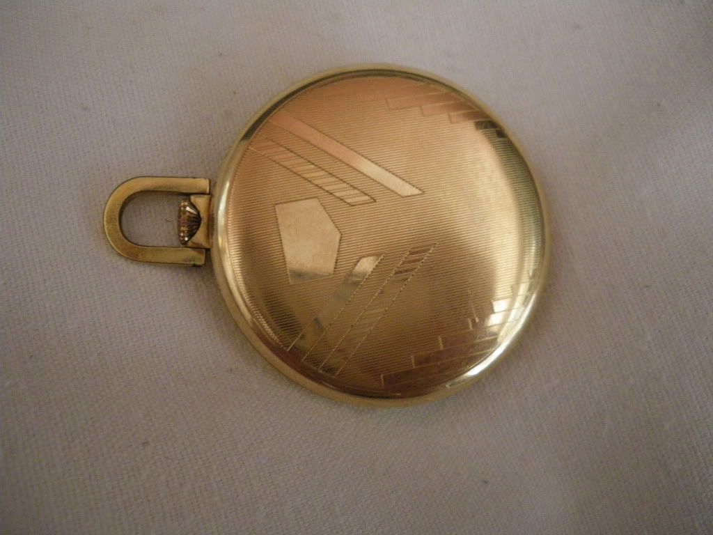

Hi guys, recently i found this golden watch belonged to my grand grand father or grand grand grand father, anyway I have no experience it this matter and I am searching for more info about origin and some kind of evaluation. I searched the internet but didn't found a watch similar to
this one. Any help is appriciated.

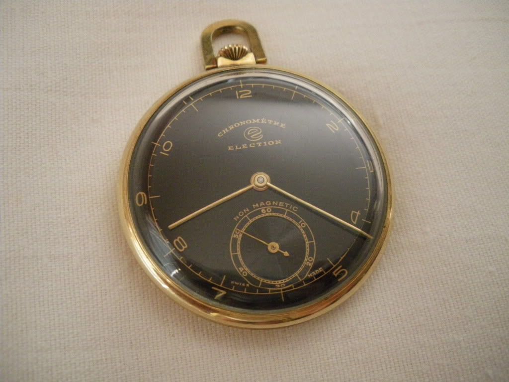

2,024 Posts
It looks like a pretty modern production pocket-watch. If I recall, non-magnetic watches didn't come in until the 1940s or something. My guess would be (and this is a guess and nothing else) that it's from the 50s at the earliest.
If you can get the caseback off (and I think this one just unscrews) and photograph the movement and the inside of the caseback, we may be able to tell you if the watch is solid gold or gold-filled and what quality of movement it has.
We don't give any evaluations here, sorry. It's not easy to evaluate watches based purely on photographs, which is why this site doesn't do it.

Look what I found inside:
1,037 Posts
Typical art-deco style watch.It was rather known brand in 1930s and 1940s.I'm proud owner of one rectangular art-deco "Election" wrist watch myself.
Regards!

Thank you all of you guys, any idea how to find some detailed info or some method to determine watch's age? That's the only way for me to find who was the first owner.... And some other question .. what exactly means "rolled gold" ?
2,024 Posts
Aaah that's much better!
Well I was slightly off in my dating. *Blushes*
Rolled gold means two sheets or layers of gold which have been welded onto a base-metal (brass, usually). It's not a solid gold case, but it should look just as nice.
Rolled gold & Gold-Filled cases usually had "Guaranteed" or "Warranted" on them, and a certain number of years (5, 10, 20, 25) to show how good the filling or rolling was, and how long the gold was expected to last for before wear would show through to the brass underneath.
