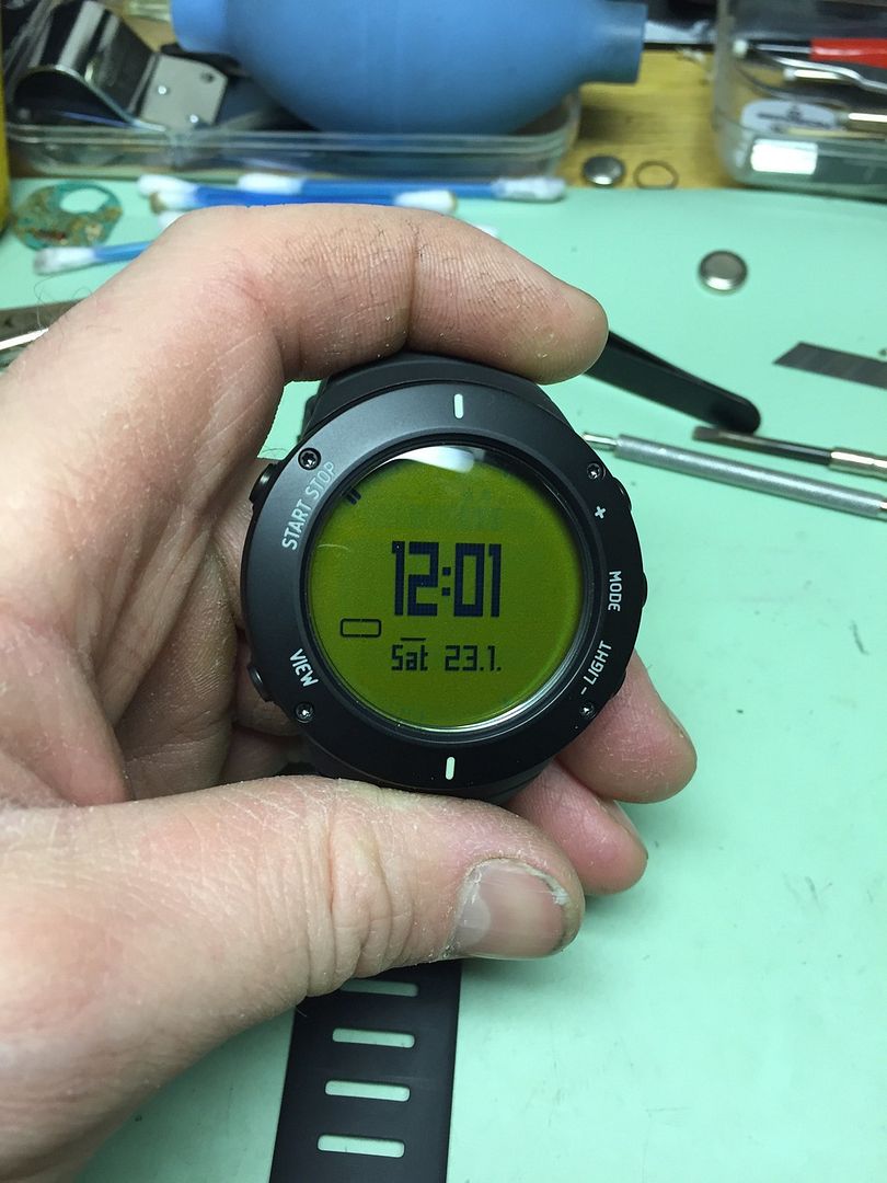

However I've been wanting a suunto / protrek for some time and the design of the military all black Ultimate really caught my eye.
It's a shame they decided to go for the poor option of a negative display - I have perfect vision and still find them hard to view
So, I decided to change it - The only issue was dismantling the case and I experimented with the all black before and must of had a sticking bezel because it just wouldn't pop off , when it did it was bent and the re inserting it I applied a touch too much pressure and cracked the LCD
Thought I'd try again with the ultimate as the bezel simply screws on -
Here is my result - much much better and have set the contrast to 10

I like it. I'm a big fan of my core brushed steel but not of the negative display. Been thinking about doing this same mod so thanks for the inspiration!

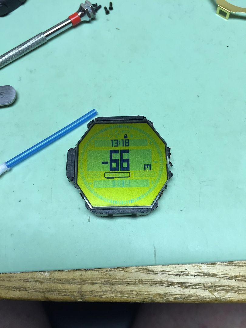

this was the first attempt - sent it back to suunto in the hope they will fit a new display as no one sells spares !!

I like the green tinted display. My effort was to just swap modules, as I didn't have the guts to mess around with the polarizing filter.

I think it's to do with the electroluminescent screen behind - I've used a polorizer that I use on all my Seiko digitals , it should produce a clear ( grey ) display but here it was either dark purple or green
