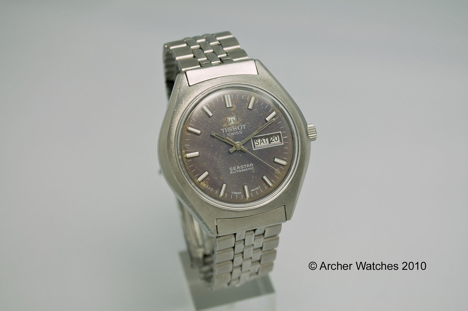

Does anyone have a list of the tissot models that this was fitted to?
I know it was fitted in some seastar watches, but does anyone have any more info?
I can't really give you a list of models, but you can look for models fitted with the Tissot Cal. 2591 like this one:
