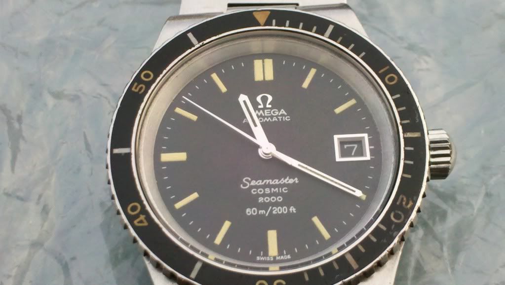

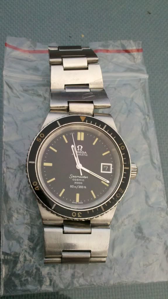

Omega cosmic 166.0137 Seamaster diver ?
All bros, I have a query regard my Seamaster Cosmic diver....
Though its running well as per vintage watch but everytime after I unscrewed the crown(after locking it in for a hours to days),the stem would straight away engage into the 2nd position(day settings) and the first few turns would be changing the day instead of 1st position(manual windable settings). So I would reposition the crown back to 1st position and screw the crown back. The watch would then be working well after the subsequent screwing in/unscrewing of crown,works all ok as per 1012.
1st position- winding
2nd position- day setting
3rd position- time setting
I heard that its due to the tight spring inside crown-stem component. Hence when crown is begin unscrewed,the stem will push out to 2nd position instead of 1st (neutral) position.
Is that true and possible.
If so,what would be done to remedy this issue? (change of crown ?)

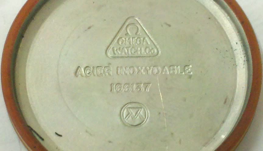

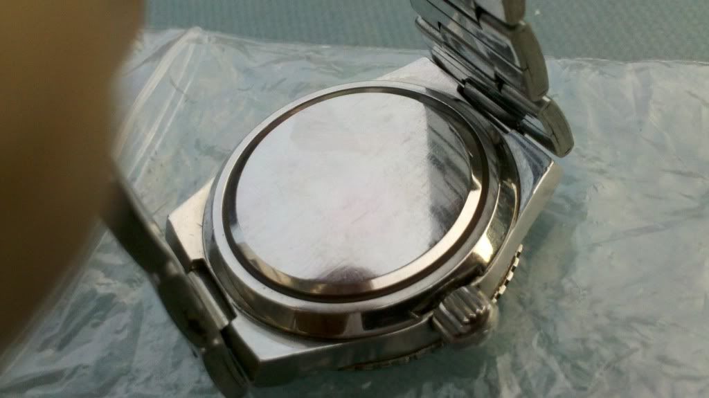

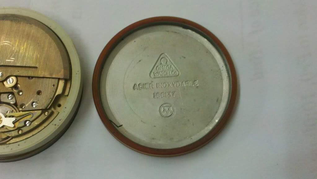

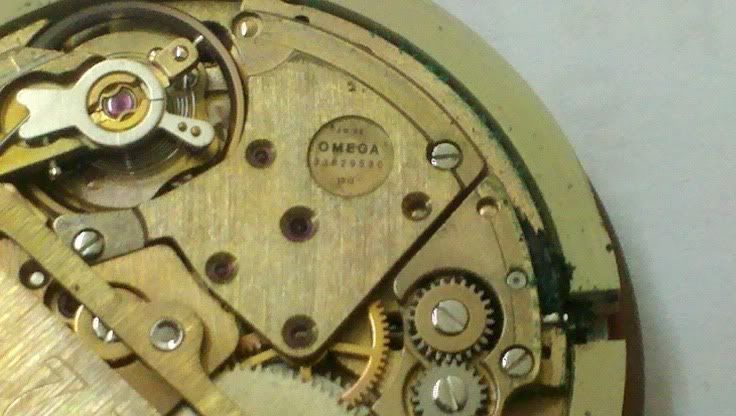

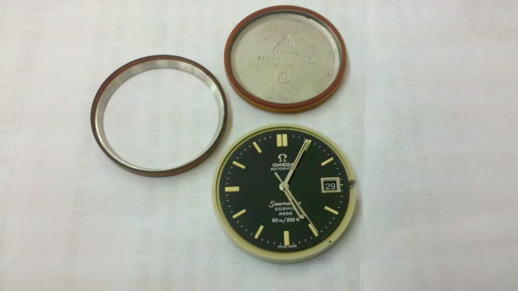

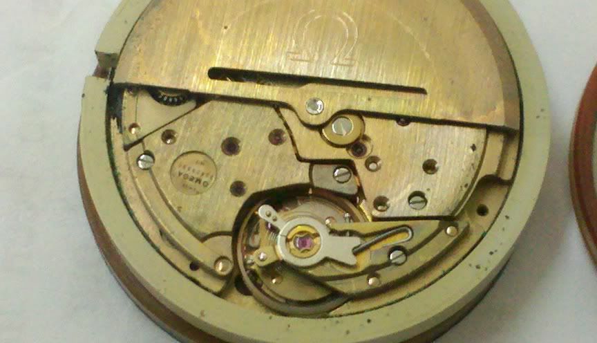

I had made an appointment with my watchmaker to have my Cosmic Diver serviced. And today I requested that he open up my watch on the spot so that I can take few photos of the movement & caseback before I leave my watch with him for servicing. It all looks ok as expected.

Finally after some wait,I got back my watch that I had sent in for servicing . It includes a full servicing of the movement and surprised that
the supposing 'crown spring' issue has been solved!
It was nothing more than the usual watch servicing(strip/wash/clean/lubricate/assemble) and now this watch function as it should.
Smooth swooshing sound heard when auto winding with buttery smooth manual winding.
