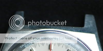

This case is very comfortable on the wrist, and the interplay of brushed and polished planes is pleasing to the eye. Its design antecedents seem to me to be a type of late 1930s military watch case, as in the Czech Air Force Longines, and certain Eternas, etc. All cases are vulnerable to overpolishing, but this model is especially so, and even moderate polishing stands to blunt the numerous angles and alter the fragile proportions and relationships of the facets of this watch.
Unpolished watches are marked by crisp angles
Compare with
overpolishing too close to the dial has altered this normally straight line
compare with unpolished

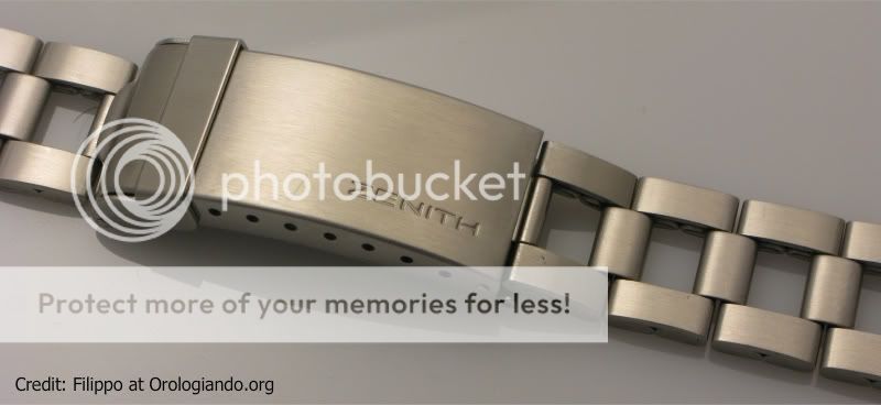

When sold with bracelet, these watches were sold with a ladder-type of folded steel bracelet by Gay Freres, stamped with the ibex and the date on the inside of the clasp. It's pretty hard to find a bracelet in reasonable shape today.

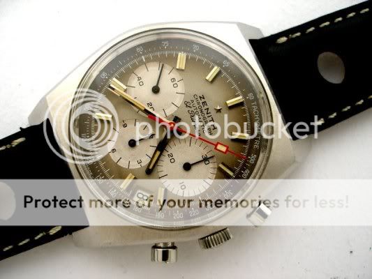

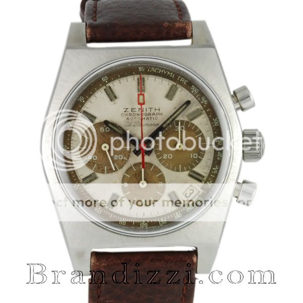

A 384. (2600 pieces, 1969-1971) Restrained and sober, this is the original. Ideally, the dial features crisp black subdials on a cream background.
The A 384 dial is the most prone to light damage, the black fading to chocolate brown, or even lighter to a cocoa powder color. While some may think this is attractive (cf. "tropical" dials in Speedmasters and the Rolexes sportwatches), I think it's damage, pure and simple. These occasionally get mistaken/passed off as a separate brown-on-white model, but no such model exists.
This model also shows the effects of a rather aggressive polish, with the edges of the top facet of the case riding up on the dial to make the dial look weirdly large. Compare with the watch above.
(attribution unknown)
Beware dial substitutions among similar models. The G 381 has a similar dial, distinguished only by gilt hashmarks and numbers on the subdials and on the decimal ring, and gold-toned hour batons. The G 581 (shown mislabled as a 381 in Rossler on page 243; compare with correct G 381 on page 248 upper left) has white script, but gold hour batons, and deeper sunk subdials.

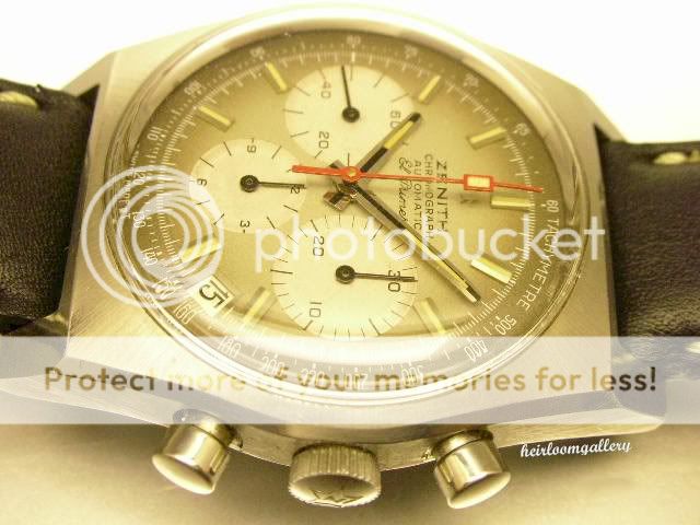

A 385. (2400 pieces, 1969-1971) I didn't think I'd like this one, but it is a surprise favorite of mine (who am I kidding? They are all my favorite). The dial has graded shading, fading from deep olive at the tachymeter to pale khaki at the center. Subdials are white, and extremely prone to smudging, I imagine from oil creeping up the center post. I don't know how easy these clean, but I'm about to send one off for a service, and I will let the forum now.
Of note, these dials look very different depending on photography technique, with the same watch presenting a very different appearance with different lighting. This is a pair of pics of the exact same watch, confirmed by case number, to illustrate the point:
(Heirloom Gallery, Singapore)

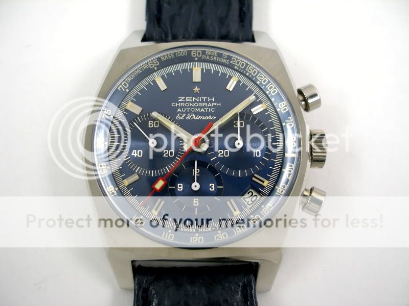

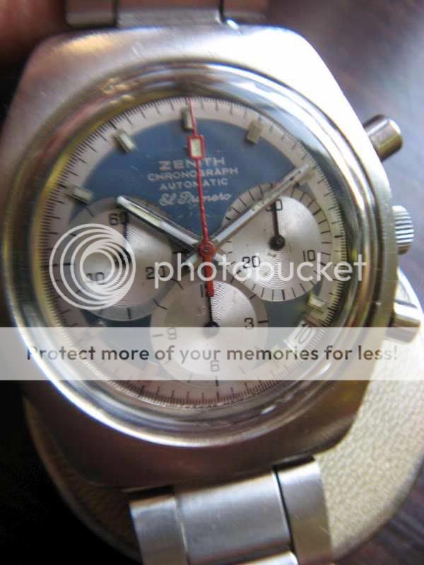

A 3818. (1000 pieces, 1971) Blue Primero. Less than half as many produced as the A 386, this is a sensational watch. The blue shimmers in the light, aided by the engraved subdial patterns. The gray and navy subdial borders are subtle and elegant. The painted hour batons and hands have faded to a lovely hue.
You'd think that no one would be ambitious enough to try to redial this, but someone has! Can you spot the differences?

So it probably was originally a blue dial (A788), repainted in white to look like the A787 ! Which explains the unusual combination of white dial with the blue tachymeter.
Concerning your question about the refinished A3818, the beautiful subregisters of the original were apparently too difficult to copy.
Secondly, the man who refinished the dial apparently preferred plain markers for the minutes and seconds instead of the triangular second/minute calibration of the original (which is unique for the A3817-A3818 ? among the Primero's at least)
