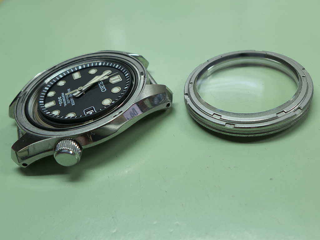

I think it’s time to kill this urban legend once and for all. I have responded to this many times for the last 15 years to set it straight, but for some reason guys keep repeating this falsehood over and over…

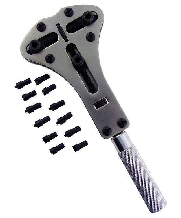

I regulated one myself maybe 15 years ago and didn’t need special tooling. I popped the bezel off with a butter knife just like any other Seiko diver, and then the ring securing the crystal is reverse threaded so the “tooling” I used was a normal cheapo 3 prong case opener. The special “mystery technique” which seems to stump everyone is just that you need to turn the ring backwards from what you are used to. I doubt Seiko has changed anything since then which requires special tooling.*
Yes it’s a simple process to regulate that is similar to the ETA movements with a screw, so it’s actually much easier to regulate than the other Seiko movements. The whole process was a simple DIY that I as a complete nincompoop was able to do with no instruction right in my kitchen and only with a $10 case tool and a butter knife, so any watchmaker should find it a cakewalk.
*Edit: for clarity here’s a few pics I stole from the Web. Just use a generic 3 prong case opener (can get on Amazon for like $10) and use it on the outermost ring, and make sure to turn it clockwise to remove the entire crystal assembly:

I regulated mine last night with a Weishi 1000, a cheap caseback removal tool from Amazon, and a 0.8mm screwdriver. It wasn't all that hard at all. Just tried to barely move the screw, the lightly put the caseback on enough that it didn't rattle or move easily but I could still get it off with my hands, check the accuracy with the Weishi then adjust again. In the end I BARELY moved the screw but I went from running a couple of seconds slow a day to a couple of seconds fast which I prefer. Then I put a tiny bit of silicone grease on the gasket and resealed it.
