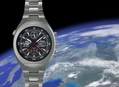

It is common knowledge that German astronaut Reinhard Furrer wore a Sinn 142 during his stay in space for the German Spacelab "D1" mission as part of the STS-61A Space Shuttle launch in 1985. For a very long time, his Sinn had been credited as the first automatic chronograph in space until new evidence recently gave that title to Seiko.
While Sinn also based some of its marketing on that achievement, I always had some doubts. Not that a Sinn did go to space, but rather about which particular model made the trip. So now I will share my thoughts on this topic, and I welcome any feedback of new elements you might have to either confirm or invalidate my theory.
