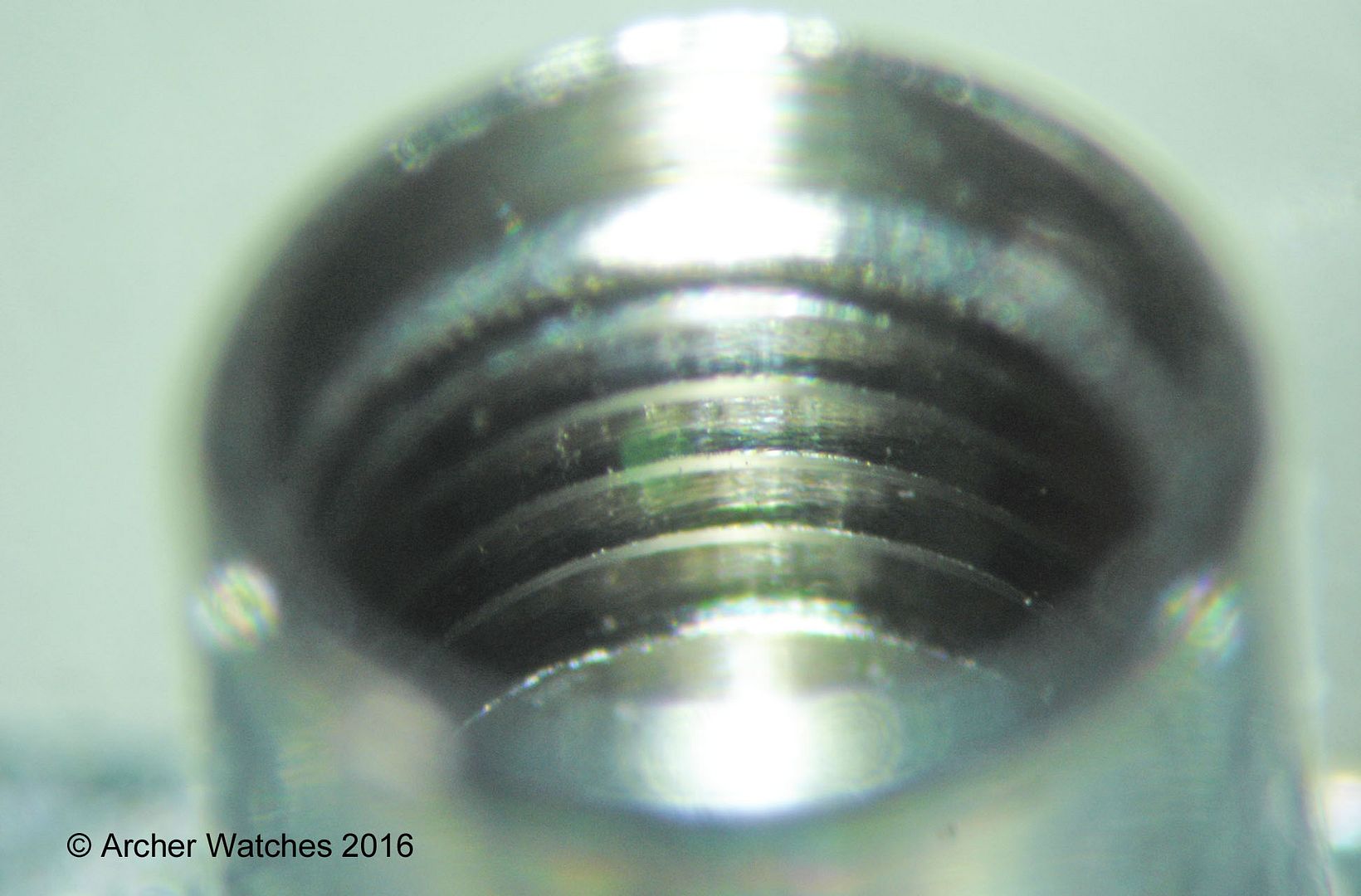

8,806 Posts
The case tube looks exactly as it should. The threads are on the inside of the case tube (where they are protected from dust and dirt) rather than on the outside.
If the crown is no longer threading down properly, it's possible that the threads have been stripped by cross threading. They then look like this:
If so, it will have to go to Omega, and I wouldn't expect that to be covered under warranty.
Cheers, Al
1,604 Posts
I've been wearing screw down crown watches daily for the last 40 years without incident, one Rolex, one Omega so IMO it doesn't seem that hard to perform that operation without stripping the threads. But, it also seems to me that unscrewing a crown and screwing it back in again is a common enough practice that the design should be such that the threads engage reliably every time without requiring any special technique to ensure they've engaged properly. In other words, unless the user is extremely careless it would seem to me that stripped threads are more indicative of a sub-optimum design, rather than user error, so I'd be upset if it wasn't covered by warranty.
