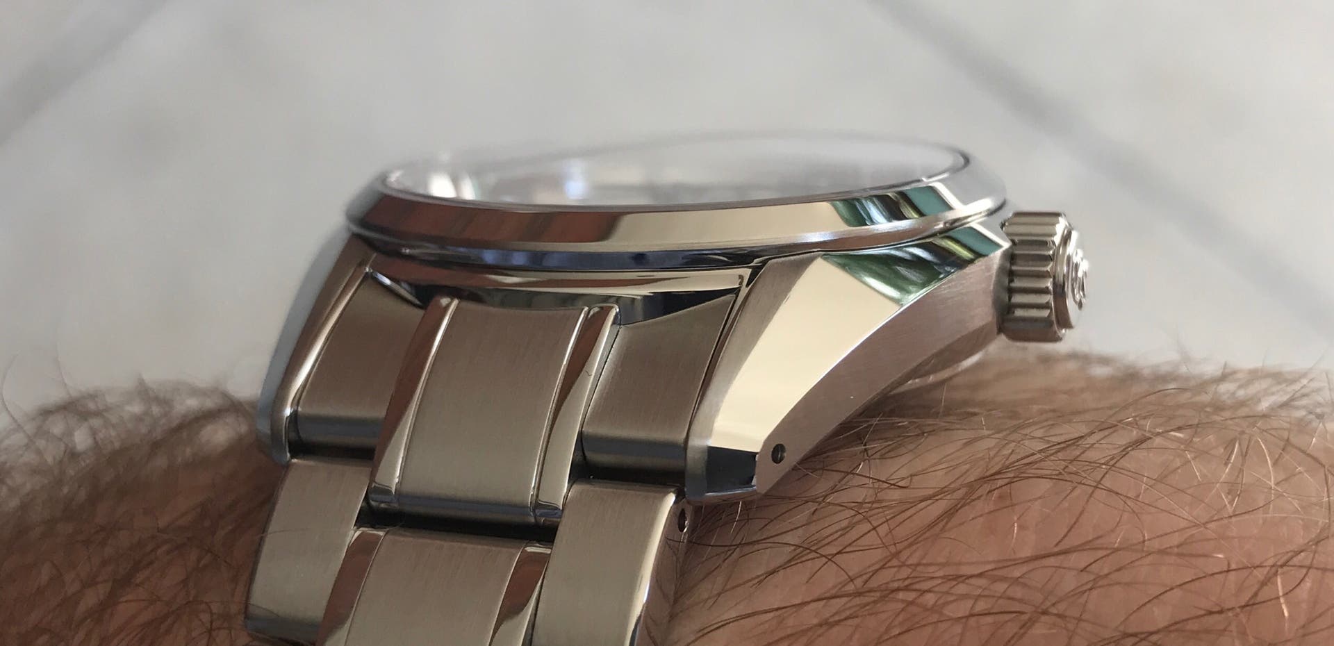

So, I knew these were supposed to be more accurate than most, but I've been quite pleased with what I've experienced the first 5 days wearing my SBGH001. Over 5 days, 7 data points, averaging -0.2spd. Is this normal?? Feeling very fortunate and impressed either way!
