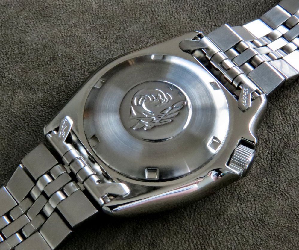

#4 ·

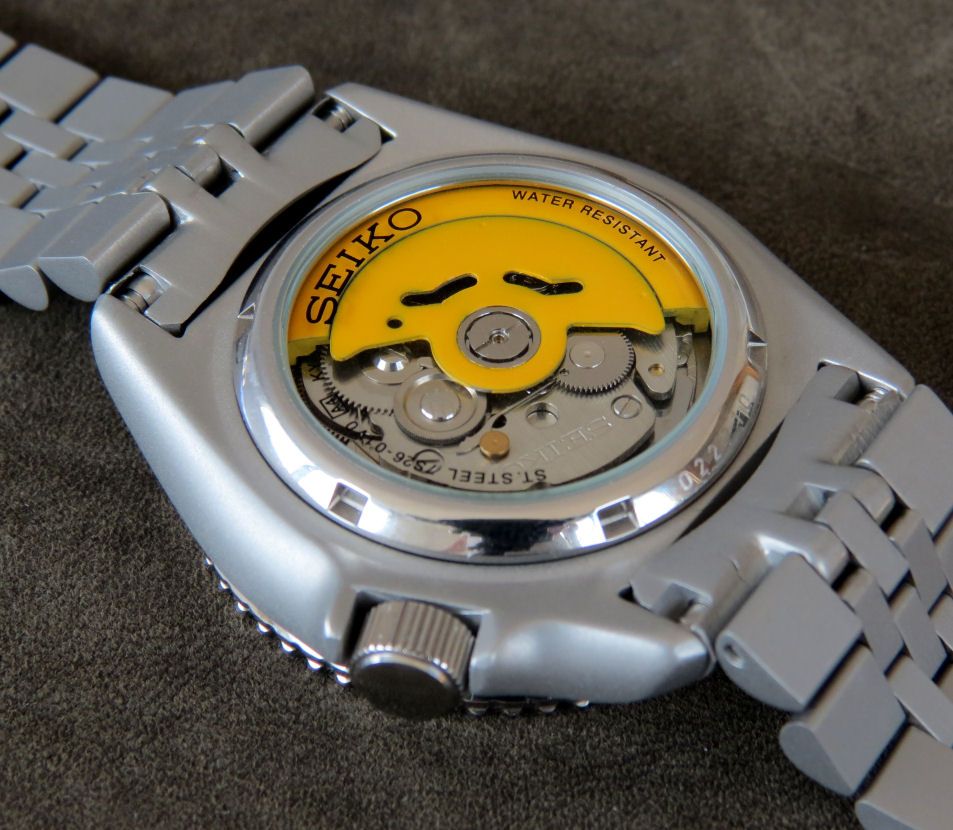

#11 ·
Hey, Pallet Spoon. That looks great! Where did you find the yellow rotor, or did you do that yourself?
I really like the idea of polishing off the digits and like the looks of yours. The exhibition feedback that you have is exactly the one I'd like to find for my build. Did you get that at Dagz? Is it from a Series 5 piece?
