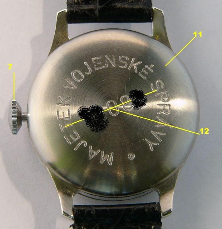

11: The back cover should be a snap-on type. For the Soviet version there are no issue numbers are any other data.
The watch was also issued to the Soviet allies, so far only Czech versions could be found. This watch was issued to the Czech airforce. (It is likely that the Czech pilots received their training and graduated on the Soviet Airforce schools.) The text mentions “ Property of the military administration” and the serial number.
