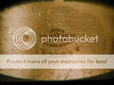

My second family watch was owned by my Grandfather who died in 1971. It was given to him and is engraved on the back by Good Humor (Ice Cream Company) and is dated 1935 to Fred Leonard. The inside back of the case is marked woth the Star Watch Case Company logo and the serial #1336694 and hand marked is what appears to be the date 9.16.35 and markings from what I assume are the various people that worked on the watch. The movement is by the Concord Watch Company and has 15 jewels. It also has the word SWISS, the letter B and the word unadjusted. The case is 14k gold filled. I contacted Good Humor a few years ago and they told ne they didn't keep records from back that far.

I had sent it off and had it serviced about 15 yrs ago and wore it to special events. I got divorced back in 1999 and it took a couple of years before I could get it back from my ex. When she finally did return it, it only ran for a few minutes at a time. I wish I knew more about how my Grandfather got the watch. The story I got was that he was one of the top sale people for that year which must have been difficult during the depression. Am I right in assuming that the markings on the inside of the back case are from the people that made the watch? The hand writing appears to be different on each one.
1,355 Posts
Those markings were typically made by watchmakers who serviced the watch. Usually they were a number that corresponded to an entry in a record book. Sometimes they are a date and that's nice for the collector as it gives him/her a bit of the watches history.
