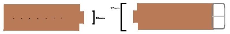

I have a watch with a strange style of lug (an Orient M-Force actually).. where it looks as though it would fit a 22mm strap, but when you look at the underside of the watch, the lug spacing is only 18mm. That makes an 18mm strap look way too small, but a 22mm isn't possible to attach. The watch was meant for a specially fitted bracelet that came with it. Basically, I need a strap that's something like this (sorry for my crude drawing):
So the question is, where to get one?
Thanks!!

You could commission one of the many custom strap makers on this forum to make you one.
Or get a 22mm strap and notch it yourself.
Either one of those options would be the best bet.

i really want to try to make the strap but kinda worried about the end.
i want to ask, is it half circle shape end..??
378 Posts
View attachment 11218874 View attachment 11218882 20170317_214752.jpg 20170317_214847.jpg 20170317_214948.jpg 20170317_215052.jpg 20170317_215107.jpg 20170317_215440.jpg 20170317_215615.jpg 20170317_220013.jpg
Please see photo, Its kind of half-circle, but not a perfect circle.
Inside the circle, from the left pin hole to the right pin hole, its 12mm, so all the weight/stress of the watch will be on the 12mm, so it will need something to make it stronger, maybe double layer of the material around fold. So when you fold the material over the pin it will be 12 mm wide, if you use the second fold, it will have to be around 10mm, because of the curve that gets smaller as you go nearer the end.
