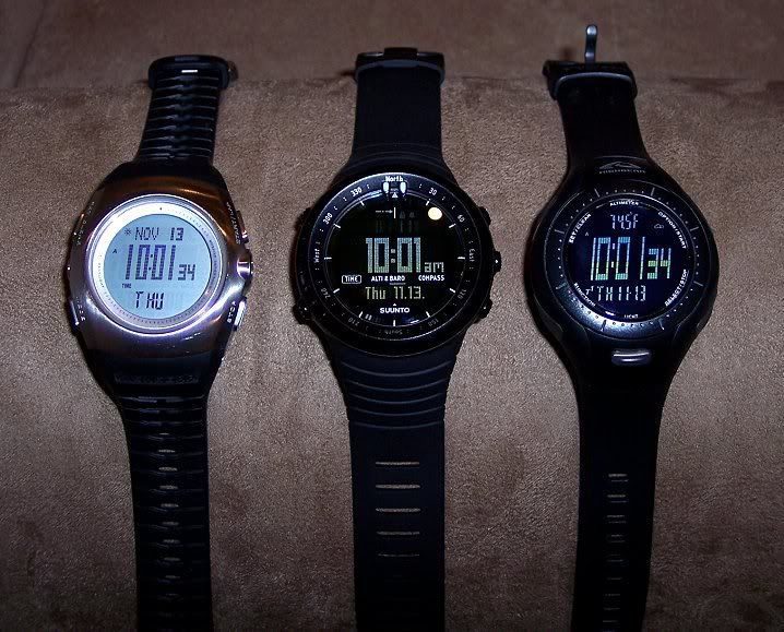

The buttons are firm to push and I like the no-slip checkering engraved in them. The Negative display is sharp, perhaps sharper than the Altiforce (see pic).
The Altiforce has more of a blue cast to the display. The negative (black) display does come with cost. The pure and simple fact is: Any negative display will never be as readable as a positive display but thats the price you pay for looking cool. So be warned.
