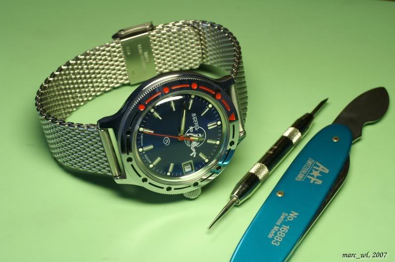

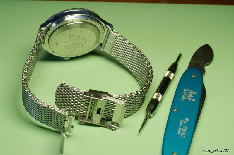

Our guinea pig today is the Komandirskie version of the "blue diver" (circa 2004 automatic caliber Vostok 2416b 32 jewels). Something wrong happened in the dato mecanism and I need the mesh bracelet to put it on my Amphibia version.
The main difference compared to Amphibia versions is the brass chrome-plated case instead of the all stainless steel, a ca 5atm resistance instead of 20atm, a thiner acrylic crystal, but the rest is quite similar. Straight hand and no lumed spot on the second hand.
The mesh bracelet waspurchased from my local watchmaker. It has a safely buckle.

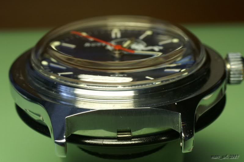

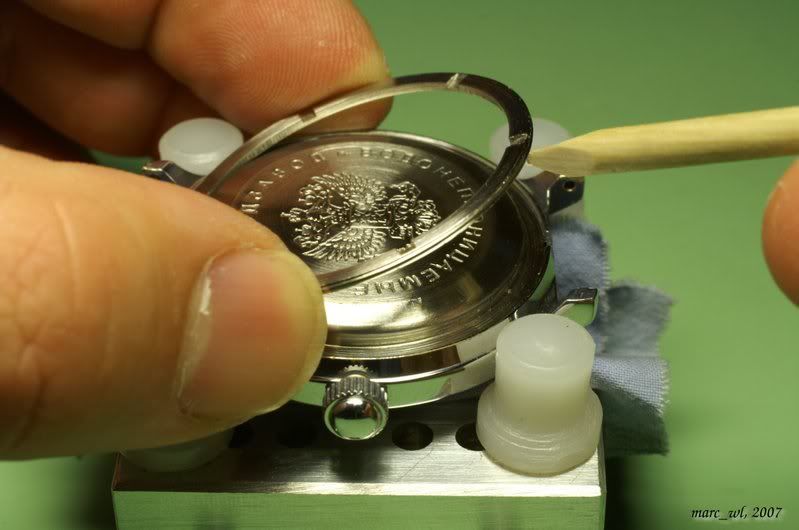

Someone, a few time ago on this forum asked how to remove the rotating bezel. Its a good occasion to see how to proceed. First, protect the case with a piece of strong paper. Then lift off smoothly the bezel using a Bergeon-like knife.
It comes effortless and it can be snapped on back easily as well
The bezel is in brass and chrome-plated too. A bulged wire give the necessarily bezel friction :

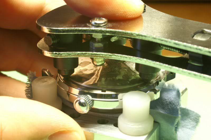

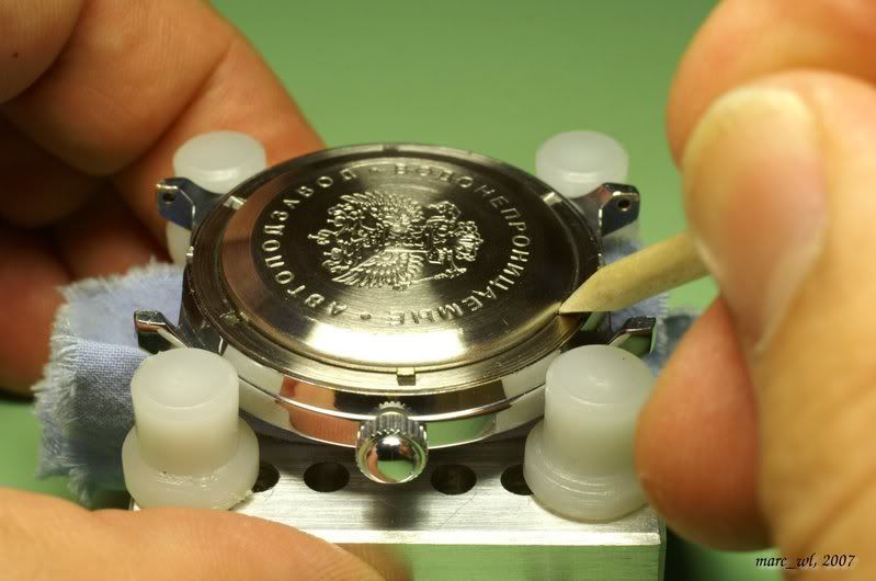

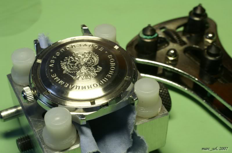

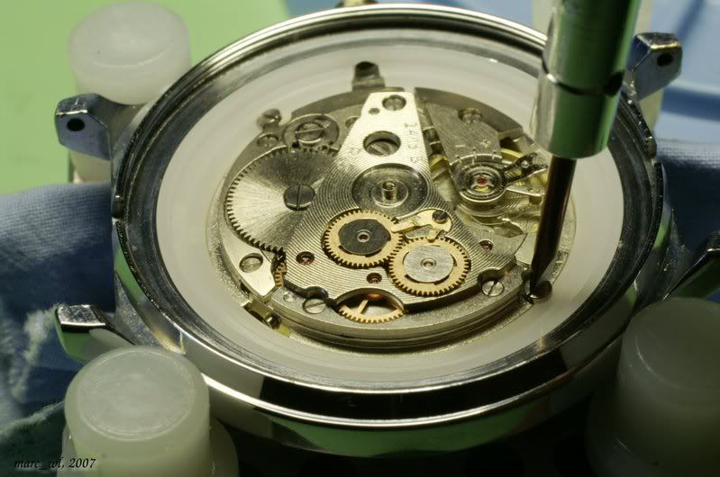

Well. Now we can open the case. A case holder is required.
A good care is to put on a protective film on the case back to prevent any damage with opening tool that need to be adapted to the screwed ring size.

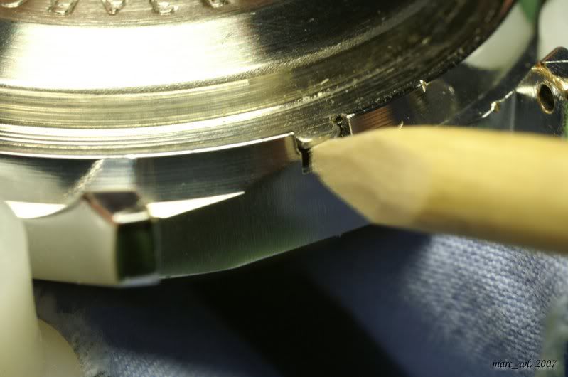

As soon as the ring is unbloked, one can continue using a safe wood pick to fully unscrew the compressing ring that can be removed :

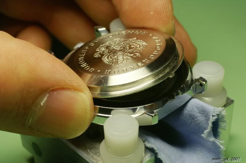

Then we lift the case back using the small finger and remove it

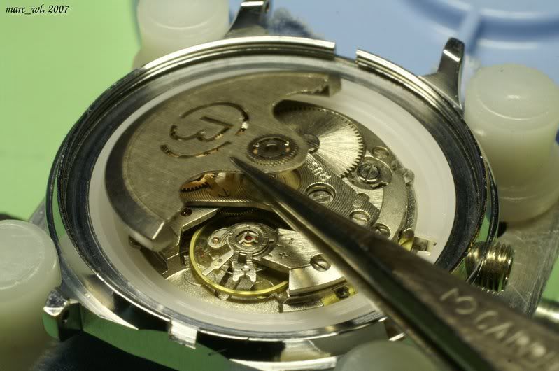

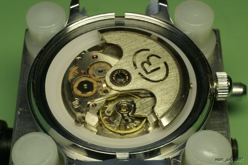

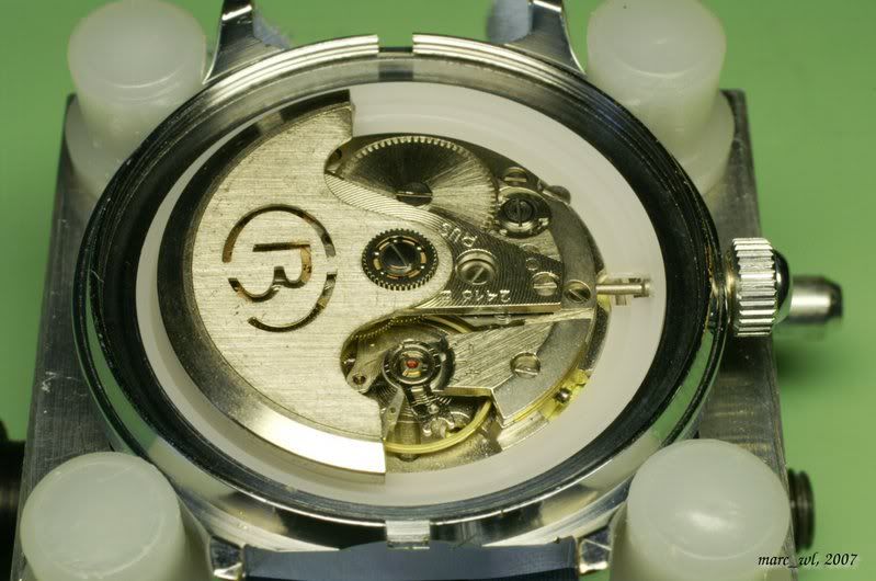

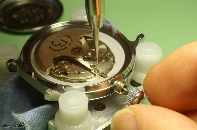

Here is the movement and the Vostok rotor:
For the demo purpose I remove the gasket.

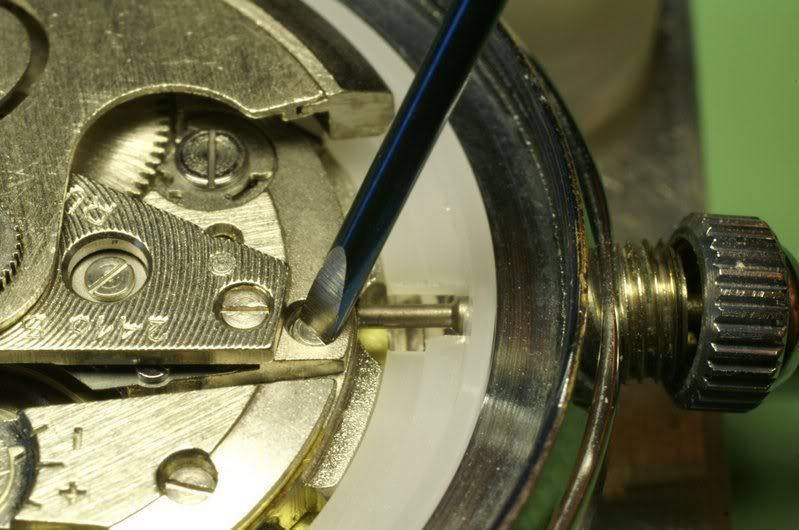

One can now extract the stem+crown. Be carefull, this screw is not the stem-liberating one but just a bridge screw!
There a specific pusher near the click that more handy that a screw

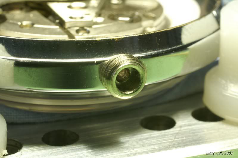

Here the stem tube with its outer thread.
And here is now the famous upsetting crown!
If the crown is not pulled out, it is fully free to move, but when you screw it down you don't turn the stem anymore! Very clever!:-! Now you can see the inner gasket and understand that it should be screwed down to protect the watch!!

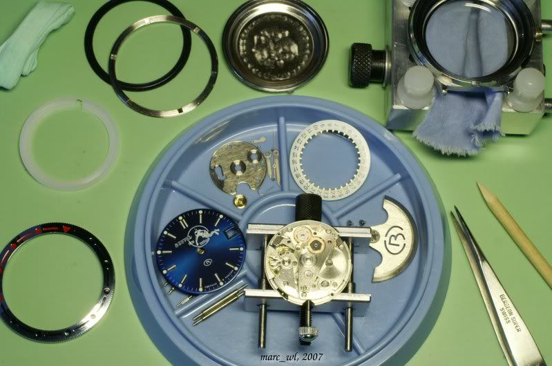

We now remove the rotor to be more comfortable in the following steps
After putting the screw in a safe place, we can lift off the rotor

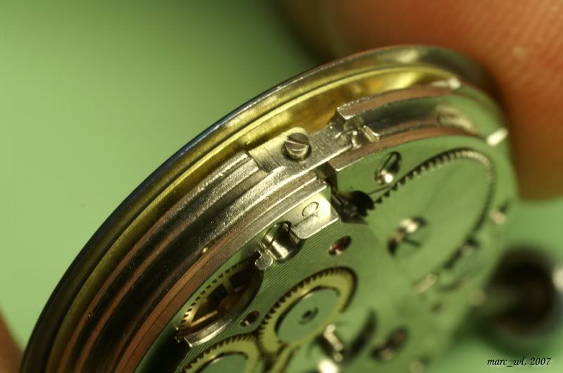

Well, we can now uncase the movement just by unscrewing the 2 casing screws on the nylon ring.
The movement is free. Be carefull not to dammage the dail and the hands attached.

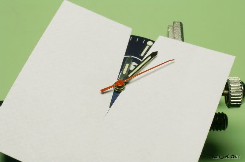

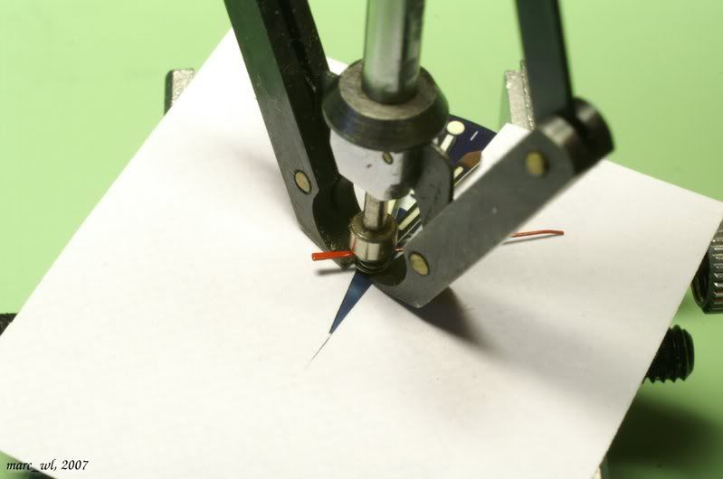

We should first get a minimum alignment to lift them all at the same time. One protects the dial with paper and a sharp V:

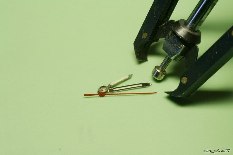

We take the hour hand with the lifter an push gently to lift the whole
It's done!

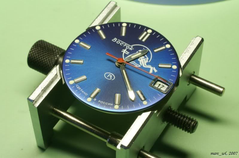

That's the Deep Blue !

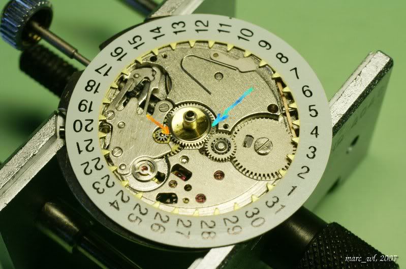

We can now remove the dail. 2 small screws block the dial feet on the periphery

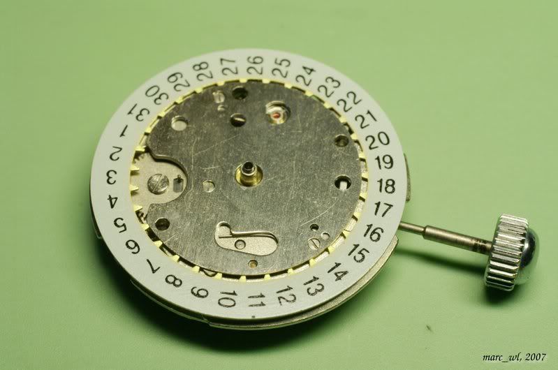

It comes effortless and the dato mechanism appears :
A wire spring in the small window should be carefully removed before unscrewing the plate.

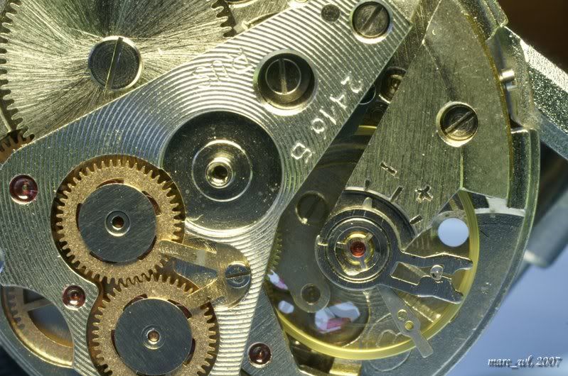

So what's going wrong in this dato??

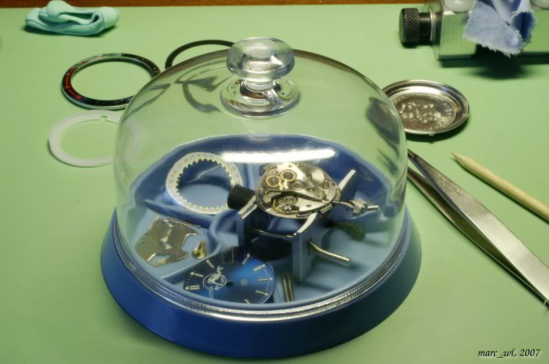

Ha! OK. I see I broke 2 teeth (orange arrow) of the hour wheel (blue arrow). I remember that something went hard while changing the time and I forced a bit (never do this!).
So that the hour hand stopped at 1 am to 1 pm while the other continued their run!!
I've asked to Peter Maier if I could get a new one with my Ministry and Neptune order. Hope so.. While waiting, I keep the whole away from the dust.

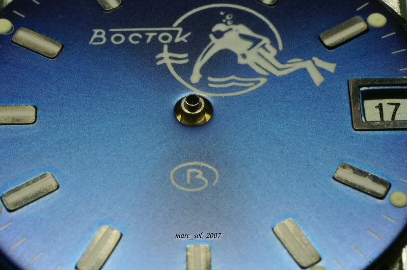

What is more magnificient than any running caliber outside its case
It's done!
