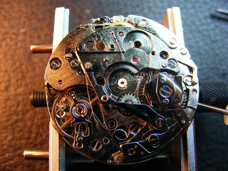

Again this is an old one, operating at 3 Hz, the newer one work at the same speed as the ETA/Valjoux 7750. These movements are not quite as well made as the Seagulls, Hanzhous or DGs. The skimping shows, the material for the reset hammers is thinner than the originals and this one had been bent in two places to get it to contact the reset hearts correctly. The mirco adjuster on the balance cock has so much play in it it is unusable, and I wind up just moving the regulator directly.
Major differences (aside from the speed):
The pallet fork has banking pins instead of buttresses on the pallet cock.
The day detent is on a eccentric instead of a fixed pin (compare the 4th picture in both threads) this is to allow for centering the day in the dial window. The day dial is also retained by a little clip, whereas the ETA/Valjoux it just has a washer on top of it and the dial keeps it in place. The day dial is not interchangeable with the ETA/Valjoux.
The reverser wheel in the autowinder has the Shanghai five jewel clutch, not the two pawls as ETA prefers (making this a 30 jewel movement.) This particular example refuses all attempts to free the clutch up and the rotor spins when it is wound by hand (I cleaned it, oiled it, dry cleaned it to get all the oil out of it, cleaned it again...)
The chronograph second hand brake spring had a bad temper and took a set and had to bent back into shape.
Despite all its problems and poor workmanship, the movement works well keeps good time.

I do not know its origin, it came out of a Apogaum 300 buck Chronograph.
It is a 21,600 bph, 30 jewel movement.
The jewel layout is as follows:
The standard 17:
Balance staff bearings: 4
Impulse jewel: 1
Pallet pivot bearings: 2
Pallet entry and exit jewels: 2
Escape wheel pivot bearings: 2
4th wheel pivot bearings: 2
3rd wheel pivot bearings: 2
2nd (or off set center) wheel pivot bearings: 2
The autowinder (11):
1st reduction gear pivot bearings: 2 [1]
2nd reduction gear pivot bearings: 2 [1]
Reverser gear pivot bearings: 2 [1]
Reverser gear clutch elements: 5 [2]
The chronograph mechanism (3):
Second counter rear pivot bearing: 1 [1]
Minute counter rear pivot bearing: 1 [1]
Minute counter transfer gear bearing (internal to the gear): 1 [1]
Note 1. These jewels are not present in the older 17 jewel Valjoux 7750s
Note 2. These are not present in any ETA/Valjoux 7750. This is the only variation from the standard 25 jewel layout
