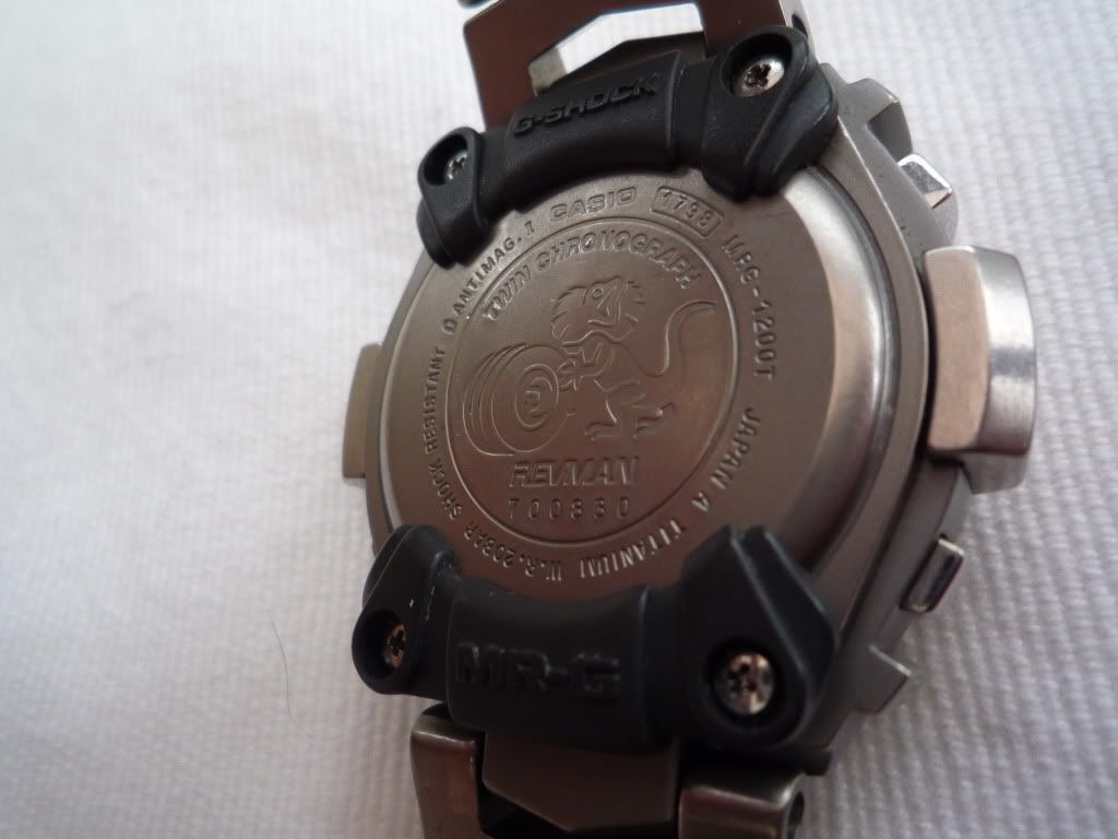

There was one disappointing thing with the watch, on the second day of wearing, the watch fell off my wrist as the bracelet became detached from the watch at the lugs.
On the Revman the bracelet attaches via two pins with a collar system at the lugs, though the rest of the links are attached via split pins.
On this watch, on close examination, I found that the pins at the lug had no collar and the pins had been glued together!
Luckily the watch fell onto carpet and no damage was done and I was able to find the pins. I had a spare collar available and was able to fit this fairly easily and it is now perfect.
I subsequently decided to check all the pins in the links and found four that pushed out with minimal force. I soon sorted this out and in less than ten minutes the bracelet was as solid as can be.

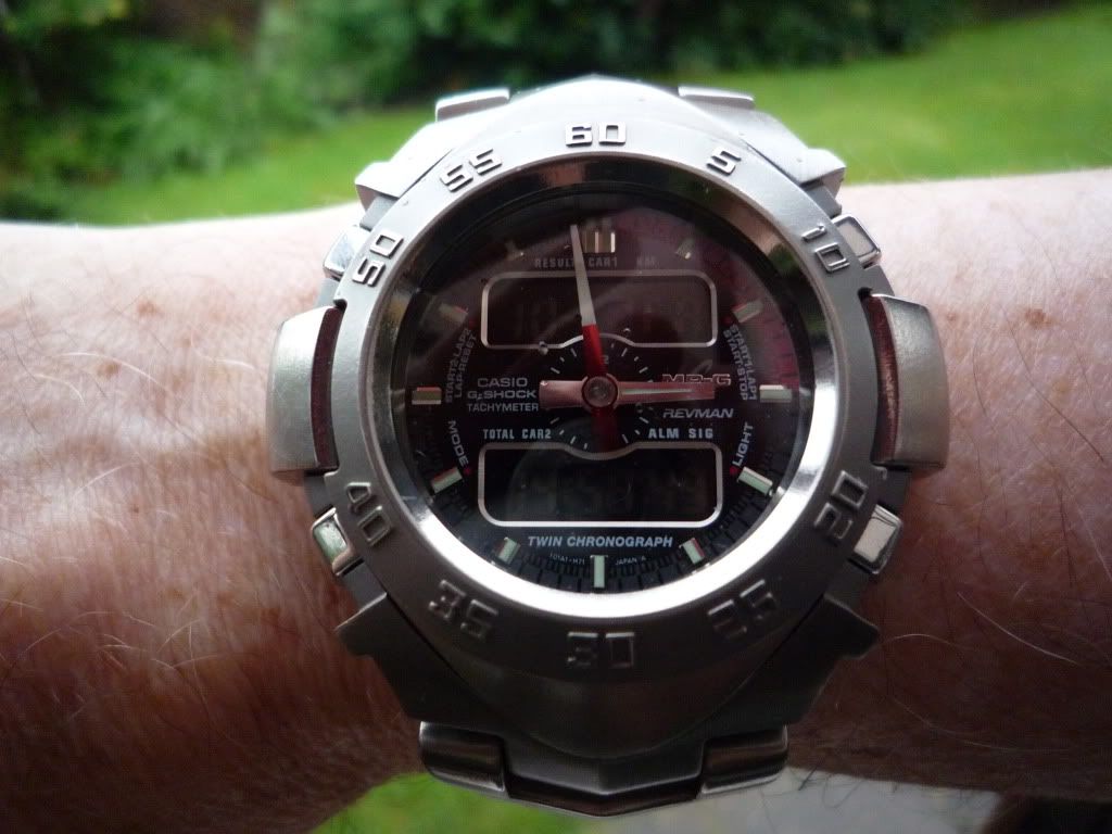

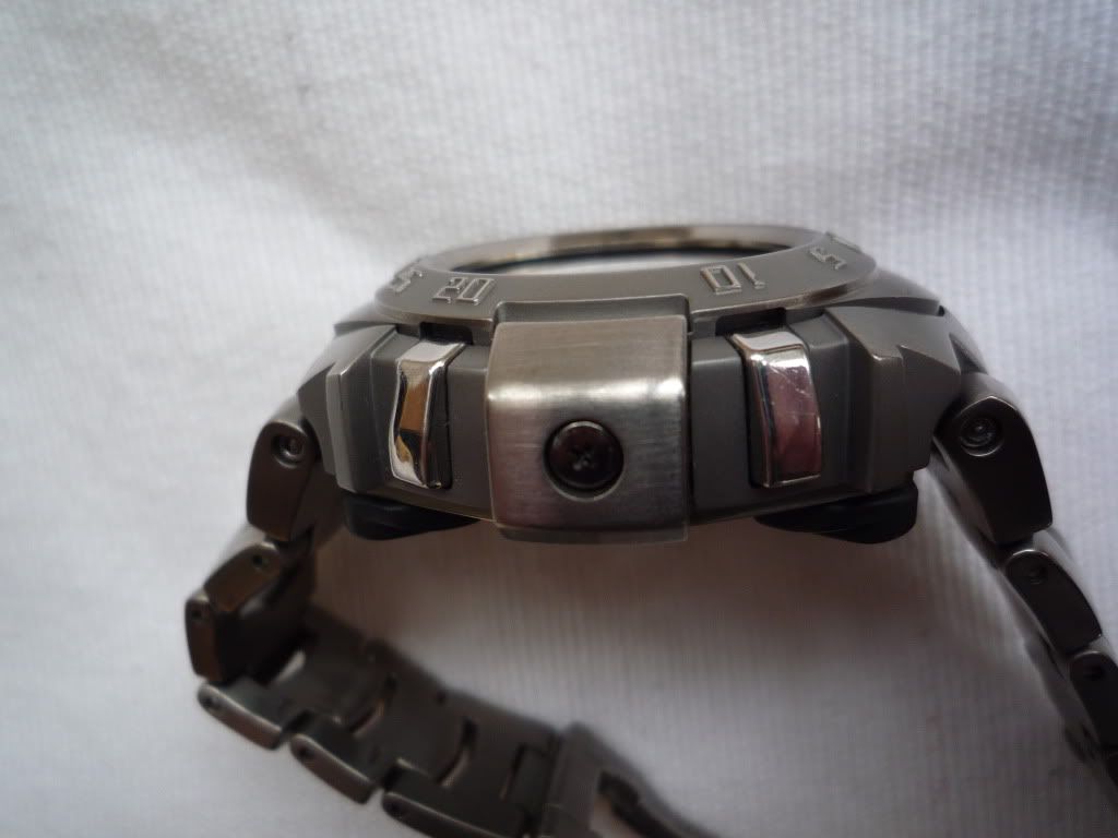

The watch is one solid chunk of titanium with a hefty bracelet to match.

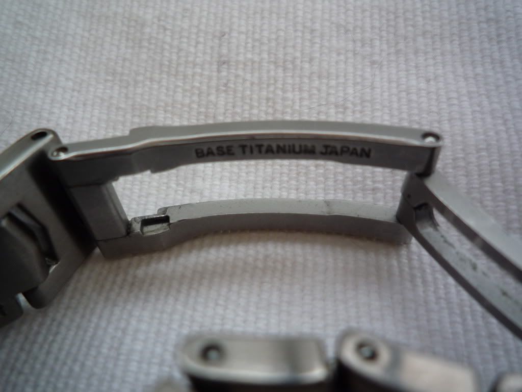

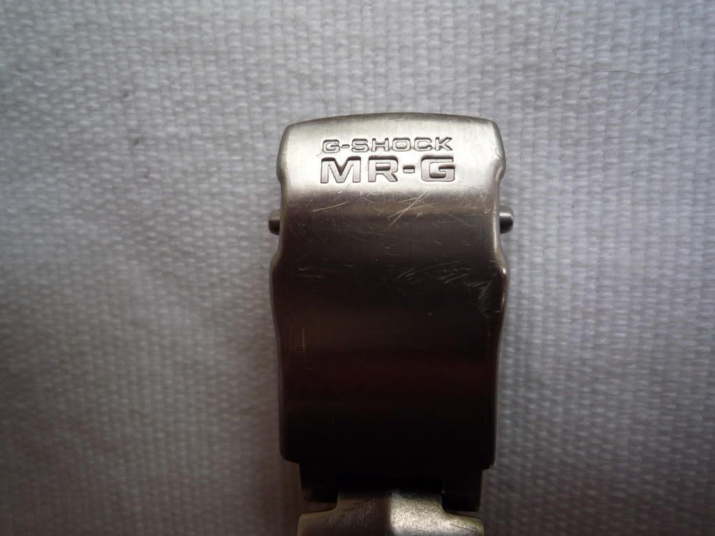

Look at the solid machined nature of the clasp, none of your pressed and stamped rubbish here.
Click this bar to view the original image of 1024x768px and 102KB.
Click this bar to view the original image of 1024x768px and 99KB.

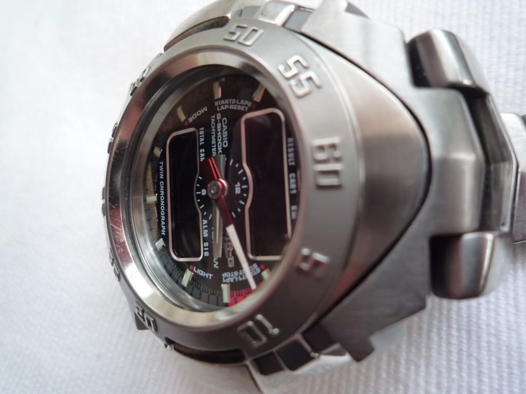

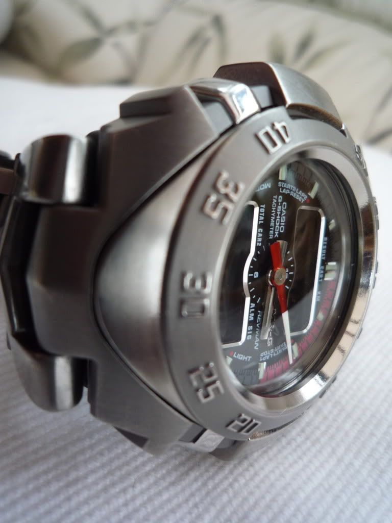

The Revman is a mixture of brushed and polished titanium surfaces. The inner bezel is highly polished as are the buttons, the side pieces have a shinier brushed finish than the rest of the bezel which has the typical slightly matt Ti finish, lovely!

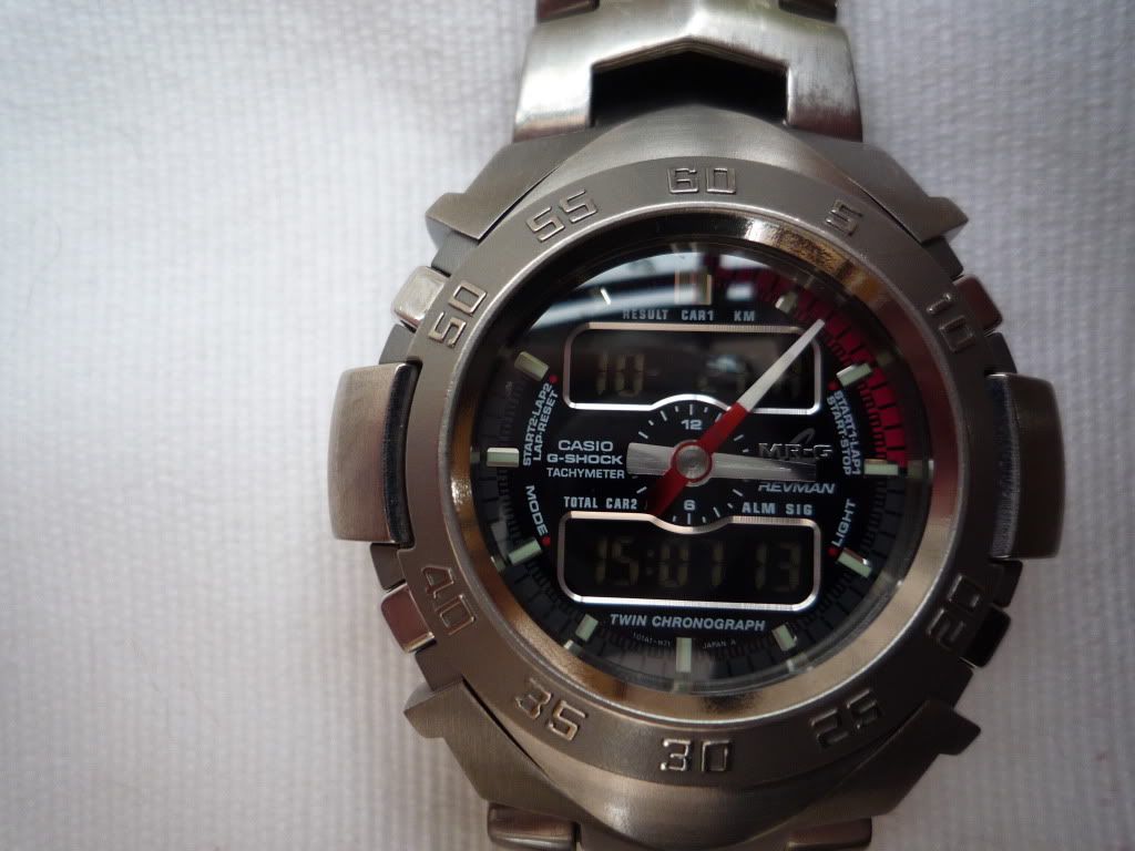

The dial is quite stylized and is obviously meant to represent a Rev Counter with its red section showing the rev limit. The way the inner 'Speedo' cuts into the digital sections is quite a neat touch I think.
The dial has a lot of writing and information on it and perhaps would be better with less. The numbers on the bezel are a good touch they are subtle with no added colour but add to its overall appearance in my opinion.

The crystal is slightly domed.

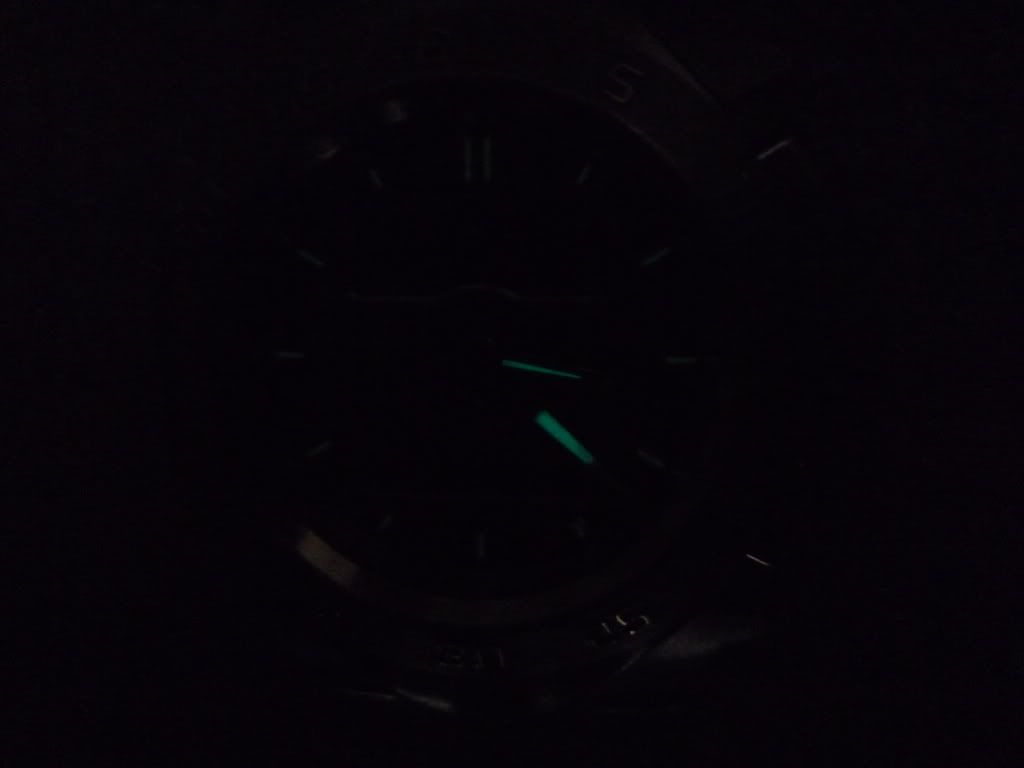

The lume itself is weak overall, it is stronger on the hands than the batons but that is not saying much. It has, of course, the EL as well.

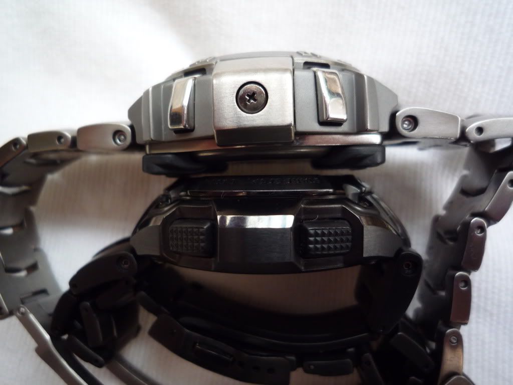

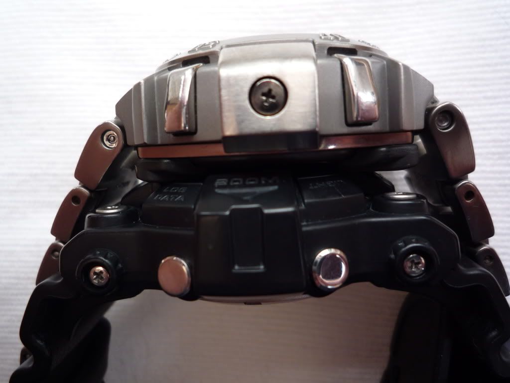

As I have already said this is one solid chunk of Titanium. I mean this watch is big. It must be the biggest MRG ever made and is one of the all time biggest 'G's.
It runs 49mm to the side pieces, is 54mm to the lugs and is 19mm thick to the back protector.
This is bigger than the MRG-7500 by some margin.
Click this bar to view the original image of 1024x768px and 151KB.
It is also bigger than the 6900, the PAW1300 and the old Frogman. Only the Raysman is bigger amongst my 'G's, being the same length but being 2mm wider.

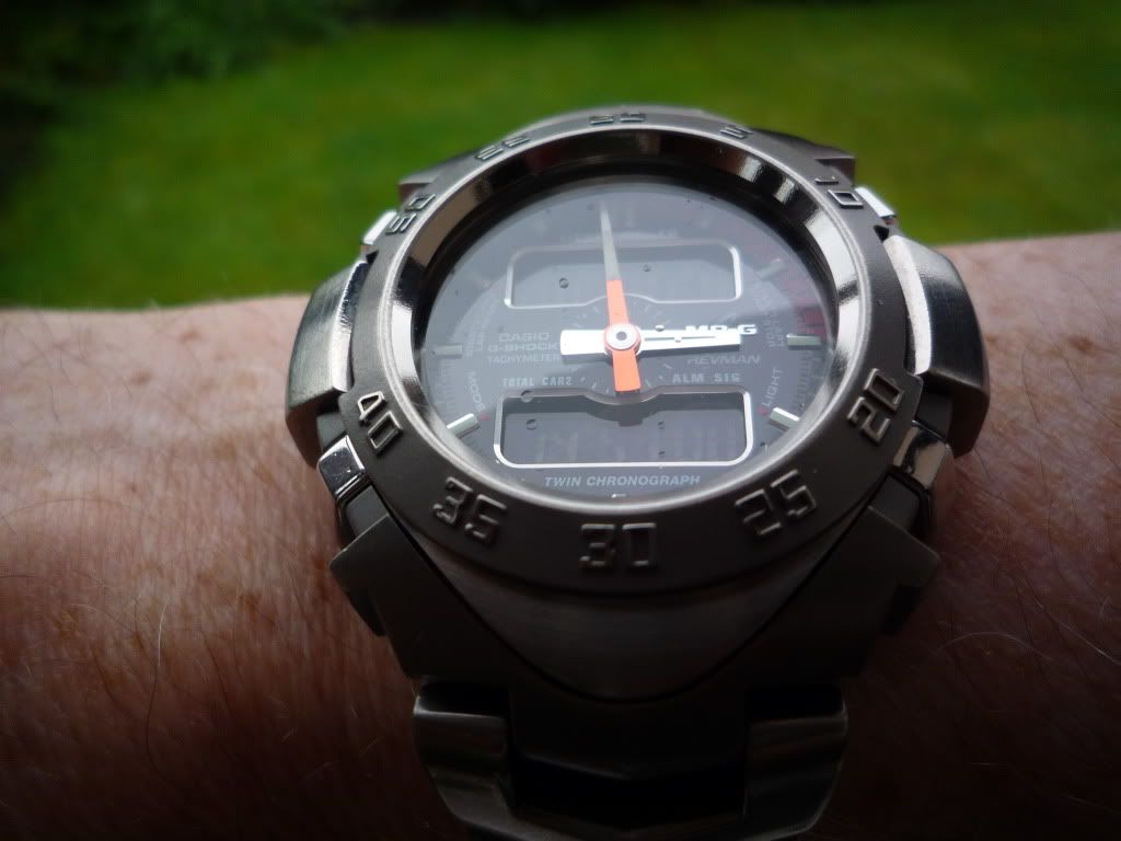

Even though the watch is all Titanium it must be one of the heaviest 'G's ever made. The Revman is noticeably heavier than the MRG-7500.
I don't have any scales so I can't say what the actual weight is, though other members may know. It wears very well though, it doesn't look huge on the wrist due to the comparitively small crystal area.
