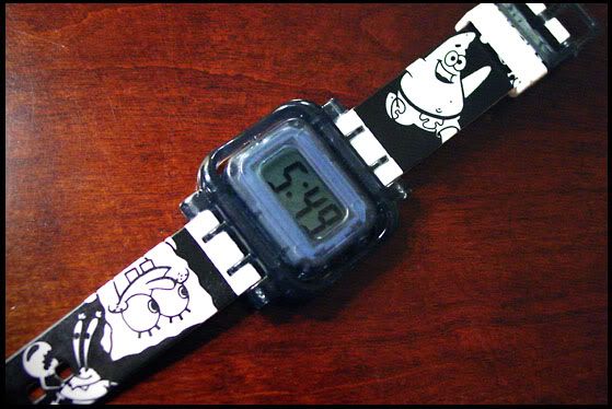

Figure 5: Thermocompensated? Well... that's a stretch. But certainly 'thermo-desensitized'. (Photo by Bruce Reding.)
One final comment about non-thermocompensated quartz watches is that manufacturers typically set their rates so that they run slightly fast when at wrist temperature. This is because, since variations around this temperature can only reduce rate, setting the maximum rate fast makes it more likely that the average rate will be closer to being correct.

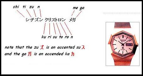

Caliber: Citizen Crystron Mega (movement number unknown)
Technology: Single high frequency (4MHz) AT-cut crystal
Annual accuracy: ±3 seconds (We do not know if Citizen recommended a minimum wear time to assure performance to this specification.)
Rate adjustable?: Most probably yes, by the Service Centre in Japan. We do not know the specific adjustment mechanism.
Watches that use this movement:
Note 1: This is the tightest specification ever claimed for a watch!
Note 2: The battery lasted one year.
Note 3: Only 3000 were made. This is not surprising considering the 4,500,000 yen price.
Note 4: This watch is sometimes erroneously referred to as the Citizen Mega Quartz. The picture below shows the correct phonetic translation:
(Translation courtesy of Robert Logie. Photo from Citizen website.)
Source of information: The history section of Citizen Japan's website. (Reference 5 below.)

5. Citizen Crystron Mega: http://www.citizen.co.jp/gallery/hi...yousai/034.html Babelfish can be used for translation.
