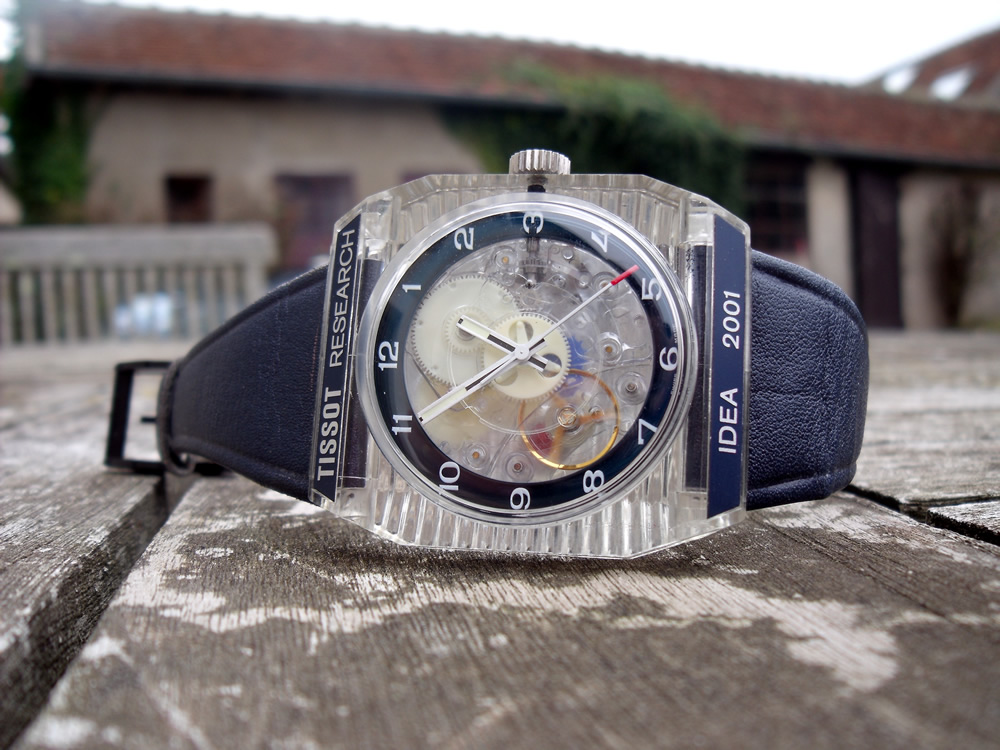

The IDEA 2001 launched in 1971 , the research into a plastic watch started in the early 50's. Twenty years earlier Tissot and Omega had joined to form SSIH (Society Swiss Industry Horologere ) and Tissot assumed the lesser role to Omega. Tissot continued to be innovative and was one of the first to launch and market the antimagnetique watch. The innovation at the heart of Tissot continued with the Tissot Research IDEA 2001 plastic watch.

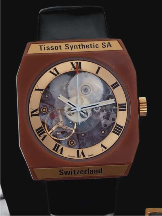

Most of the movement is made of plastic and is designed to be self lubricating, calibre 2250 was named Autolub but was also known as Astrolon and Sytal. The only metal parts are the keyless works , balance and mainspring barrel. As a Skeleton wristwatch Tissot cleverly reversed the normal layout allowing the balance to be seen through the dial. Tissot also developed their own shockproof system and lessened the parts from 91 for the average watch to 52 with some parts of the construction automated. Perhaps not everyone's cup of tea, some people would look aghast at this watch; It's not something they want to see - the equivalent of walking in on your parents!
But I ask you to humour me. Lets look a little closer at this piece because I think there is more to this than meets the eye.
Sealed hermetically the idea behind the IDEA was to have a mechanical watch that was cheap to make needed no servicing and was an affordable option for the customer. The early 70's was a heady time for Swiss watchmaking and the industry was about to undergo some radical changes. The Neuchatel Observatory chronometer trials had just closed. The first auto chrono wristwatches had emerged. Pulsar had plans to launch their LED in the spring of 72 and LCD was on its way. At the onset of the quartz revolution Tissot must have hoped they had a winner with this funky affordable Swiss timepiece but history tells us it failed. The quartz juggernaut rolled over the Swiss industry leaving a trail of destruction, so much so that a mere 7 years later SSIH was in deep financial trouble. ASUAG ( Allgemeine Schweizerische Uhrenindustrie AG ) was also facing liquidation. ASUAG was the worlds largest movement maker and parent company to GWC, General watch company. Desperate bankers forced both companies to merge in 1983 to form SMH. In 1985 Nicolas Hayek the executive that oversaw the merger made the company private along with Swiss bankers and private investors. The initial restructuring coincided with the launch of the Swatch watch. The Swiss watch or Second watch.

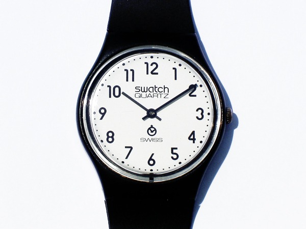

Elmor Mock and Jacques Muller are credited with designing the Swatch. Muller said he was inspired in 1980 while lying on a beach. The goal was to whittle down the average number of quartz parts from 120 to 51 and to automate the manufacture. The result was a watch in plastic that had colour and novelty and every 6 months a new range could be released. Launched in 1983 the designers hoped they had a winner with a funky affordable Swiss timepiece and history tells us it was a smash hit. In 1998 the company became the Swatch group, seems this little plastic watch was so successful the company rebranded itself after the product.

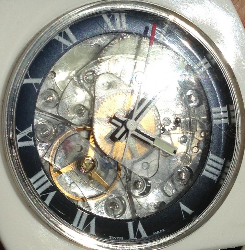

Here you can see the bridge and plates in clear plastic
Despite its throwaway origins the movement is still smooth and easy to set and wind and keeping excellent time. Like Swatch it came in a range of colours.
