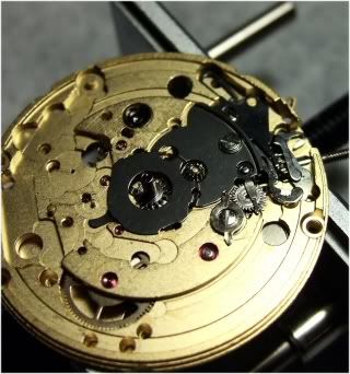

Lubrication is perhaps the biggest subject in L2 and is quite an art / skill in its self. Attention must be paid during these lessons as over lubrication or the use of the wrong lubrication will cause headaches later! The complete lubrication of the 2836 is performed including the barrel where no less than 3 separate oils are used for this one part! The types of oil and their application / intended use are discussed plus the amount to administer, which are tiny! Trying to oil the balance and pallet jewels is a real test for ones skill and determination, just have a look at the following pics! The course notes are clear though and easy to follow. I've used the practices taught here on other movement types like the Russian 2416 etc. with success.

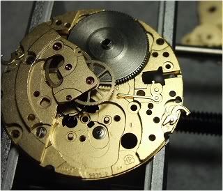

Various parts:
Pallet fork and gears:
Close up:
Barrel prior to oiling. This part of the build was interesting, the spring has a mind of it's own and wants to go anywhere but into the barrel housing. Eventually I got there! No breakages!
Mainplate after cleaning:
Re-build starts:
Here's the pallet fork, and yes we have to get a tiny drop of oil on the ends of those jewels!
Here the fork and bridge are installed:
Here is the very delicate balance wheel and spring. This one seems to be in good order with nicely concentric and spaced rings. This part is the last to be removed and the last to be re-fitted:
Dial side with Keyless works fitted (and working!) but can you spot my deliberate mistake?
Dial side complete; still have not noticed my mistake yet:
Date Wheel installed and mistake corrected….I neglected to install the hour wheel so when testing the quick date change mechanism I noticed it was not moving…Oh well easily done!
Now's the time to oil the balance jewels. I use a piece of Rodico to keep the little blighters in place and stop them performing their magic disappearing trick!
A generous (!) drop of oil needs to be place in the center of the jewel (flat side):
Ready to be replaced:
Finally ticking again, I was not 100% happy with my oiling efforts on the balance wheel so I re-did them little while later:
Only the Auto winding mech to re-fit plus the regulation and it's done!

Nice work. Lubrication and cleanliness is probably one of the largest issues that discriminate professionals from the rest. I notice you are using rodico to stabilize your parts, keep in mind rodico not only cleans but picks up oils and dirt from your hands and will transfer it to your watch. The goal is to work on a watch without touching it during oiling and reassembly. Finger cots work well - get the ones with no powder. Don't' worry about time... you'll get quicker. From a cost perspective look at the timer made by Bryan Mumford (I helped on the early prototypes) It is very good. http://www.bmumford.com/. Good job - Practice practice and more practice!
