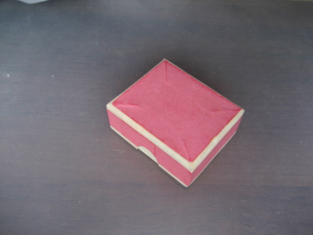

Just returned from the post office with new stopwatch.
According to the document the stopwatch was issued on 6th of April, 1973.
