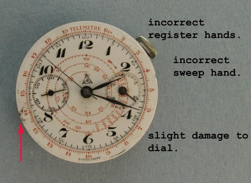

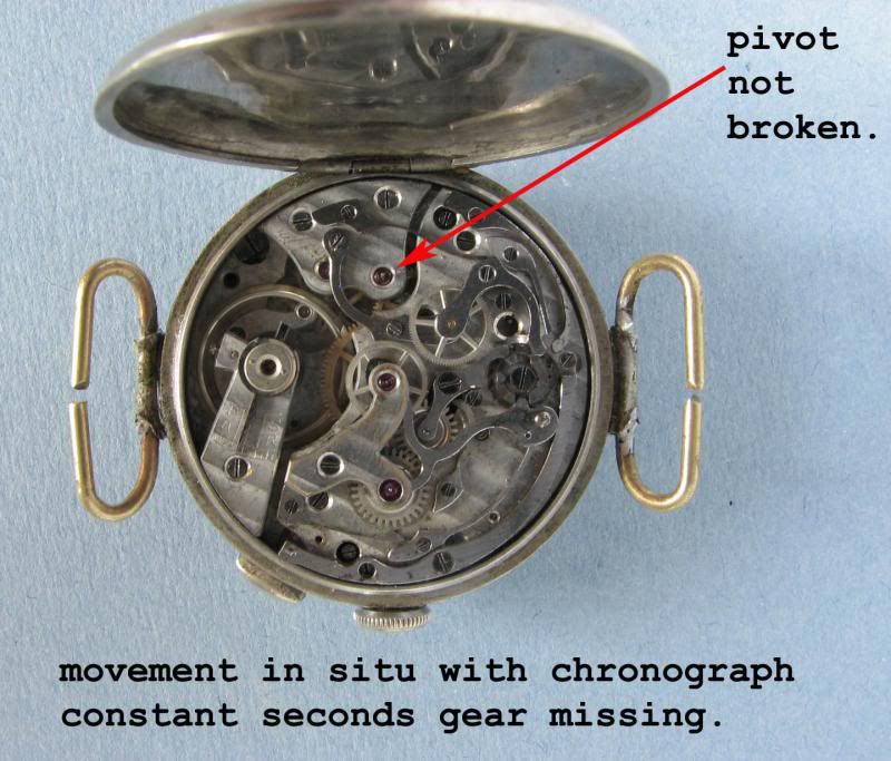

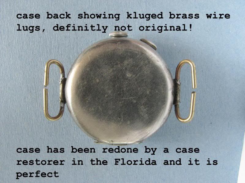

Without further ramblings here is the watch in all its glory when it arrived. The case was a mess with the original silver lugs removed and replaced with brass wire, dial filthy, only the hour and minute hand were original and the dial was filthy and damaged. Inside the chronograph constant second gear was missing. This is the gear that transmits the watches seconds progression to the chronograph mechanism. Without it all you have is a time piece.
On the plus side, the time keeping was working!
The case back was not bad although the hinge was weak:
Opening the back showed a silver plated, geneva striped, 17J Valjoux 23 (first edition) with the chronograph constant second gear missing:

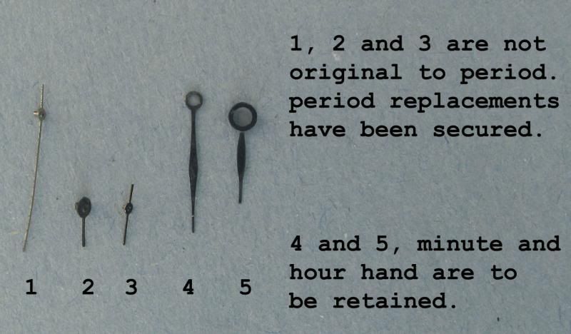

more on the hands:

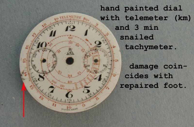

After removing the dial the damage was caused by a shock to the watch which flexed the dial foot and cracked the enamaling to both sides:

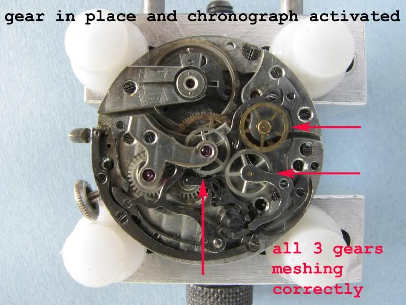

Of course a new gear had to be secured and here it is!
Here is the movement with the gear in place but the chronograph not engaged followed by a shot of the chronograph engaged. The watch ran perfectly without a cleaning at this point as all i was doing was dry fitting the gear and confirming a fit and function:

  • New period sweep second hand (blued) as well as both the constant second and 30 minute sub hand have been secured.
  • The movement is being serviced and the constant seconds chronograph wheel will be correctly affixed to the pivot.
  • The dial has been cleaned and the damage repaired (simu porcelain). Fortunately the numeral and indices were not damaged and the original chip was retained.
  • The case has been restored to factory with new sliver lugs, dents removed, hinge replaced and new crystal.

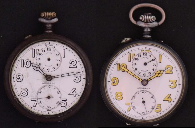

here is an Angelus alarm pocket watch before and after:

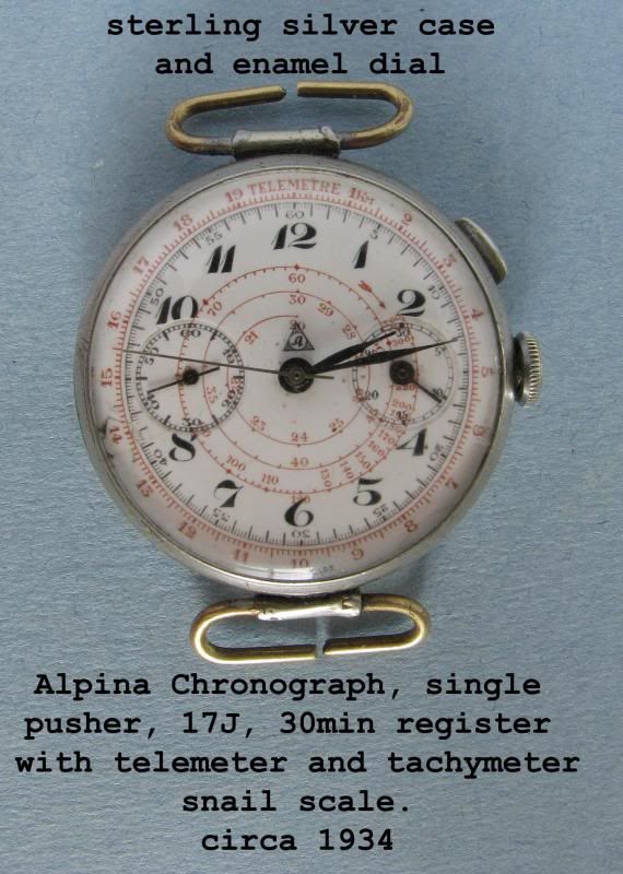

Oops, I see I forgot to post the finished product:
Sterling silver case restored with new lugs; sweep second,constant second and minute counter hands replaced with period correct. Movement stripped and restored.
Dial chip at 8:00 glued back in place, of course this where the dial foot is attached on the reverse indicating the watch had been dropped at some point.
Cheers, Geoff
