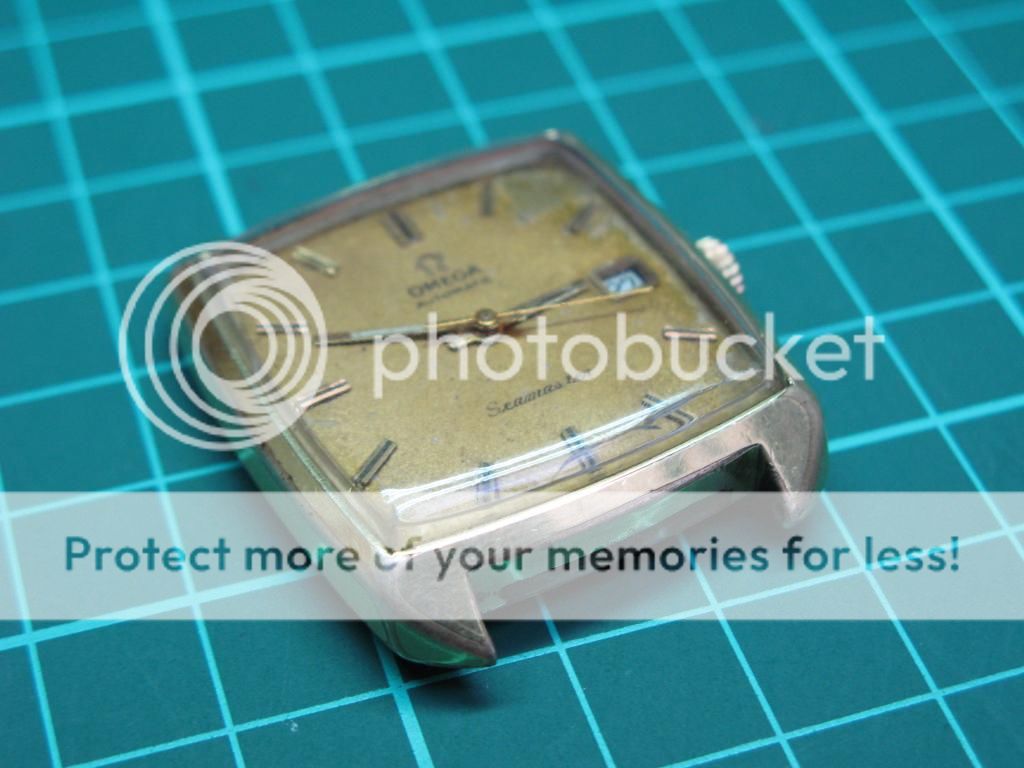

I just picked up this Omega Seamaster ref. 166.042 on ebay:
(seller e-bay photo)

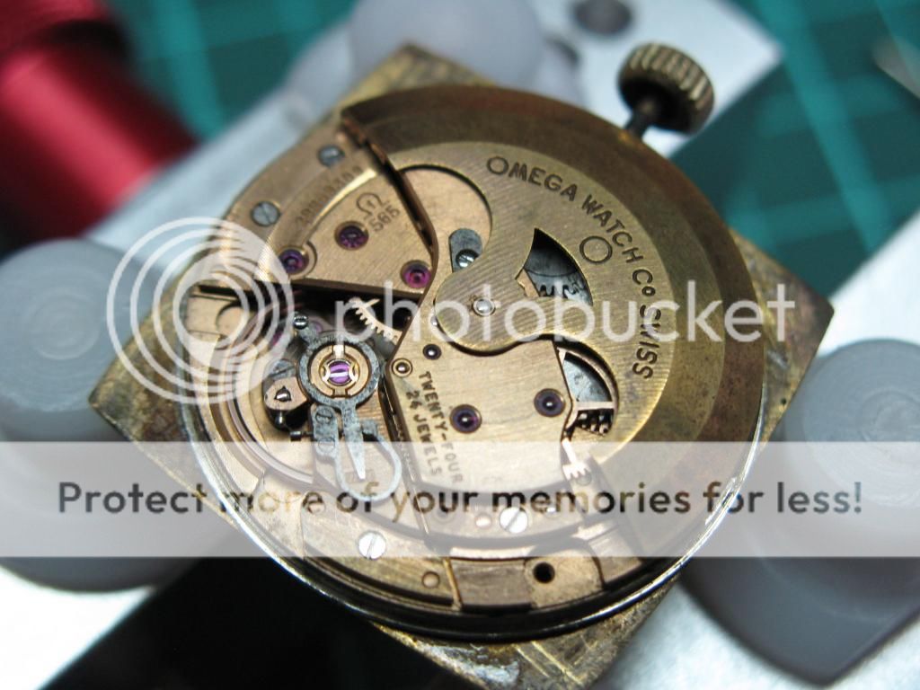

It has an Omega 565 automatic movement:

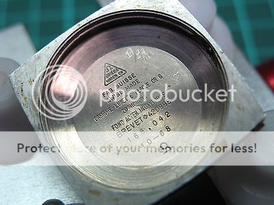

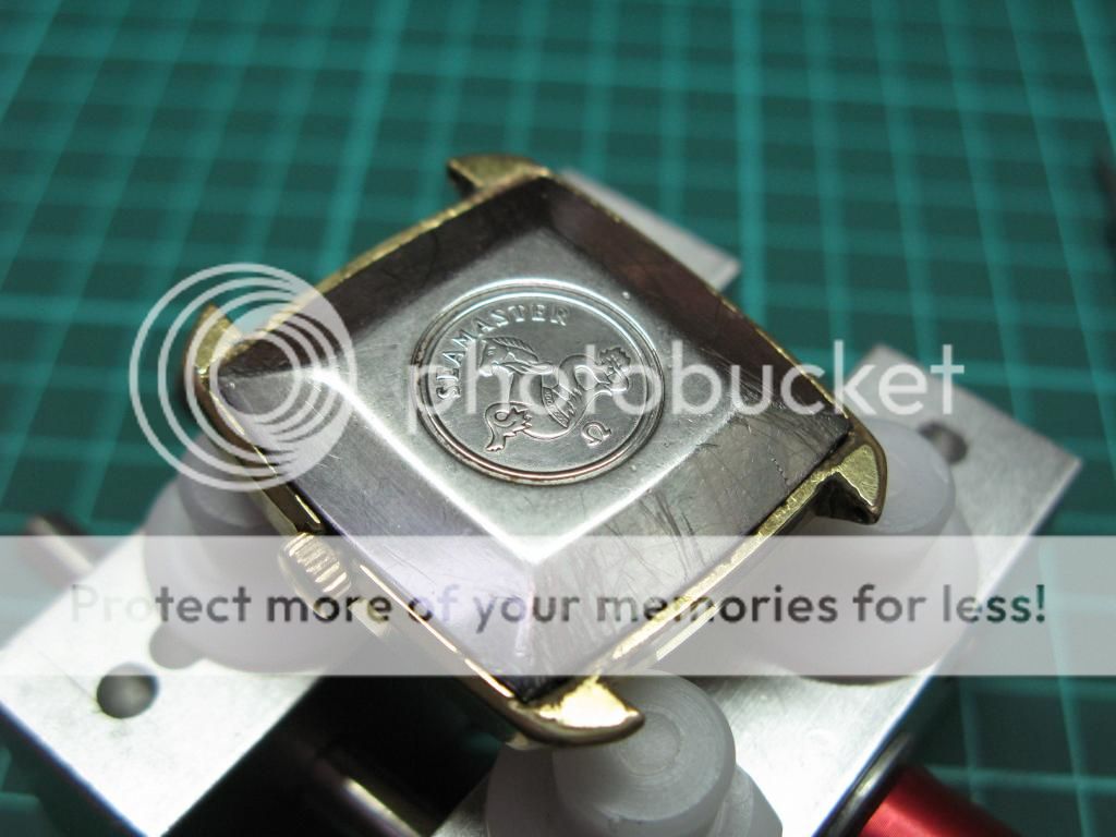

And a somewhat funky compressor case:

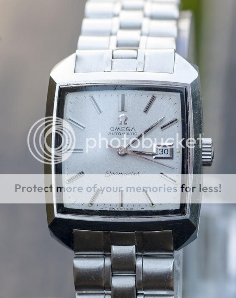

I want to get this watch restored by having the case replated to a silver tone and the dial restored to match (as in the photo below):

don't want to discourage you, but I believe, this is more a task for a hobbyist who enjoys the lots of work to be done. The easiest and cheapest way is to look for a sample with steel case, and kick yours back into the bay. Already preparing and plating the case, and a well done redial would cost you more than a mint steel watch, and then you still have the movement ruin inside.

Agree with Roland. The case looks as though it was originally gold plated, so the correct thing to do would be to replate it gold. The silver model you show would be a model variation, the watch would likely have been available both ways. There are companies who can do this for you, in my experience you'd be looking at the region of USD $50 to do that. The dial is incorrect and is an example of a refinish. To get it refinished correctly would cost you around USD $50-100. The movement is in sad shape. An overhaul would probably set you back USD $100-150. Omega signed crown USD $20. Bracelet? Strap? Looks like the crystal has a crack in it; an Omega one would be some USD $30.
