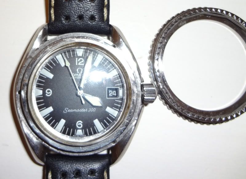

When you are done, you will have a properly aligned bezel. Yes I've done it. Here is the WatchCo SM300 I had that had the problem. The photo is after the work was done.

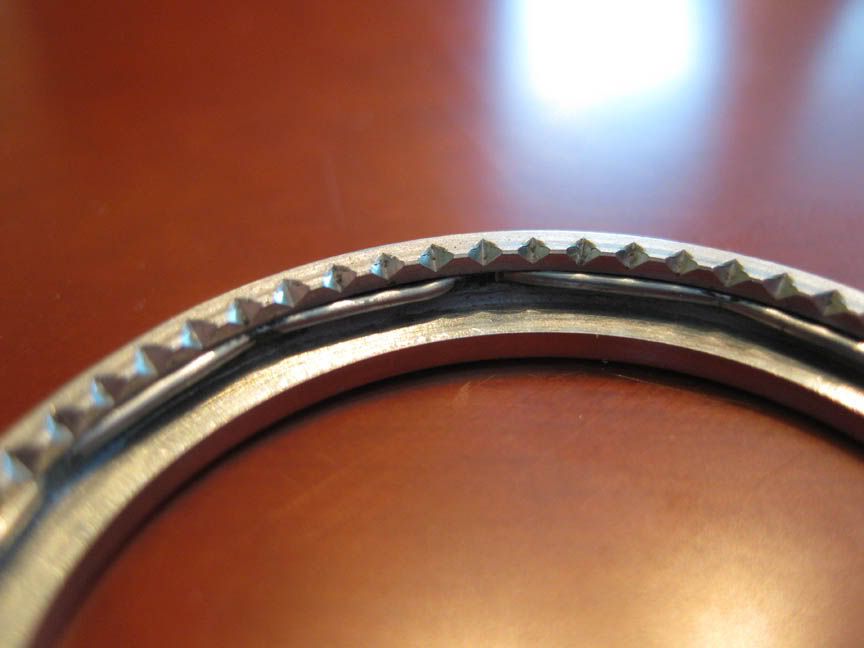

These bezels are like their modern decendants in that they have a “lock” hexagonal steel wire that holds them to the case. These all have an opening in them. Unfortunately, you don’t know where this opening is. To properly remove the bezel, you need to start where that opening is. If you don’t, you bend your bezel and in return break the insert.

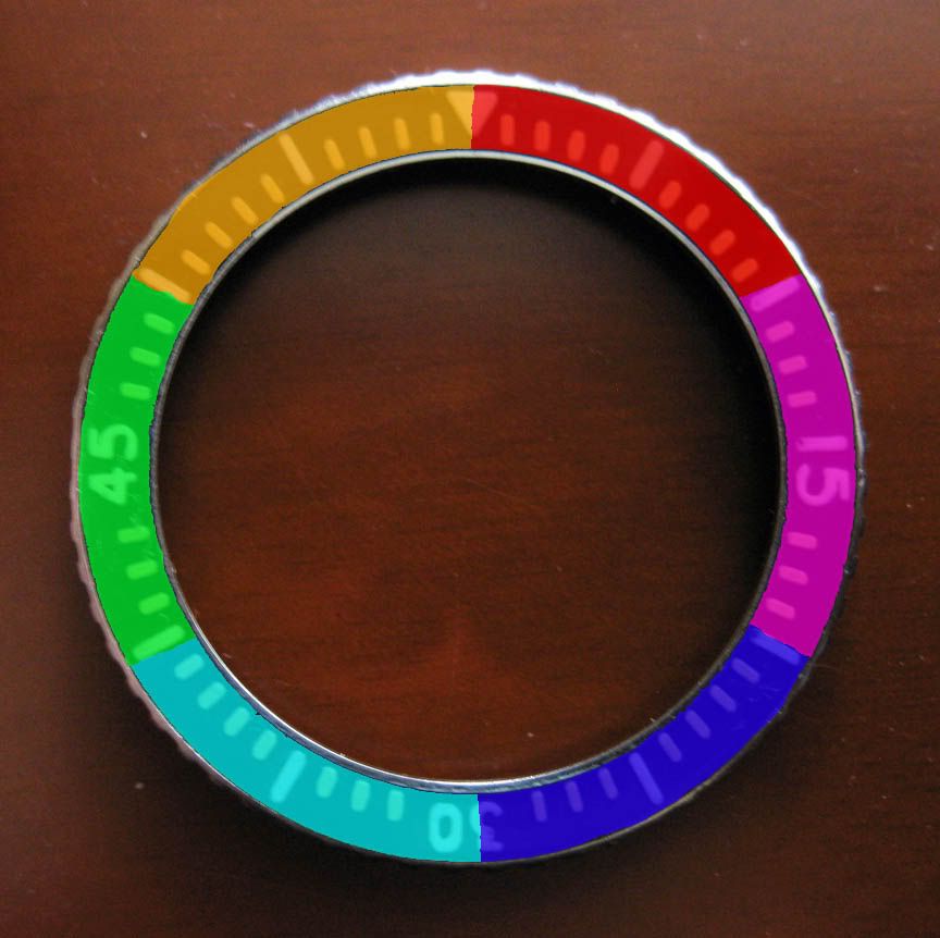

Break the bezel into quadrants of 10 minutes.
This will make it easier to identify where the opening is. Very gently, you need to slowly move around the circumference of your watch slipping the knife between the bezel and the case at the quadrants as identified. On the opposite side of the wire opening, the bezel will hardly move and it will be difficult to slide the knife in. On the side where the opening is, it will move easier. Once you have which half of the bezel the wire opening is, now you need to focus on that half of the bezel since you know the opening is on that side. With a bit more force now, try to remove the bezel. Slide the knife in and twist a little. Do this until you find the most “give.” Once you have identified the sweet spot range which should be between 2 quadrants, you can work back and forth till the bezel pops off. Don't forget those rubies.

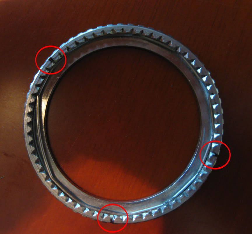

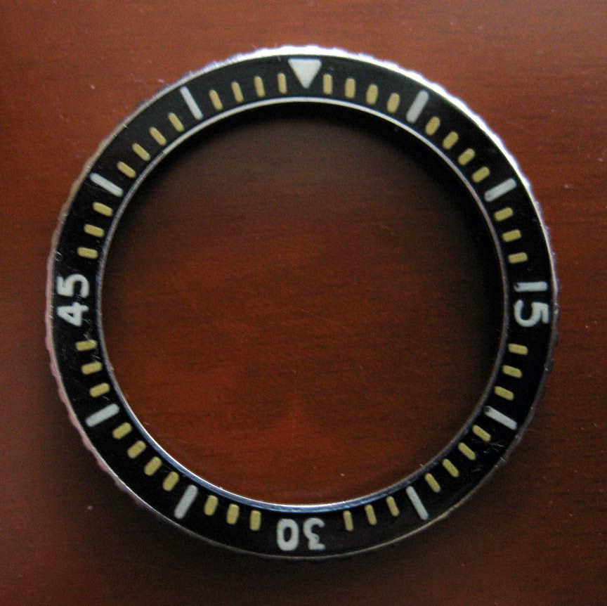

So you have the bezel off. Great job. So what is going through your head is, how in the world do I fix the issue? Now we take a file to the underside of the bezel on your brand new watch and modify three of the teeth.
You will need 2 tools for this step. A needlenose file (preferably a square one) and a fine point marker (such as a sharpie).
Locate the position on the backside of the bezel that the rubies sit in when at the 12 position. As you can see, on this older SM300 case the rubies are at the 6, 24, and 45 mark.
Confirm that your's are the same and if not, locate the correct position. Find the teeth that correspond to these ruby locations on the interior of your bezel and mark the valley with the sharpie.
Now, reference the information you have on which side of the 12 marker your bezel is off on. If it is off on the 11 side, you want to remove material from the teeth on the same side. What this translates into is the OPPOSITE side when looking down at the bezel back. Remember, the bezel is turned over. So, the 11 is actually on the right side and the 1 is on the left side. So, if your bezel sits at the 11:59:50 alignment position you would need to work on the teeth on the RIGHT side of the groove.
I strongly suggest you reread what I just said.
Use your needlenose file and elongate the teeth. If done correctly you will end up with a bit of play in yoru bezel at the 12 position but you will now be able to align it properly. At all other points it will be off but the important one of 12 will be correctable. This step is trial and error. That is why we removed the bezel retaining wire. By removing it, you can easily position the bezel on the watch and make sure your alignment is correct.
- 0-10
- 11-20
- 21-30
- 31-40
- 41-50
- 51-60
