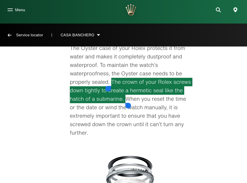

It's not a fact. The screw down function has nothing to do with the crown seal when the watch is at rest. The screw down function is there to prevent the crown from being damaged or engaged during physical activities where that really matters, like diving 60 years ago. That's really all there is to it. It makes no difference when the watch is just sitting there. You're complicating things with a common misunderstanding that the screw down function must surely seal like a bottle cap when it does not.
Nope,
It has to do with sealing the watch, or at least I'd rather trust Rolex and not you :
The comment wasn't disputing that there IS a seal there, we know that. It's extremely uncommon and Rolex does it as a point of differentiation. It is still likely that Rolex insists the crown be screwed in on customer facing marketing material for much more relevant reasons like preventing damage to the crown and stem. I doubt they're expecting most customers to require 300m of water resistance each time they reset the date.
